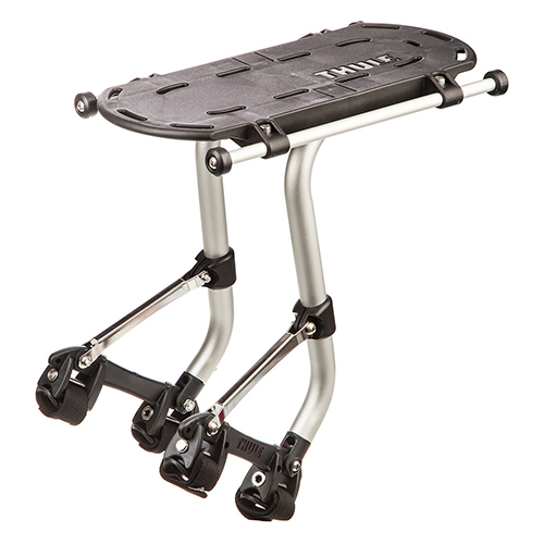

The only one I can think of is the Thule, but it has nowhere near he capacity you are looking for.
The only Thule rack I know is the one below, is that the one you mean? Because it doesn't work with dual-sus... you might be able to attach it but it will tilt as the suspension compresses.
Thanks! But this solution won't work with dual-sus.
A while back somebody posted pictures of his installation of the Thule rack on a full-suspension Haibike. I tried to install the Thule on my full-suspension bike, but it would not work because my Haibike has plus-sized tires and the Thule rack is not wide enough. I then found the OMM Phat Sherpa, and it worked!
I also think the Phat Sherpa method of attaching to the thru-axle is much more solid and secure.
I've used the Thule for about a year on my XDURO Full Seven S RX. I have the pack and pedal side panels for bags too, but haven't used them yet. Clamped the rack on the first time, used a set of the shorter bars to level it, and haven't had to touch it since. I have 27.5 x 2.4 Schwalbe super moto tires. I use a nice sized pack when riding rail trails, riding single trails the day I took this pic. I wouldn't worry a lot for carrying more weight than recommended, unless you jump off some curbs or ride single trails with a ton of weight on it. I've lifted the back of the bike when loading into the van by grabbing the rack a couple of times. Nothing moved. Load capacity is 25 pounds.
