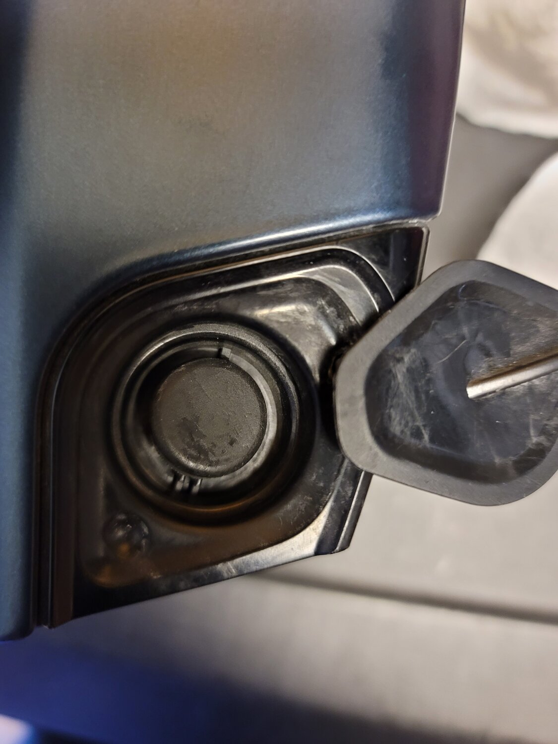

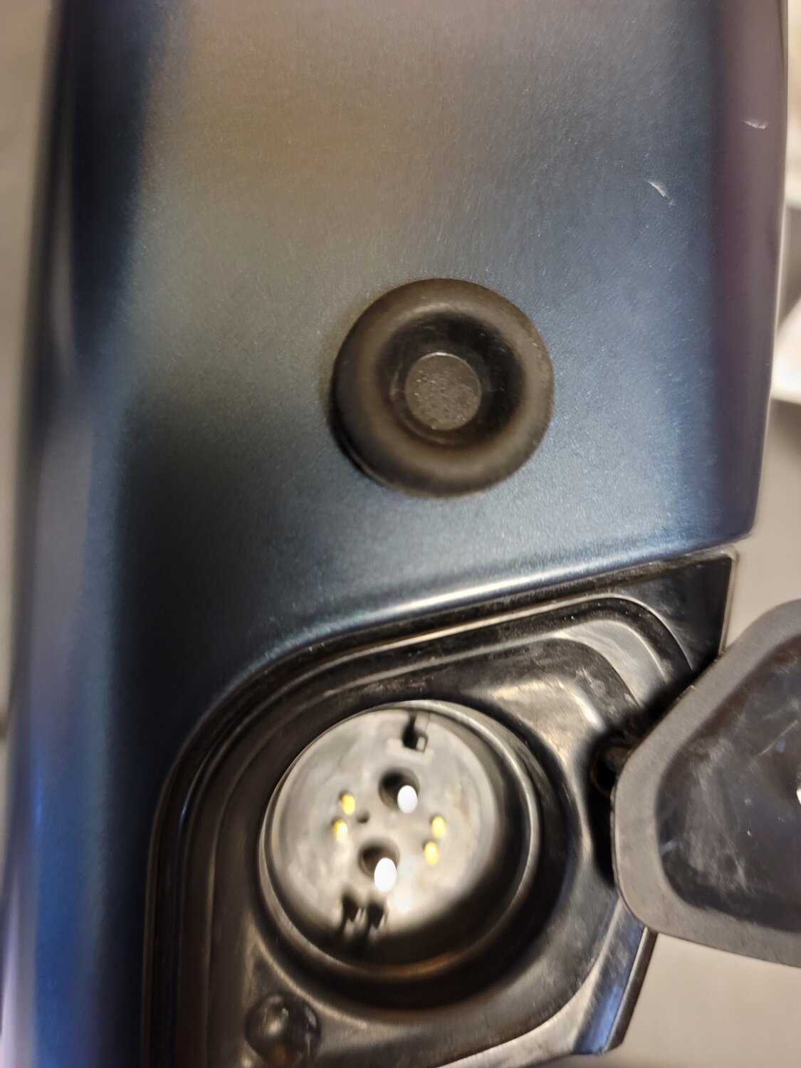

My biggest criticism of the bike is the danger and ease of accidentally destroying the battery. This is the biggest design flaw of the 2020 model. Whoever thought this design was a good idea needs to go back to school. Hopefully, this has been fixed on the 2022 model. It's very very very very (add multiple additional "very's" here) easy to accidentally touch the terminals with the key that unlocks the battery from the frame, which immediately destroys the battery to the tune of $1K for a replacement. I recommend adding a rubber grommet as an insulator of the terminals (see the photos).
