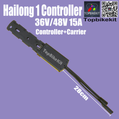

Not really, just more range would be great. I know the motor is on the smallish side, but I thought for this rehab I would stick with it. I do like the controller that fits under the battery cradle. With the Hailong controller, do I then have to get a Hailong battery? And then all I need is a Display/PAS
Yes, if you get a controller and battery, you will need a display and PAS sensor that connects to the controller.
Hello Timpo, if I get this under battery controller, all I need additionally would be battery, PAS display, and throttle? Would I have to install cadence/torque sensors? Is the PAS built into the display? Just trying to complete my checklist. Thank you.
I think your checklist should look something like this
- hidden controller (under-battery controller)
- display
- motor inhibitor for brakes
- Y - cable for display to brakes, controller, etc.
- PAS sensor (cadence sensor) I don't think torque sensor is available for this application, but I'm not 100% sure.
- battery (Hailong or Reention Polly) make sure to get the right hidden-controller & battery so that it will fit on the cradle
If you want the throttle, you can, but make sure you get the right Y - cable for it.
Thank you, Timpo. That's very helpful. One more thing that I am unsure of. This is under frame controller I would like to use.
How can I be sure I get the right battery for the case to fit in the cradle and match up with the 4 pins?
