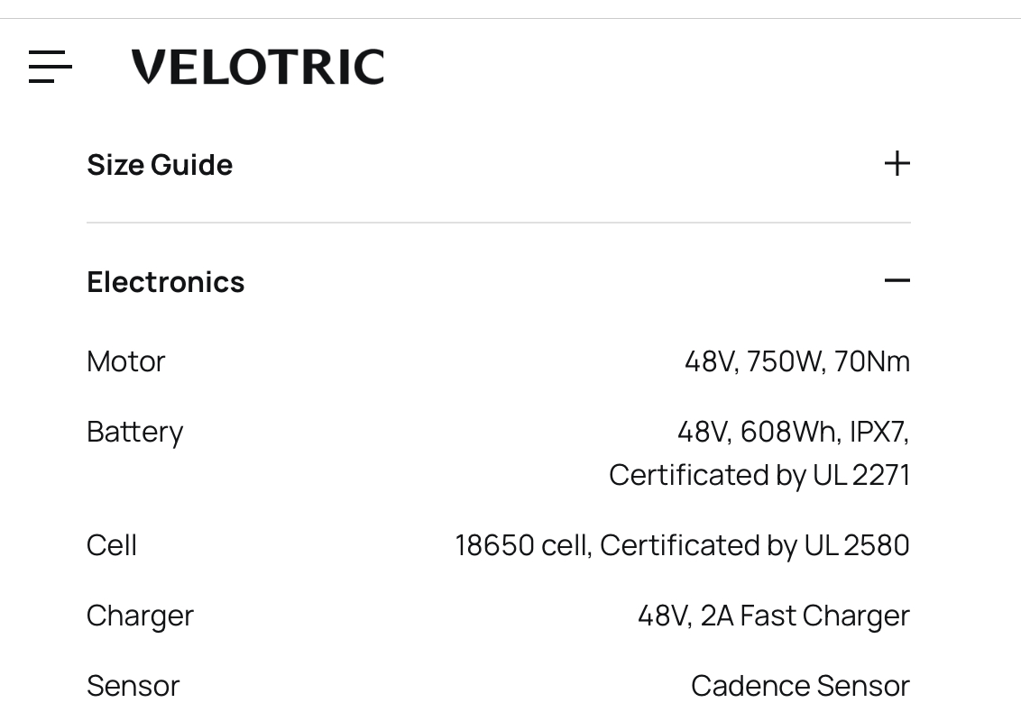

Ok, after i posted the specs i saw the 20 nm difference, which would account for the torque, and needing to be in a higher pas level. I can accept that. But the poor performance of the throttle button is not acceptable. I have emailed customer service, i hope we start a discussion. One of my questions will be if i can swap the controller.
The Fold 1 only has a cadence sensor. No torque sensor like the Fold 2. I'm pretty sure that there is nothing wrong with your bike, and that other controllers cannot be swapped in. Let us know what you find out.

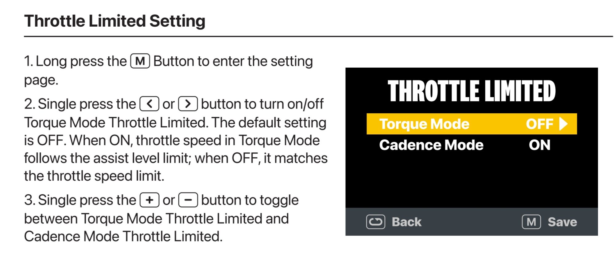

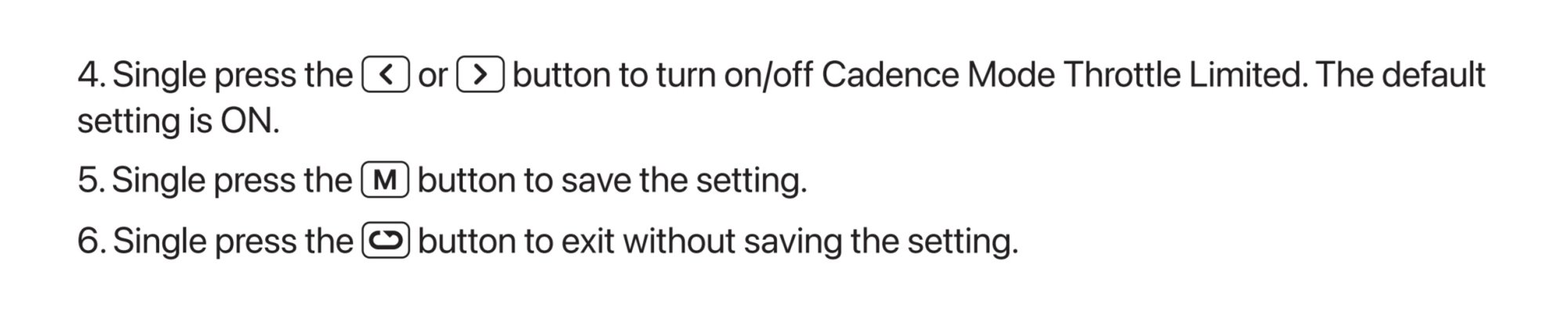

Per the Quick Start Guide, the display menu offers only one throttle-related setting:
When OFF, I think it decouples throttle response from assist mode when the PAS is set for torque-sensing. As I recall, OFF was an improvement but not enough to make me like the throttle implementation overall.
As a rule of thumb, torque goes to acceleration, and power goes to top speed under a given set of riding conditions. So the torque difference, if real, may not fully explain the perceived assist differences between your old and new bikes.
Both bikes have the same nominal power rating of 750W. But that's electrical power input. If real, and the motors are equally efficient, then the motors also have similar mechanical power outputs.
Which takes us back to PAS programming. And we already know that ebikes can differ dramatically on that front.
