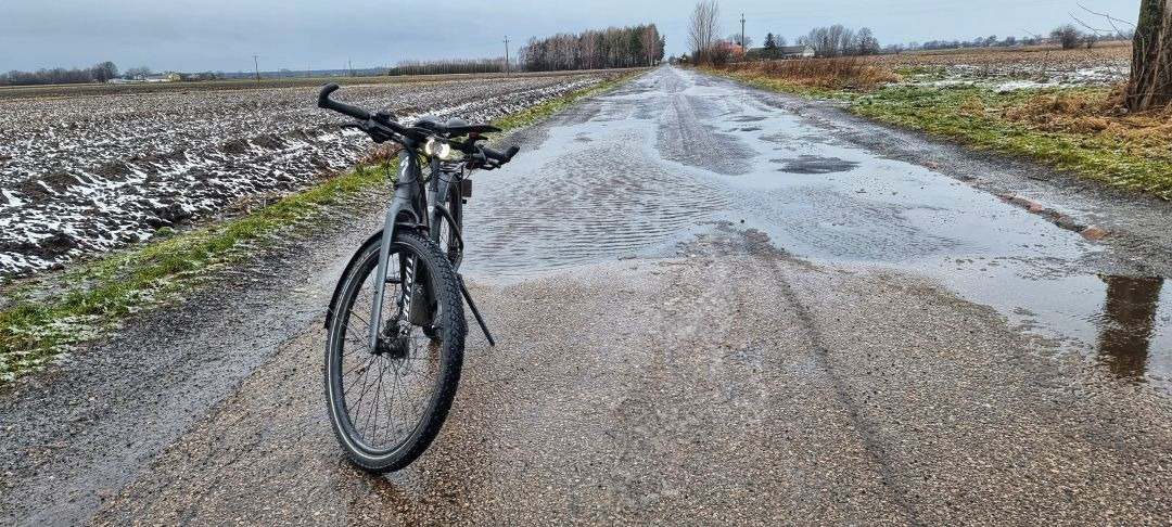

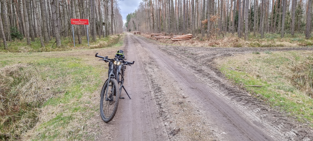

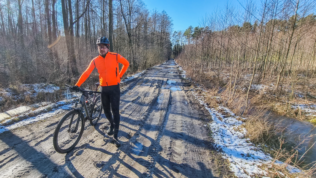

Dirt and gravel roads? Just ridden yesterday on an older model of Vado:
A couple of days before...
Terrain ridden on Feb 12th this year:
Jan 30th, 2021:
Note: My Vado is equipped with narrower tires than the 2022 models, and has no suspension.

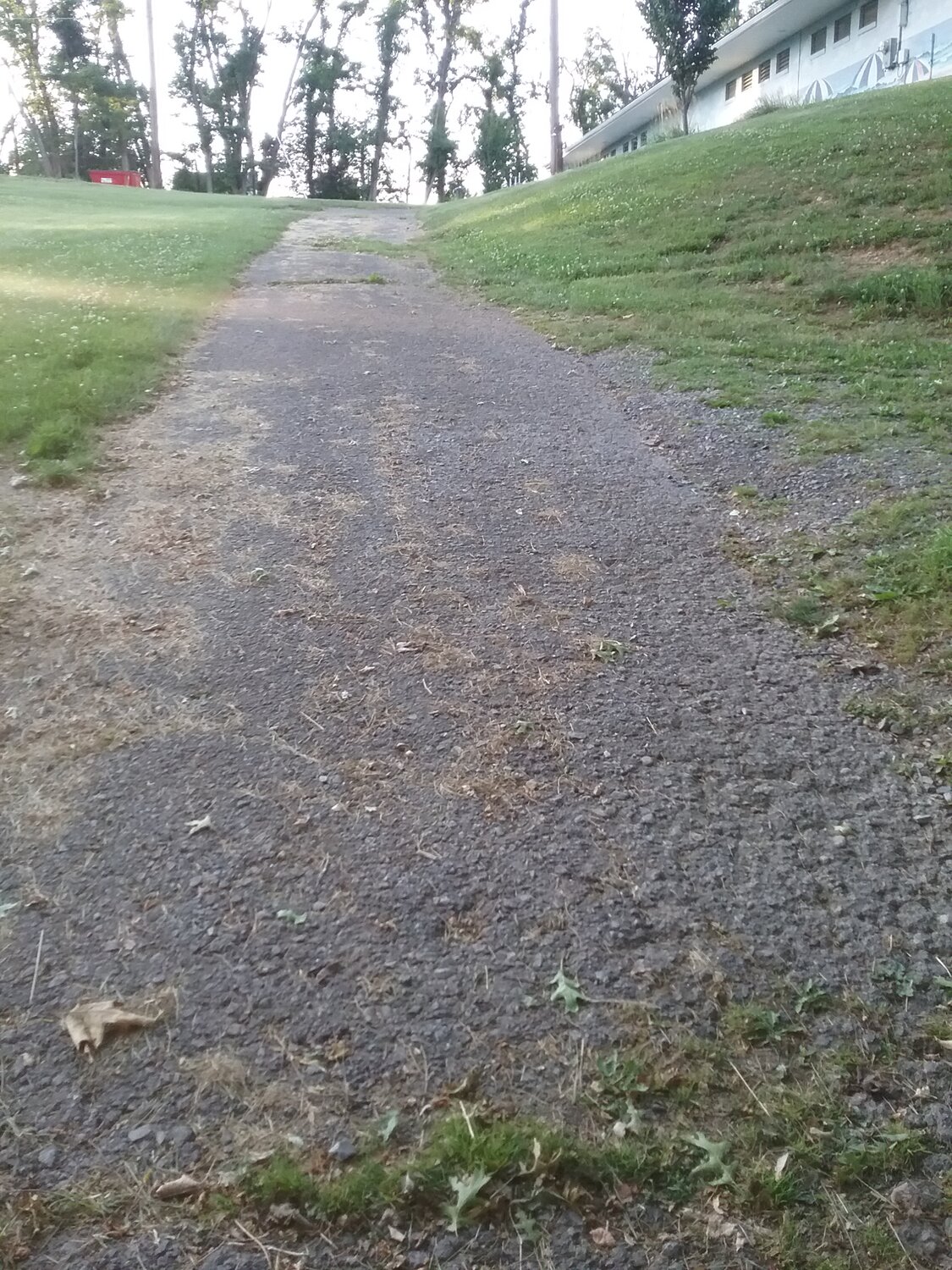

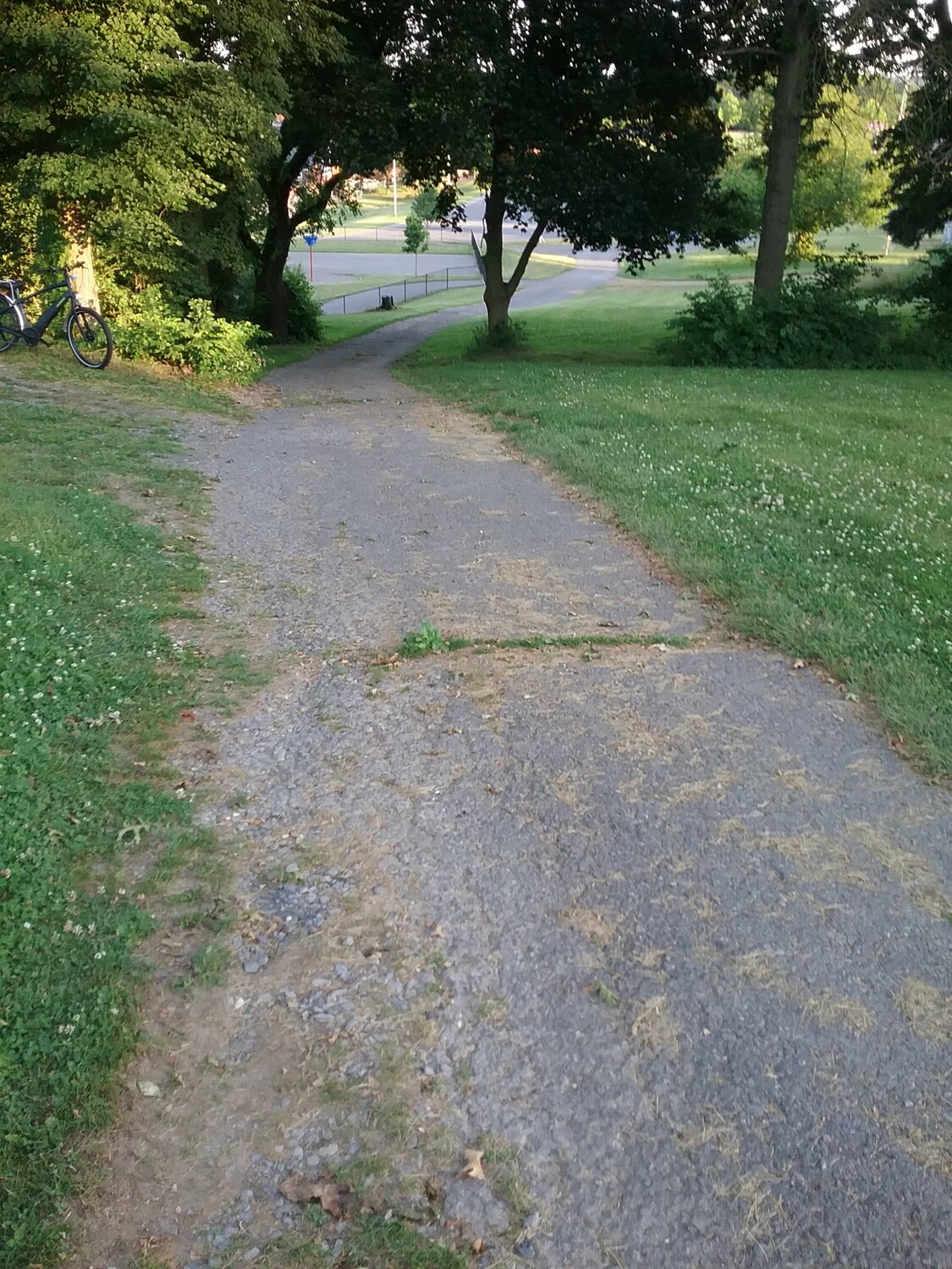

I have some short runs of 1/8 mile or so that probably are a 20 deg grade and might even hit 25 or 30 for very short stretches. The latter hill I'm thinking of is so steep that I really cannot bike to the top without walking it some. Of course, I'm also not in "great" shape either.
20 degrees is nasty. This is about the steepest hill I climb on a regular basis. Unfortunately it's on the end of every ride home unless I ride on the side of a 45mph highway with no shoulder.
Not even young and fit cyclists ride up it, they carry their bikes up.
Photos from about halfway up when I have had to stop more than once. BTW, I ride the wimpy version 3 Como, and am pretty poor condition ... overweight, smoker, and close to 70 years old.
