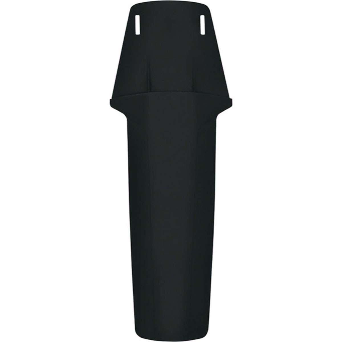

There are a few options in general, brands like SKS or Fahrer-Berlin make thos attachements to ad to you fender, rather easy to instal. But I do think it would a quest to find those in the US. You could look at some of these designs and make an extender for your fender from a piece of sturdy black plastic.

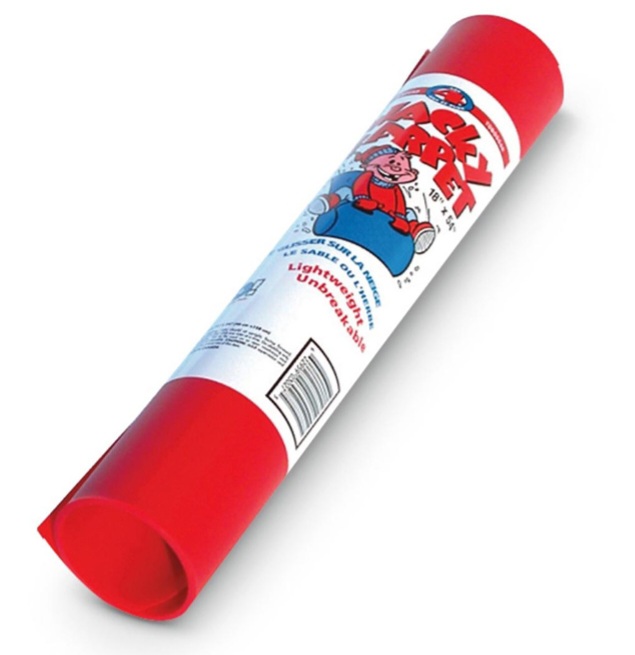

I was wondering what to use to make my own fenders.
All that came to mind is a crazy🤪 carpet.
They call them "Turbo Carpet" now at Canadian Tire,..
It's really durable plastic, and if it's got a bit of a curve to it, it will hold its shape better without being all floppy.

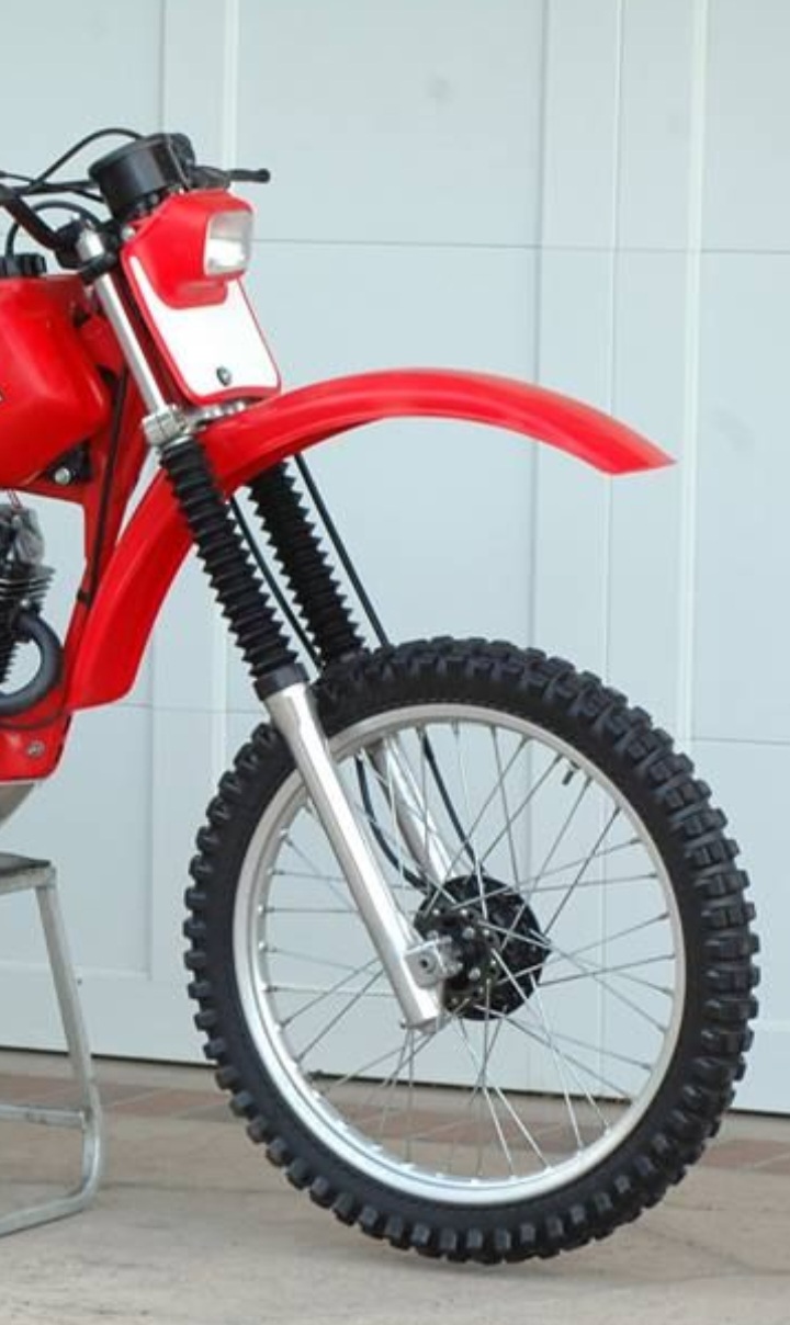

My dirt bike had a plastic fender and it worked Great !!
I wiped out all the time and constantly got my fender caught on stuff. (Including myself, depending on how I crashed. 😂)
The fender would just spring back into position without breaking or getting bent.
I could grab the fender and twist it upside-down and it would pop right back. It might end up a little crooked, but I'd just twist it backwards to fix the alignment. 😂
It was mounted to the forks with rubber grommets/bushings and big fender washers so the bolt holes wouldn't rip out.

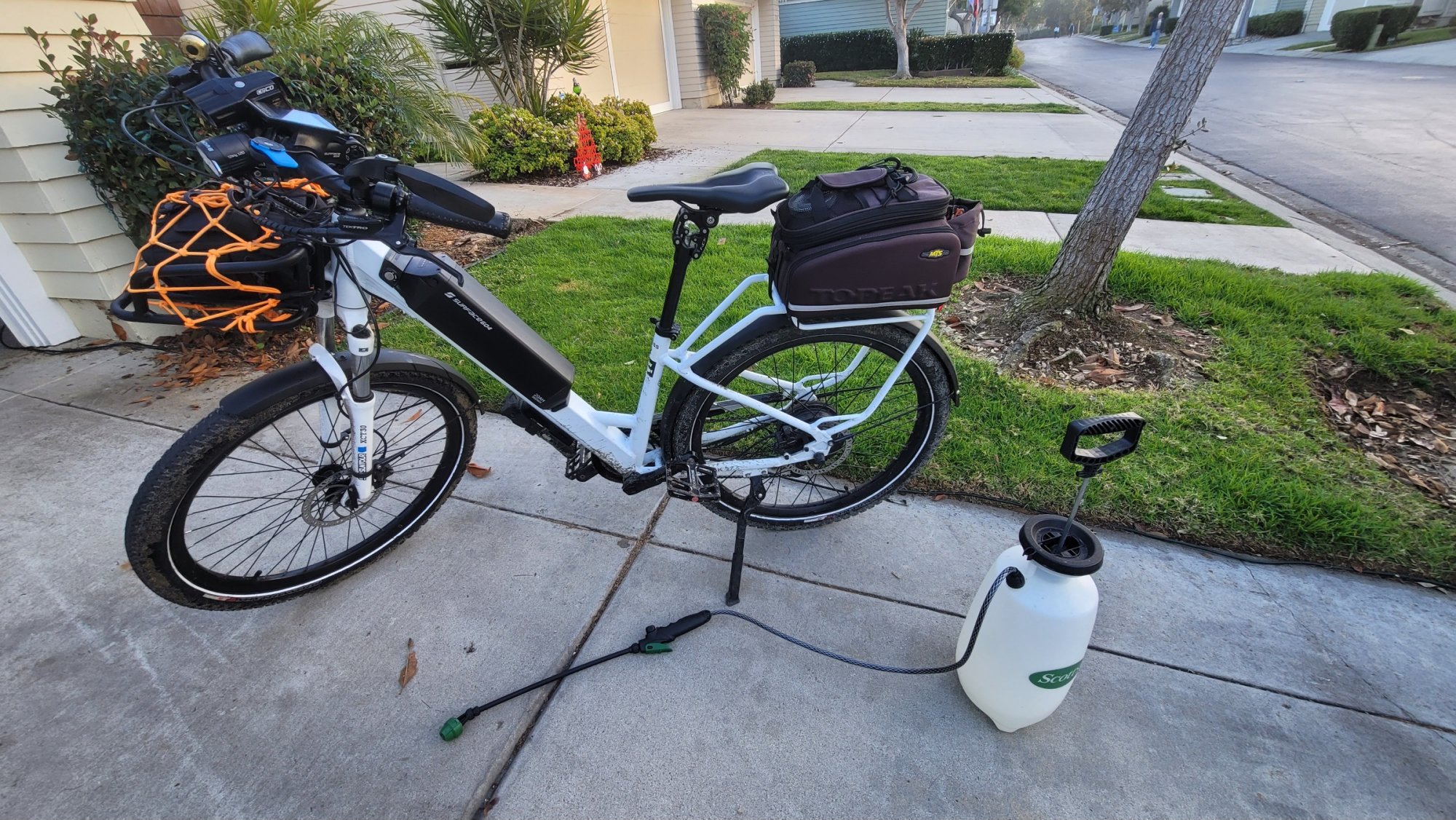

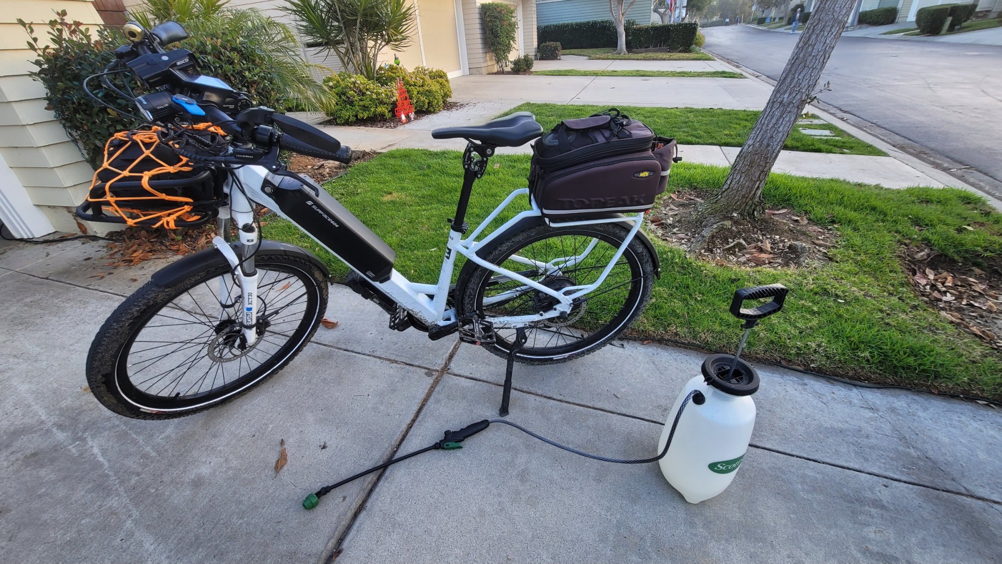

So while you're working the fender angle, I'd like to pass on a tip from member @m@Robertson, who's been dealing with beach sand for years: After every significant sand or salt exposure, do a quick rinse with a dedicated 1-2 gallon garden sprayer, plain water only. Especially the drivetrain — including both sides of the chain. Then drip-dry.
Just stay away from the electricals. You can get quite surgical with a fan spray pattern. Also a good opportunity to inspect for rust and spots needing extra attention.
Our experience with sand actually on the bikes may differ: I commonly ride on roads and trails with at least a veneer of sand and ride low-tide beach sand at least once a month. But short of riding through standing water, I generally don't see a lot of sand on the chain or parts in contact with it. And my fenders offer no more coverage than yours.
This is true of both my ebikes: The Level.2-like hub-drive commuter above, with its 2.3" hybrid tires, and the mid-drive below, with its 1.5" (38 mm) gravel tires.

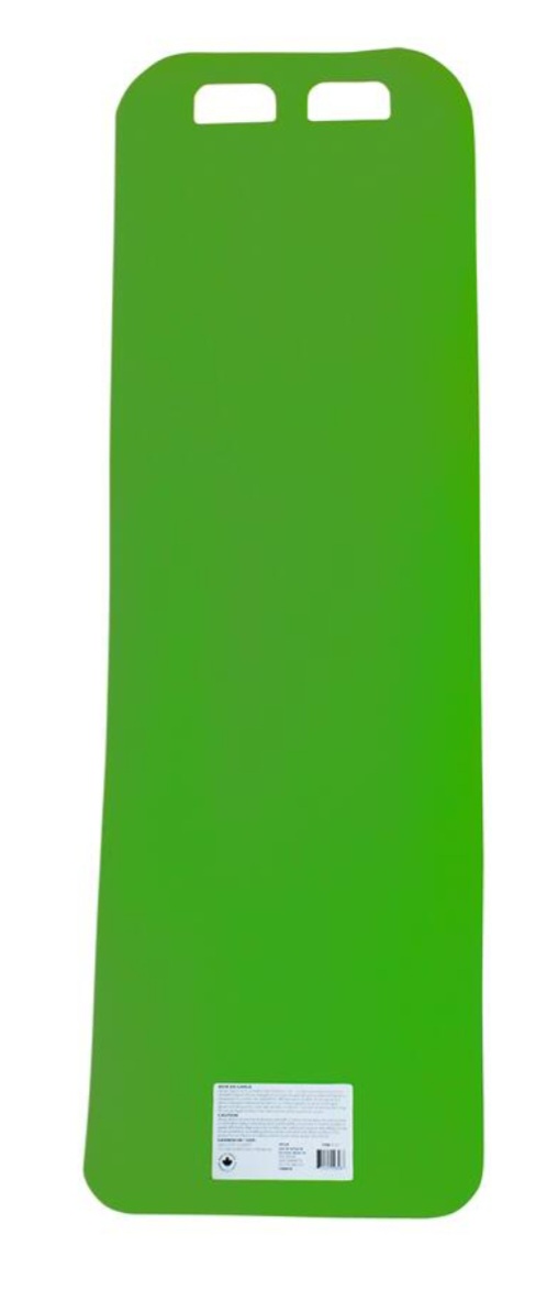

I used Defender Series fenders on my old Specialized Pitch 650B and my wife's Cannondale F9. To keep mud and sand off the crank we mounted Planet Bike mud guards which are designed to be mounted at the top of the down tube. We mounted them in front of the crank instead. The combo worked excellent. We now both have Specialized Turbos with the extended front fenders, but they occasionally get in the way when riding trails while our old setup never did.
Edit: My apologies, the actual name was a Grunge Board. Not sure if they still sell it.
