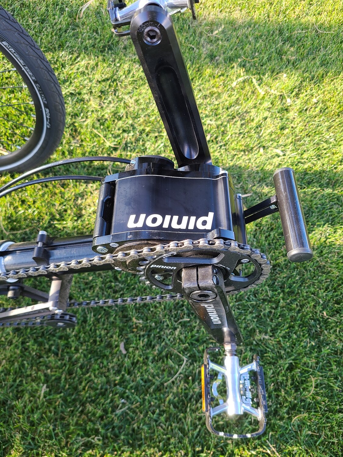

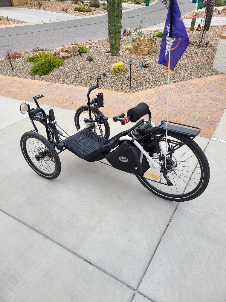

I have a recumbent Catrike Expedition. It has an 18 speed Pinion Gearbox. My knees are telling me I need some help. I want to keep my Pinion so that leaves me with a hub drive. Falco is the only one that offers one with a torque sensor in it. It appears people either love or hate it. I am looking for some recent experiences with the Falco hub drive. I usually ride 25 to 30 miles a day in a fairly flat area. I have a 2 mile 2% to 3% grade as part of the ride. There is also a couple 1/8 mile 4% to 6% grades. All my riding is done on pavement. So will a Falco meet my needs?

Thanks, I checked with GRIN and none of there PAS sensors will work with a Pinion. I guess if I can’t get a hub drive to work I’ll have to sell it and move on to another trike.

I’m not clear on the pinion issue and your photo is low quality for zooming in.

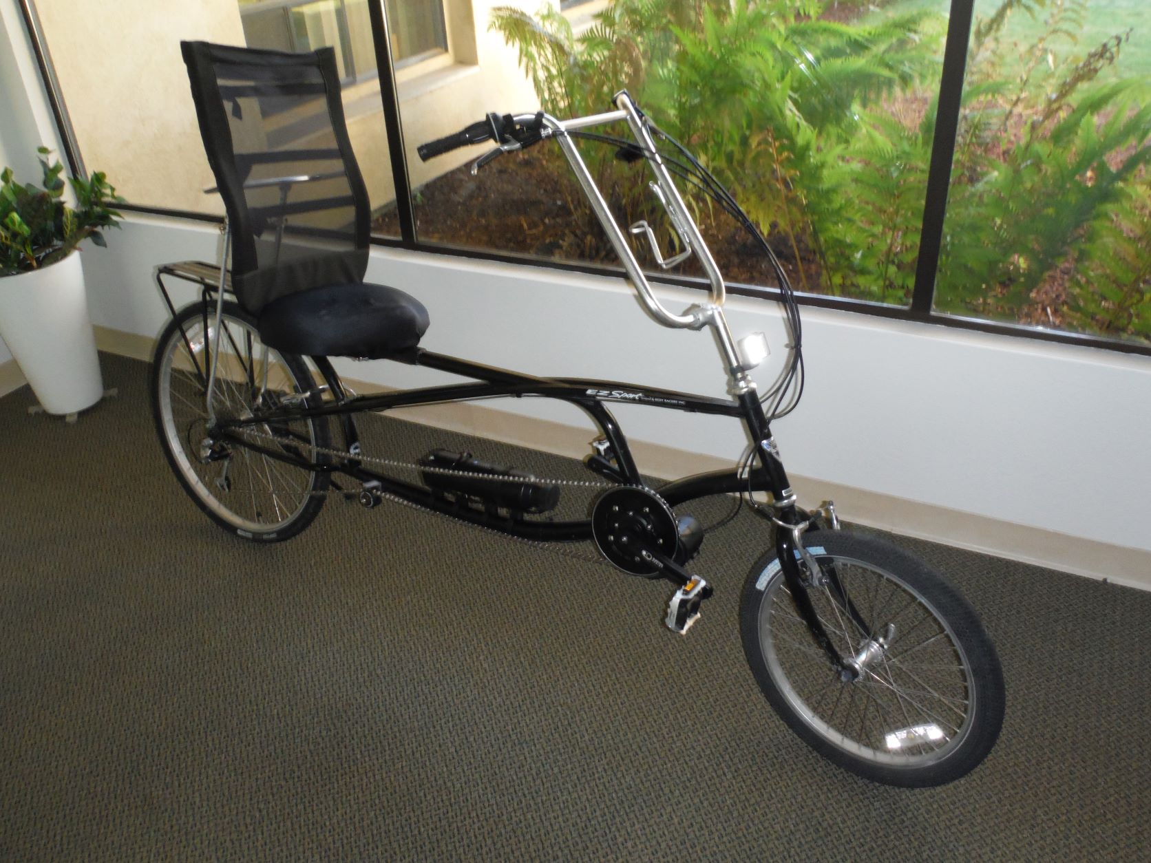

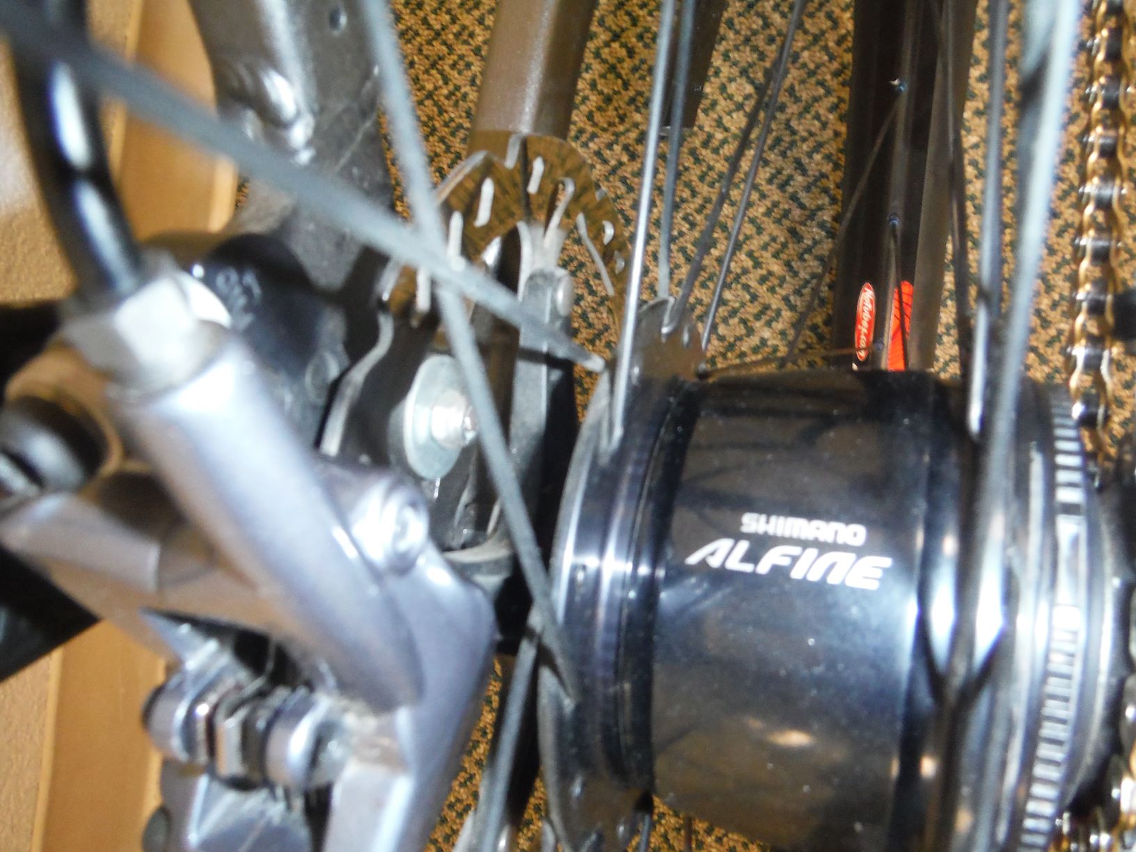

Ideally the setup would be reversed. You would have an IGH in the rear and a motor at the pedals. This way it would reduce weight and the motor's power would be multiplied by the gears.

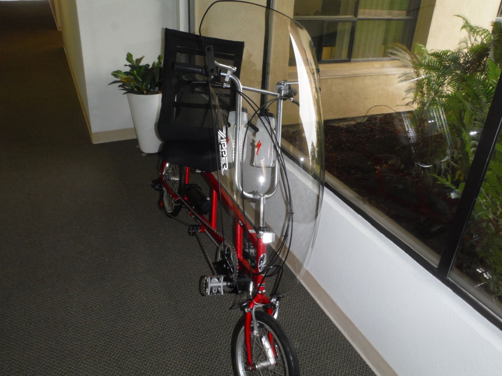

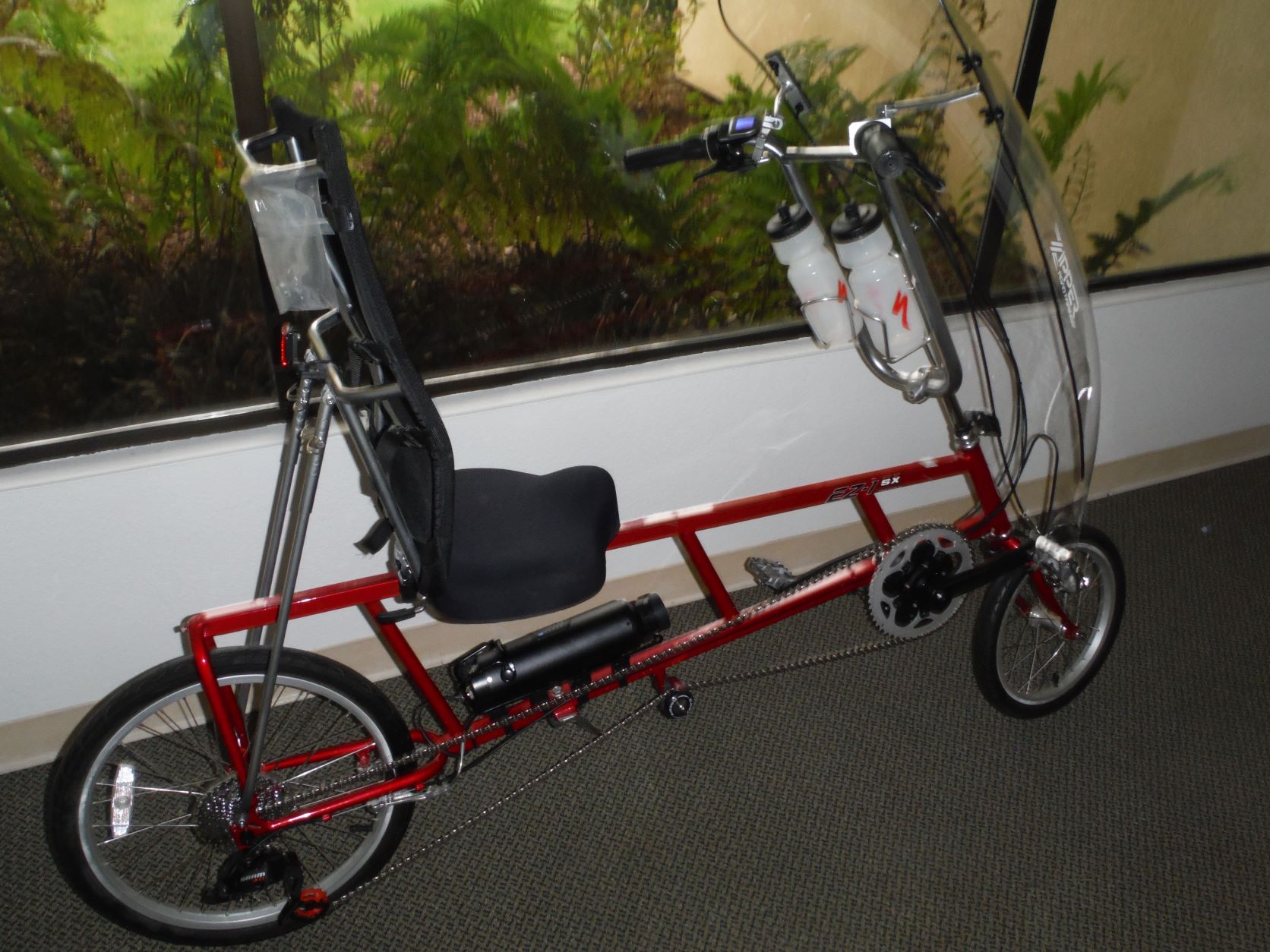

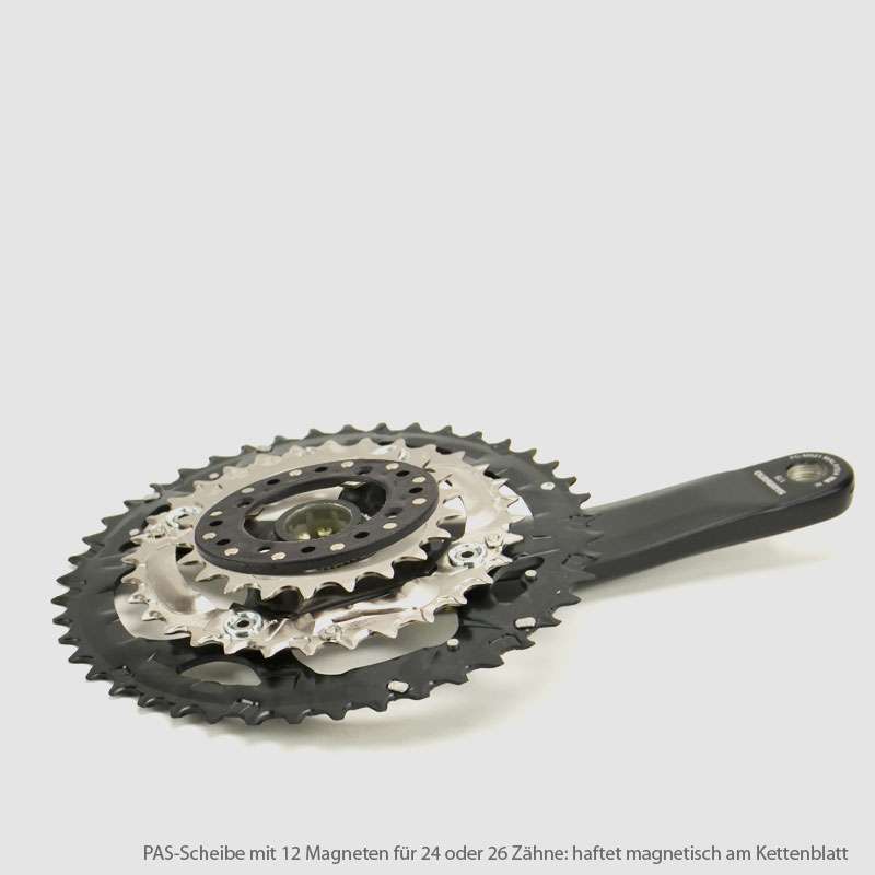

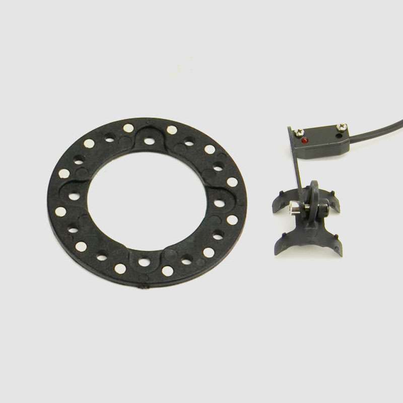

Small neodymium magnets epoxied to the inside of chainring. Bob's your uncle! OR, perhaps a 3d printed disc OR an existing disc with center enlarged? There is a way...maybe...
