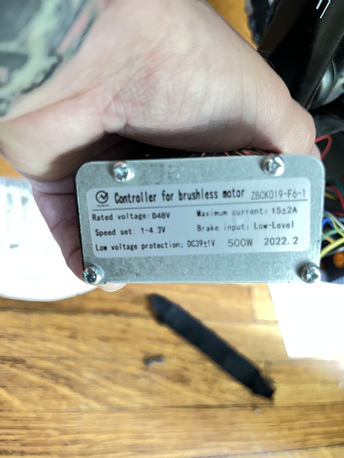

Here Is a photo

Your controller is rated at 15 (+-2 amps). I am assuming you have a 48V battery. 48 Volts X 15amps = 720 Watts (+- 96 watts) delivered to the motor. The rating of the controller "should" be the amount of amps the controller can handle on a continuous basis, without overheating, assuming constant ambient temperature, and consistent cooling. It is not the same as how many continuous watts/amps that will be delivered to your motor for the duration of your ride.
Like all of my controllers, your controller probably will deliver a burst of amps for a short period of time that is higher than the "continuous" rating. This is the "peak rating" of your controller which is not published. If you factor in the "+-2 amps" potential in the controller rating, that leaves you with at least possibly a burst of 17 amps which is 816 watts. Also, your battery starts out at 51 to 53 volts, not 48. At that state of charge you could get 795 to 901 watts. As your battery voltage diminishes on your ride, you will not even get to 700 watts at some point on your ride. I have a Luna Z1 with a 30 amp controller that delivers at least 1590 Watts when I start out my ride. By the end of my ride, when I'm down to 42 volts on my battery, the battery BMS, or the motor controller limits me to 500 watts maximum, so that I can "limp" home. That's the way it usually works.
