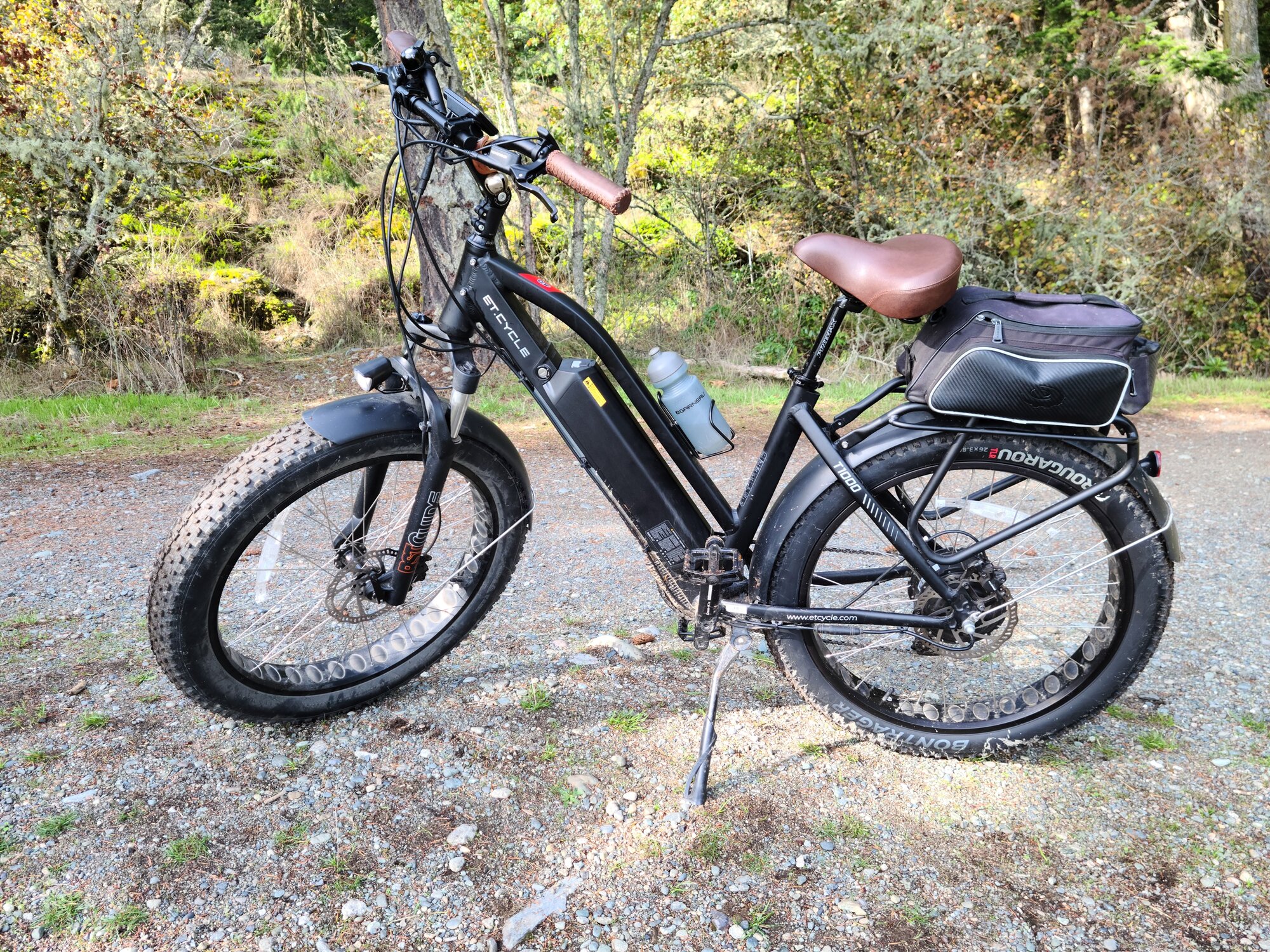

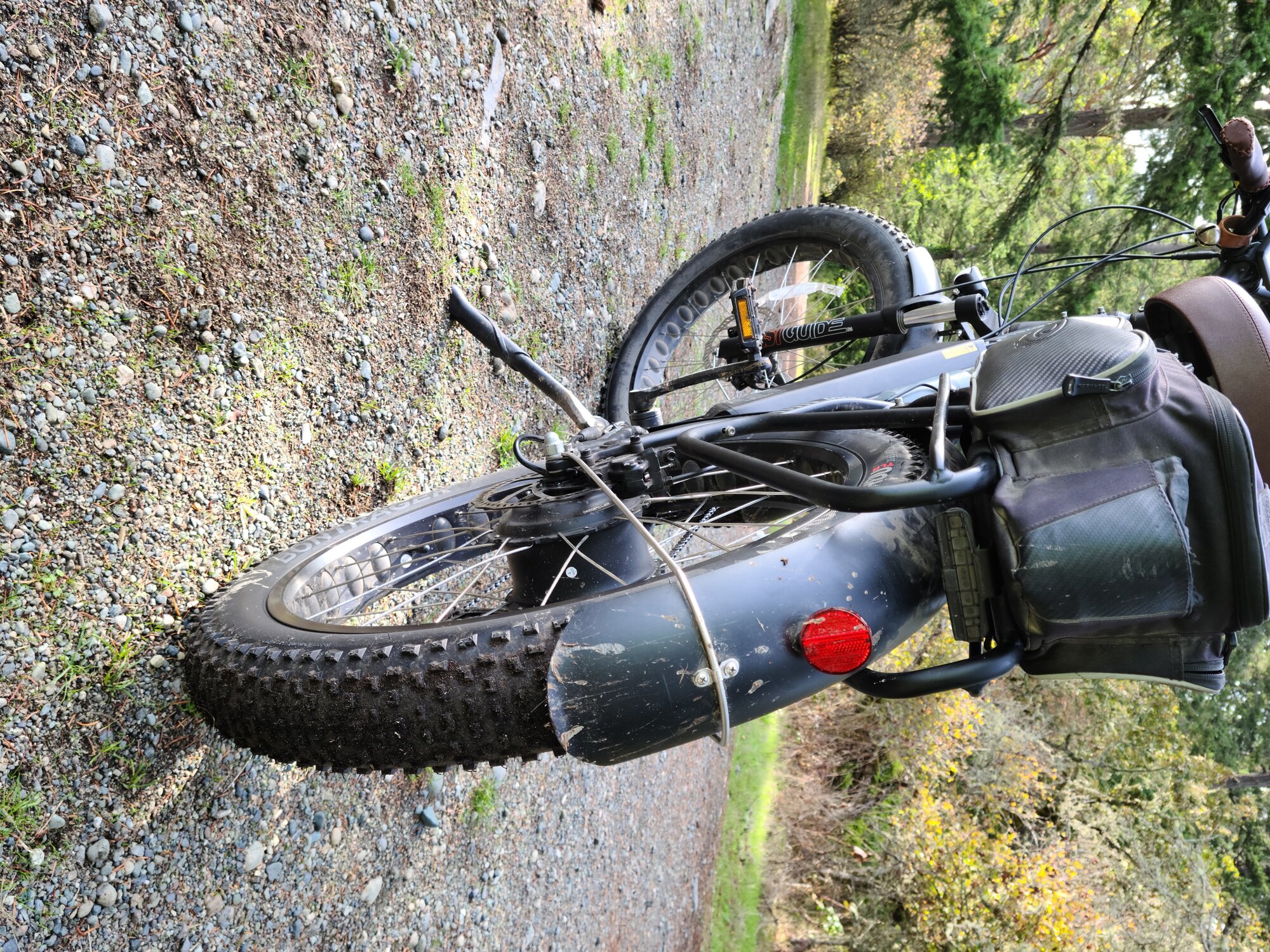

Happy to report the Rougarou's do work for the T-1000. You can even leave the fender on if you wish. Pretty pricey solution at $159 +tx Cdn, but a solution nonetheless. Took them for a good spin on some muddy trails and they performed well. Time will tell how well they hold up. Here's a couple of shots with them on my rig.

Nice looking skins, still haven’t pulled the trigger on anything yet, glad they fit with the fenders.
