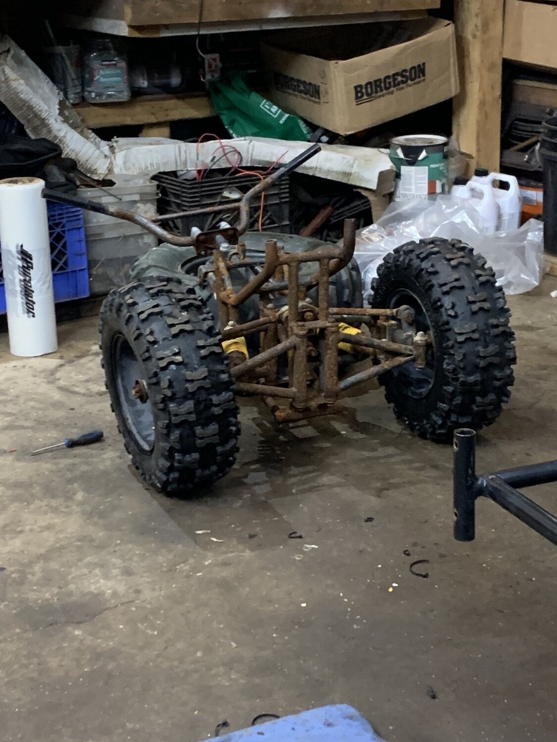

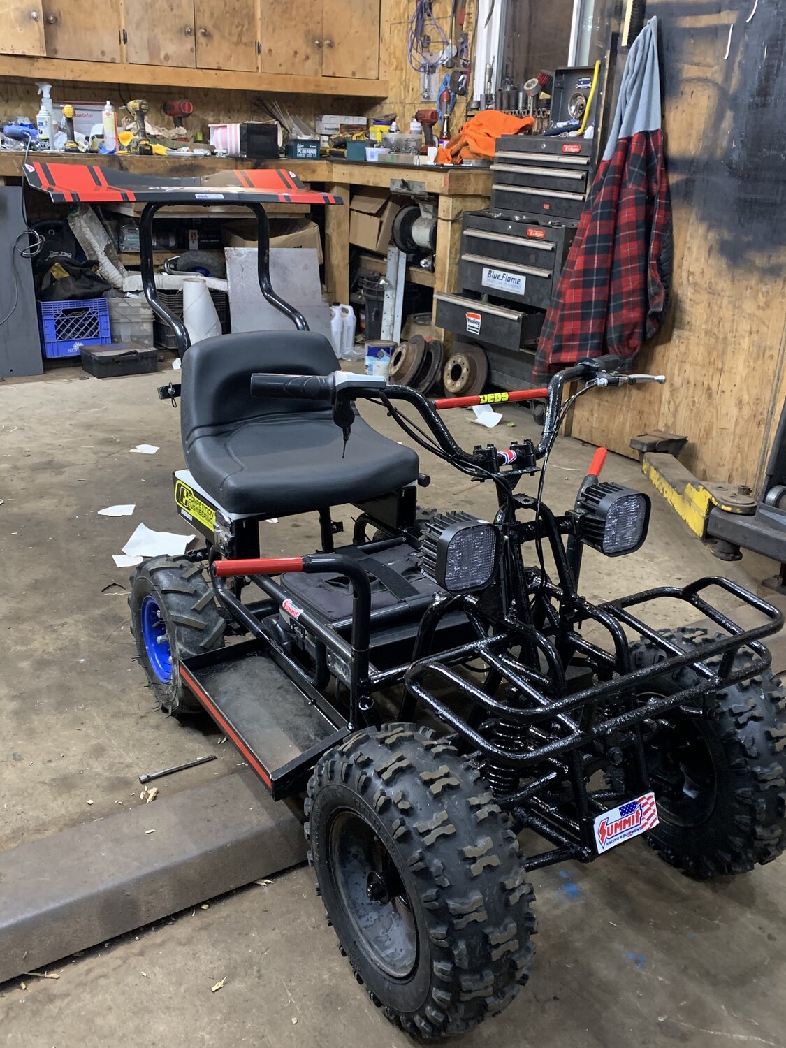

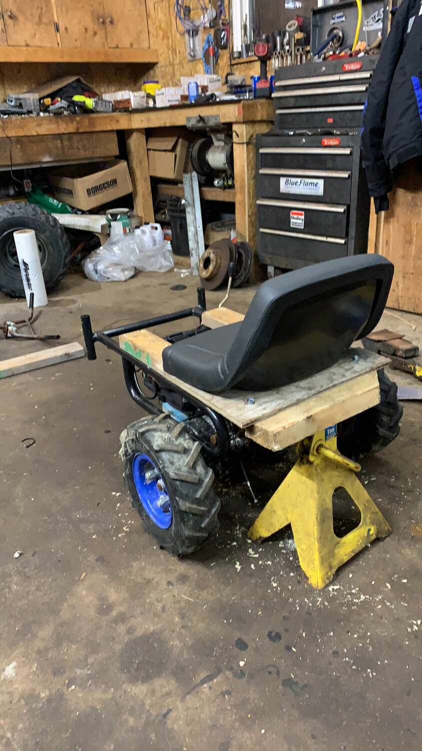

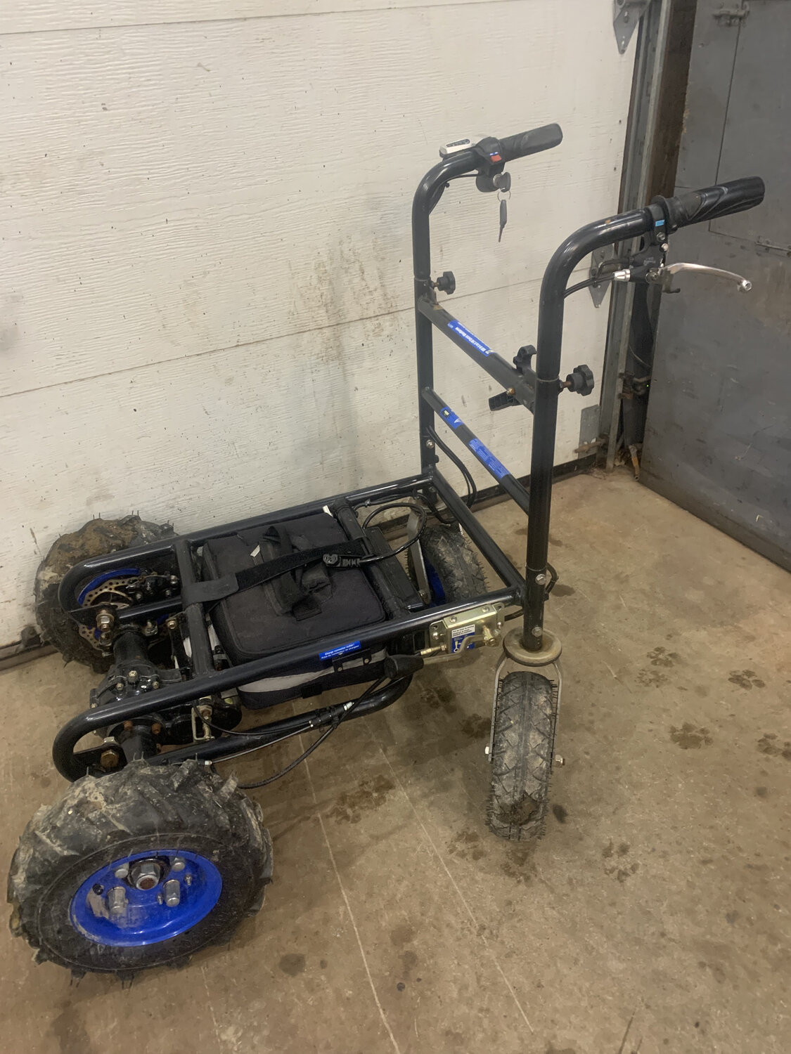

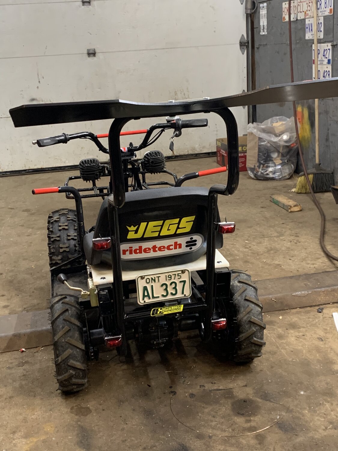

Hi everyone, I am a disabled person and wanted a electric bike. My buddy and myself took an electric wheelbarrow I had and converted it to a ride in bike for myself. The only problem is that it only has a top speed of 5 mph. Is there anyway to unhook the speed limiter to make it go faster. Any advice would be greatly appreciated.

Great work.
The details to answer to your question depends on battery voltage, whether it is a brushed/brushless DC motor, and whether it has a speed control already.
In many cases, the controller can be swapped for a new one w/o limts that fits the motor/battery. These are usually inexpensive since you only need a speed control.
It is DC not sure about brushless, 48 volt and speed control throttle. Thanks for taking the time to answer,
A big factor is gearing. Because it is based on a wheelbarrow it is geared for heavy loads at walking speeds, for example to take fire wood up a hill. Using larger wheels could also up the effective gearing but would raise the center of gravity making it less stable.
