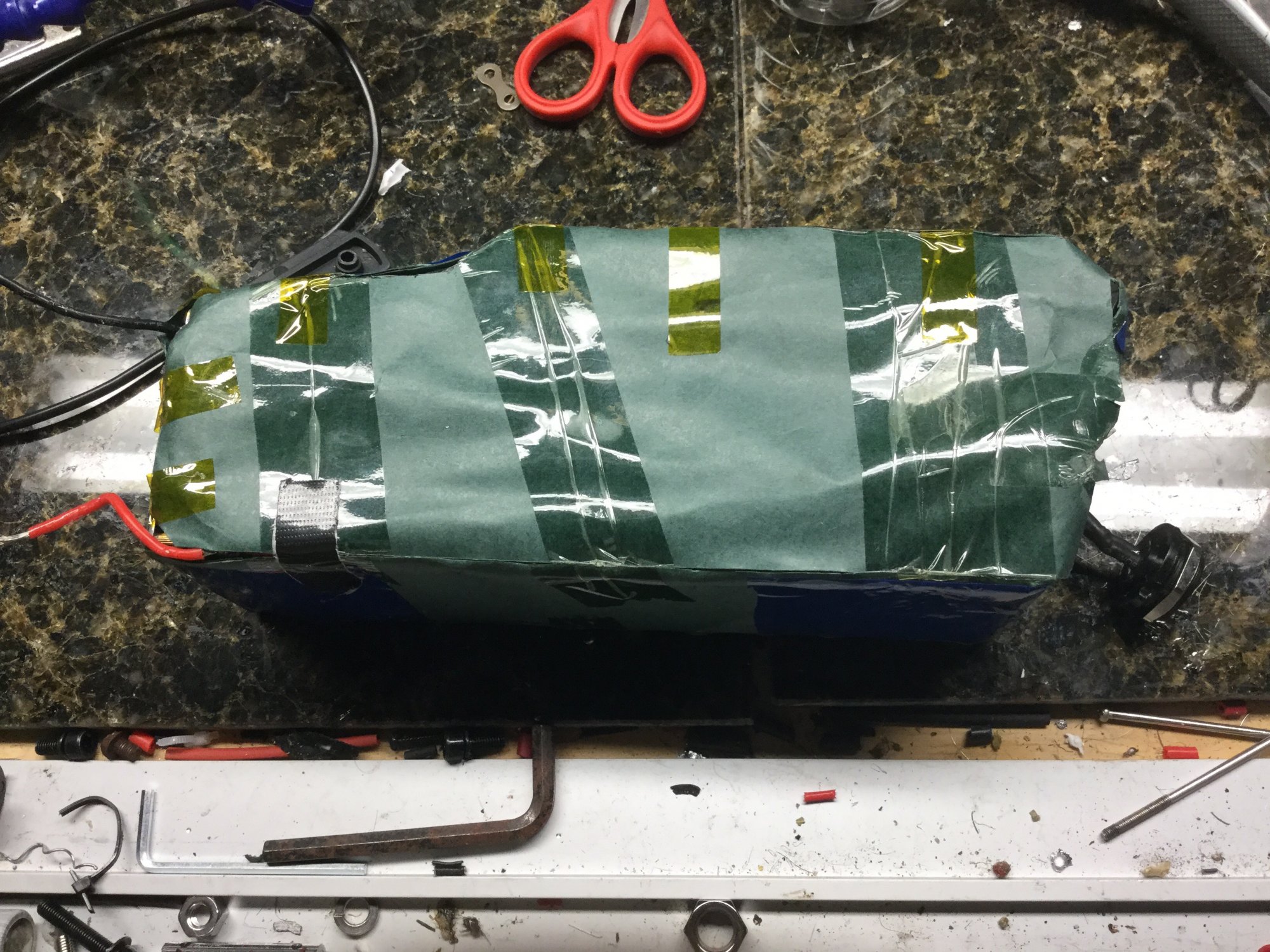

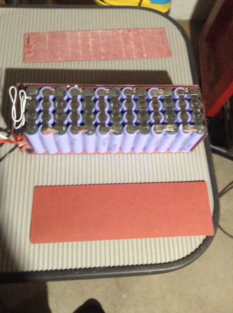

I always take them off. Why subject a battery to that potential abuse? My decision is based on 4 years of selling batteries and customer support. MANY of the batteries, especially on budget bikes are a failure waiting to happen. Too many of the Hailong cased higher Ah batteries have the cells glued together to fit them in.
