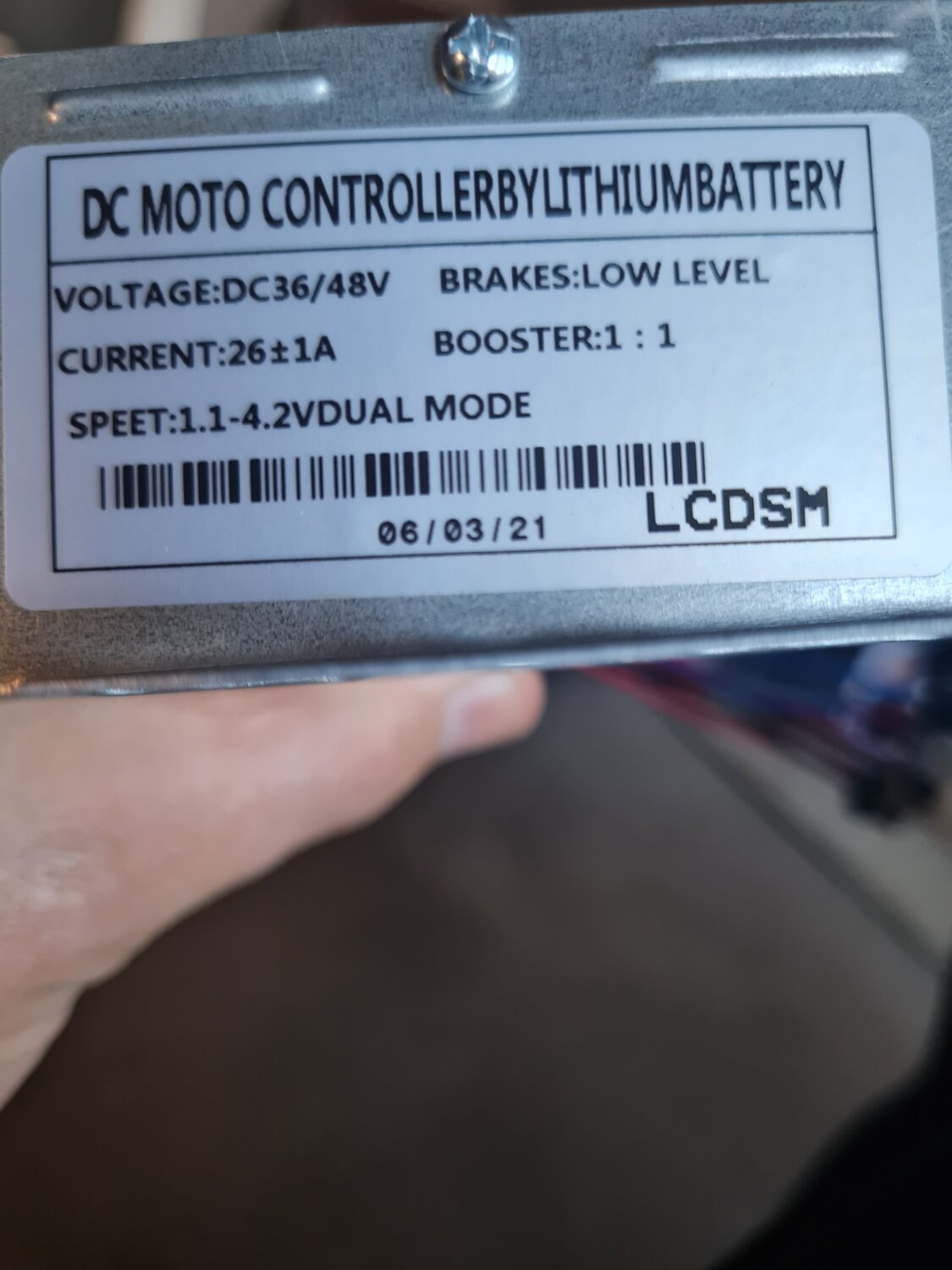

Which controller do you have, or post a picture of the label.

Thanks for the reply my my motor is a brushless gearless 1000w and I'll send pics of controller and my display is the sw900 as you know I've been into settings and modified it a little but pas doesn't really work properly but obviously my biggest issue is the voltage loss many thanks

Looking at that tag, while it may not be the best available, that controller SHOULD be up for the task of supplying power for your motor.

Thanks for your advice the 350w motors that I had were on different displays and controllers this 1000w kit came all together from g-volt as it is now ,without the battery so was hoping that my old battery would last for a while until I could replace it but it doesn't seem like the case , do you think I should change controller and display at the same time as battery many thanks
The p14 controller current limit is set at 26a the speed magnet is set at 46 which I've not changed

Pedal assist is really an afterthought when you have a 26 amp controller, I would suggest disconnecting the assist sensor, and riding it as a throttle bike. If you want to ride slow, it should easy to feather in about 100-150W with throttle. You could change the controller and set it to deliver 500W, but why do that now, Your resources should be allocated toward a dependable battery.
Anything that is low cost will kill itself trying to supply the 26A your controller demands. Look for a supplier that is honest enough to tell you how many amps their product can supply.
