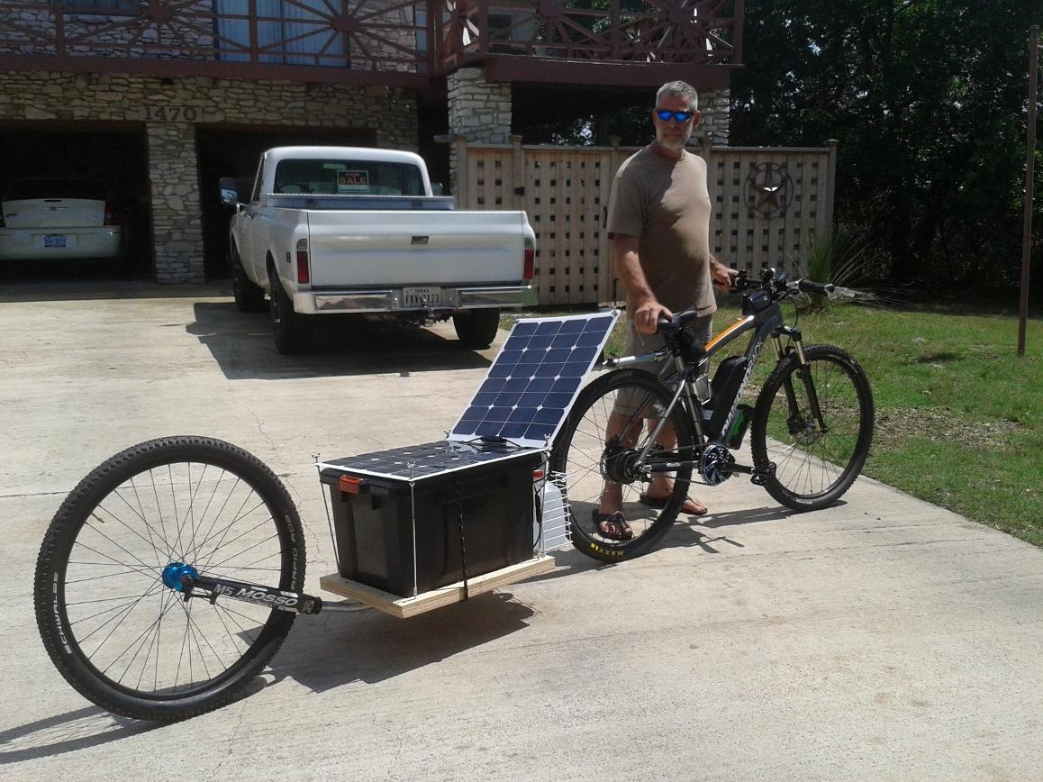

My $.02, I'd go with the Bafang mid-drive. I put one on a Diamondback Overdrive Sport with a Nu Vinci CVT, and two batteries. My trailer is a hand made, single wheel design on which I have 150 watts of solar panels and a Genasun charge controller that charges lithium ion directly. I can charge one battery while I run on the other, which gives me almost unlimited range. I wear out before the batteries do! I have towed approx. 60 lbs in it and have gone up some very impressive hills. Without the trailer, the Bafang will propel my 220lbs up a 20% grade with no pedaling and maintain 6-8 mph. With the trailer I am limited to about 12% grades, which is still quit steep. On the flats I can pull the trailer at a steady 20mph no problem.
Thats a sweet setup!
