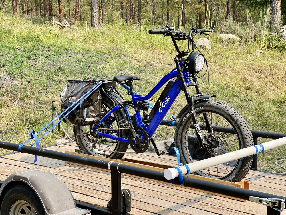

Weight: this is a heavy bike. It feels nicely stable when moving along; but more tippy until it gets rolling and more difficult to lift or load. I use a flatbed trailer (with loading ramp), rather than a hitch mounted rack.
