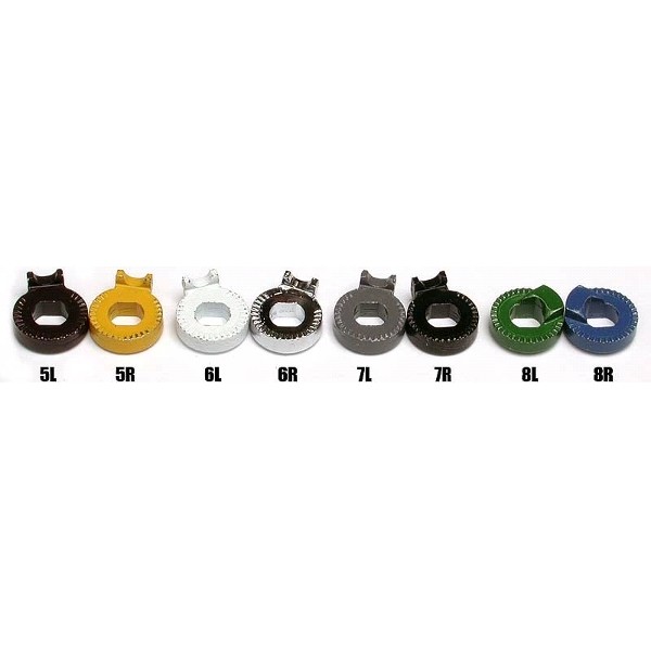

I know you had some trouble getting the hub to fit in your dropout and I hope this won't be an issue on pre-built bikes.
That's exactly the thought behind this product.
Apparently it works with Di2, makes it lot more easier. And Di2 is a proven, solid technology used in Xt and XTR Di2 groupsets.
I believe I would have perhaps not had the issue with the proper non turn washer in place
however even after discovering the importance of these and getting the right ones I would advise anyone using any Alfine system to be sure they use the appropriate ones for their drop out design which shouldn't be a problem with pre-built bikes anyway.
