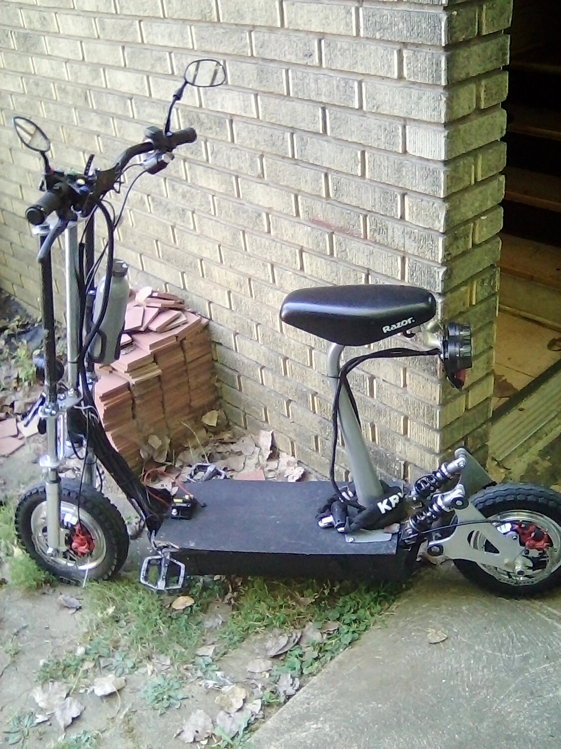

What's been happening Rich c is I give throttle and hit lvc it makes an awful noise any idea why. I had put a 20a BMS on it and went from twist throttle to a thumb 13s is 4p everything was fine before the BMS switch. What you think should power this scooter

If you hit LVC when you twist the throttle, I think the battery is too small for the current demanded by the throttle. Maybe crack throttle just a little.

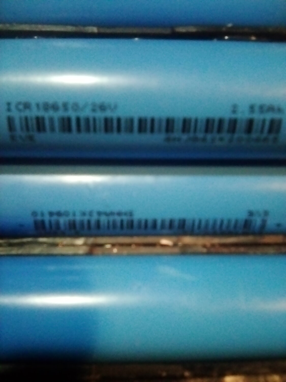

Salvaged cells from 36v led light packs bought 160 for a Benny they look genuine double ring at top Had a mixed batch of cells before thinking different max output probably was wrong to do. These are all the same being rated at 2.55 mah when tested they run about 2778mah and 9780mwh I'm thinking these are close to a 3c rating maybe a 6p would be better.

The label say ICR1865026V cells. I found this data sheet from secondlifestorage.com and also a manufacturers data sheet.
Max discharge is indeed 3C, or 7.6A, but your cells are used and who knows what the internal resistance is. It seems high enough to wipe out 16 volts if your display shows LVC on full throttle. I assume you can watch the voltage in real time.
I think you need to try 8P. That would halve the voltage sag if IR is the problem. How good are the welds, by the way.

If you're seeing a drop from the 58-59 volt of a fully charged 14S down to 44 V, that's a pretty weak battery,

Let's take the welding out of the problem. The problem is you have 64 cent used cells, and not enough of them. Bypass the BMS temporarily for a test run, you'll see the same behavior.
