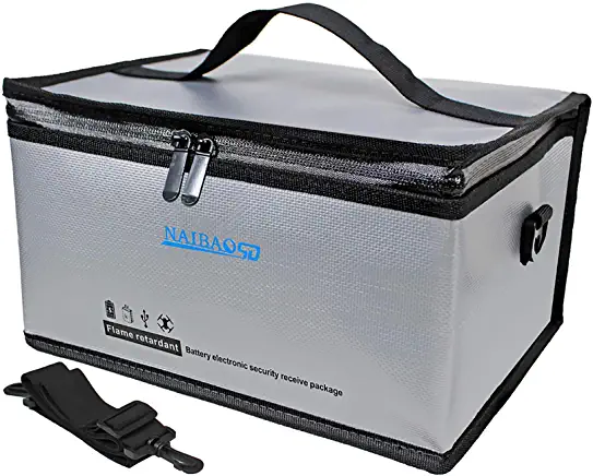

I live in an apartment with no garage. My Gazelle T10 is chained up underneath the back stairs of the building. I take my battery into my apartment to charge. The owner of the building has legitimate concerns about safety in the unlikely but still possible event of a battery explosion. So I'm getting a LIPO bag, but it seems that most of them are for smaller RC airplane batteries. I'm also getting a stand with a ceramic tile base to put the bag on, so in the event of a fire the heat doesn't scorch the floor. (Also a fire extinguisher and a smoke detector to place above the charging site).

Thanks for your tips, Sierratim. Also the figures you quoted will probably put my landlord at ease. I found a bag on Amazon measuring 11 x 8 x 6 in. My battery is is 14.5 inches long, so I'm hoping it will fit diagonally. We'll see.
Looks like the long diagonal is 14.87 inches so your 14.5 inch battery has a shot at fitting, depending on its W & H dimensions and the flexability of the charger bag. With the free return offer you've got little risk here. Good call. Hopefully this will put your landlord at ease.

I got the bag, and it does not fit. Even trying to cram it in diagonally, no can do. Looks like an ammo can may be the solution.
