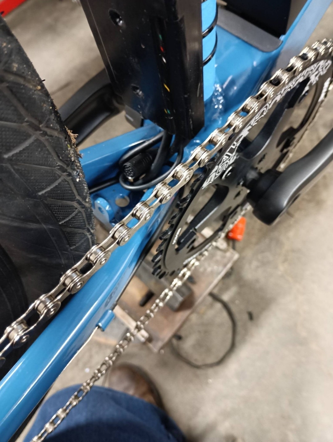

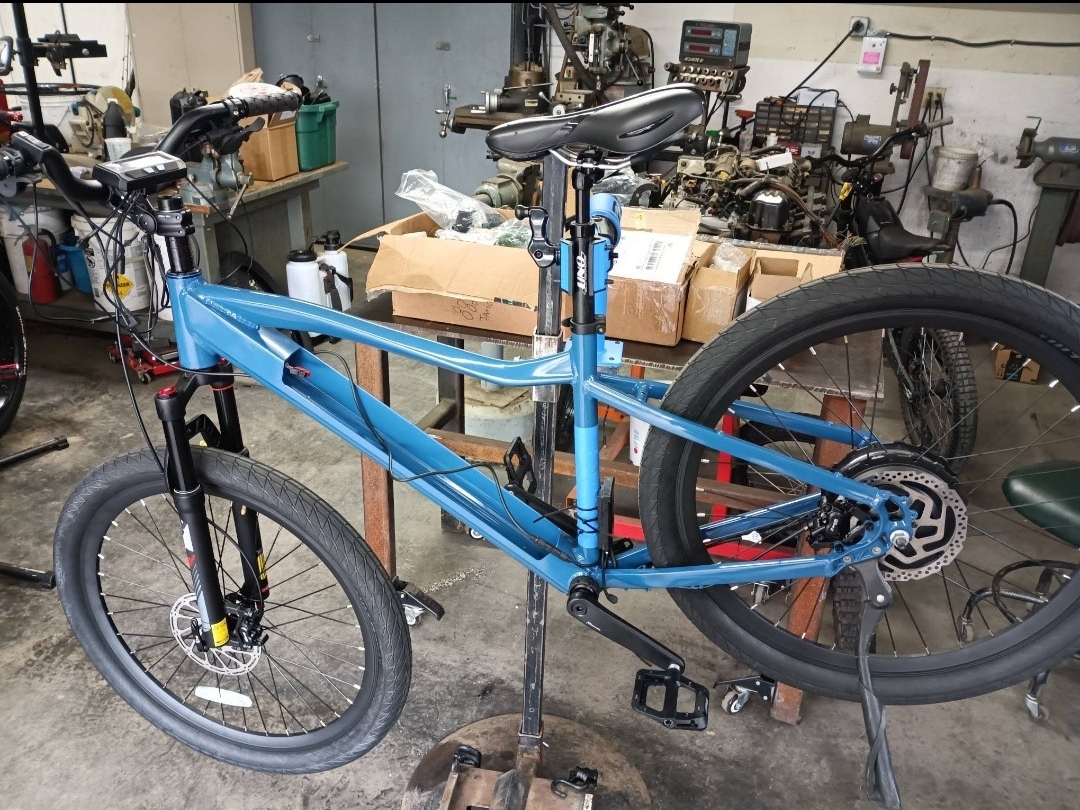

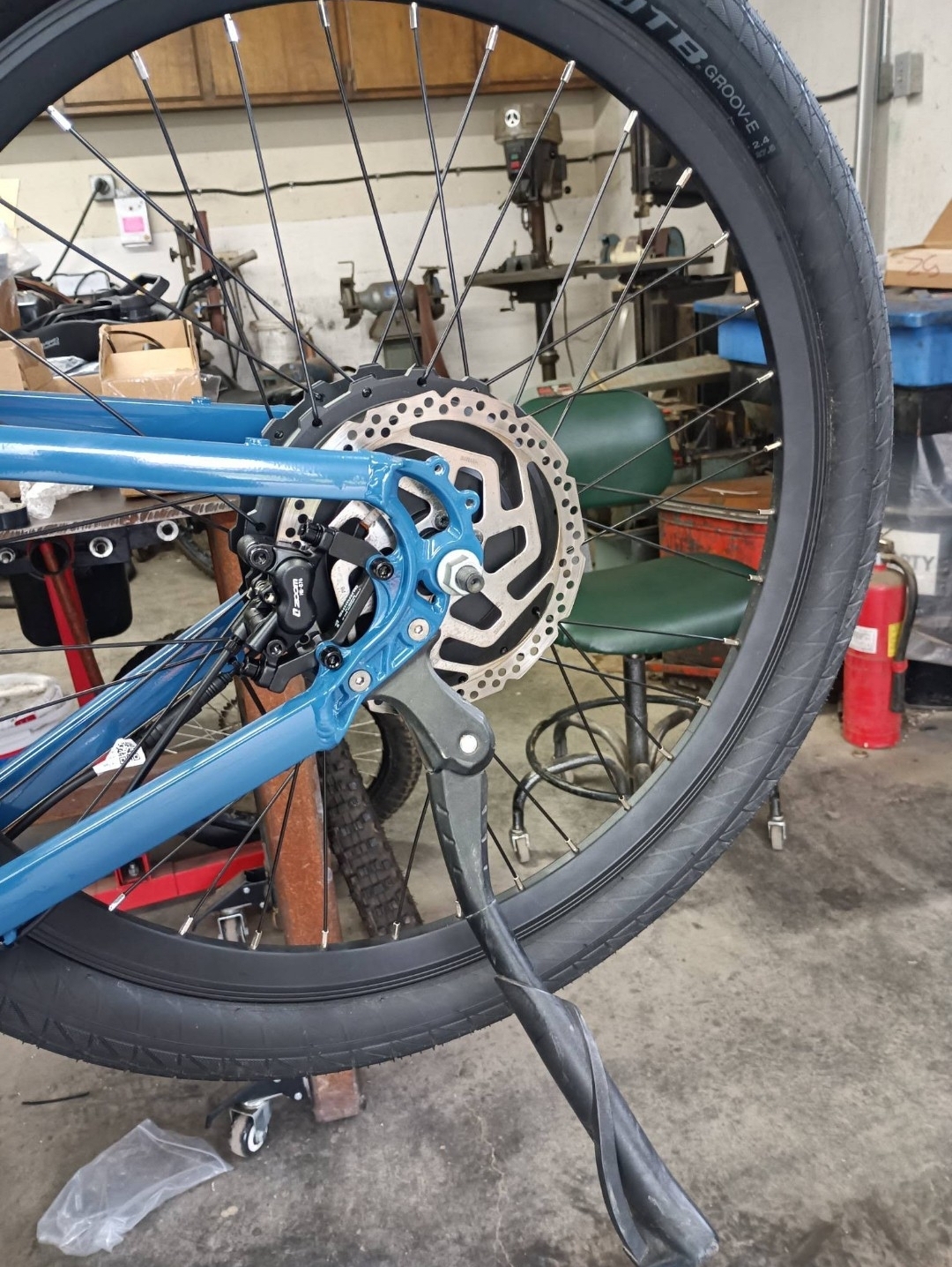

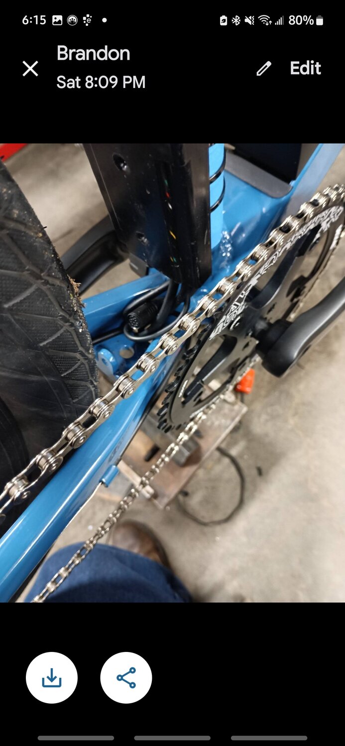

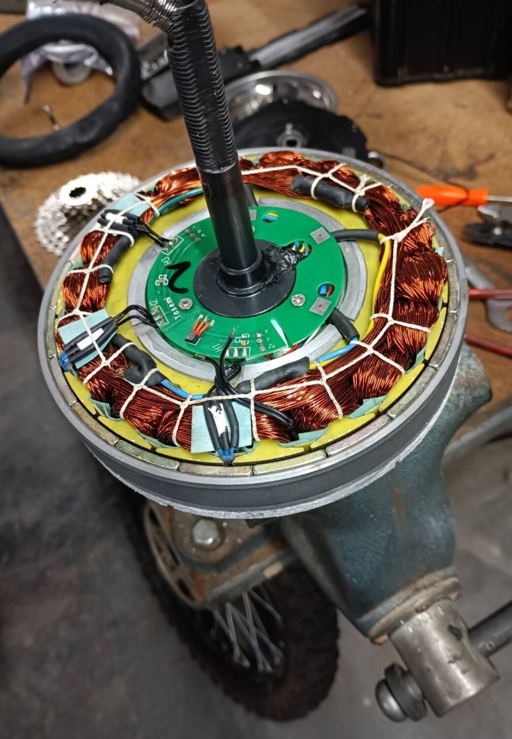

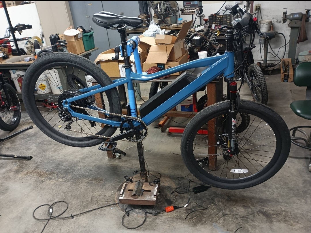

I'm currently working on a build using the R1UP MXUS xf19c, BaserunnerZ9, and Cycle Analyst, paired with a 52v 20ah battery featuring a 40a BMS and an e-rider torque sensor. Although the motor lacks a thermistor, the BaserunnerZ9 compensates by reading both speed and temperature through a shared output. Contrary to rumors about weak axles, the motor proves robust and, while a bit loud, exhibits impressive power, reaching 1200 to 1500 watts with ongoing adjustments to phase and field weakening. Temperature readings indicate 50°C after numerous full-speed runs.

Added thermistor to the motor and works great 👍 switching to Phaserunner and super harness
