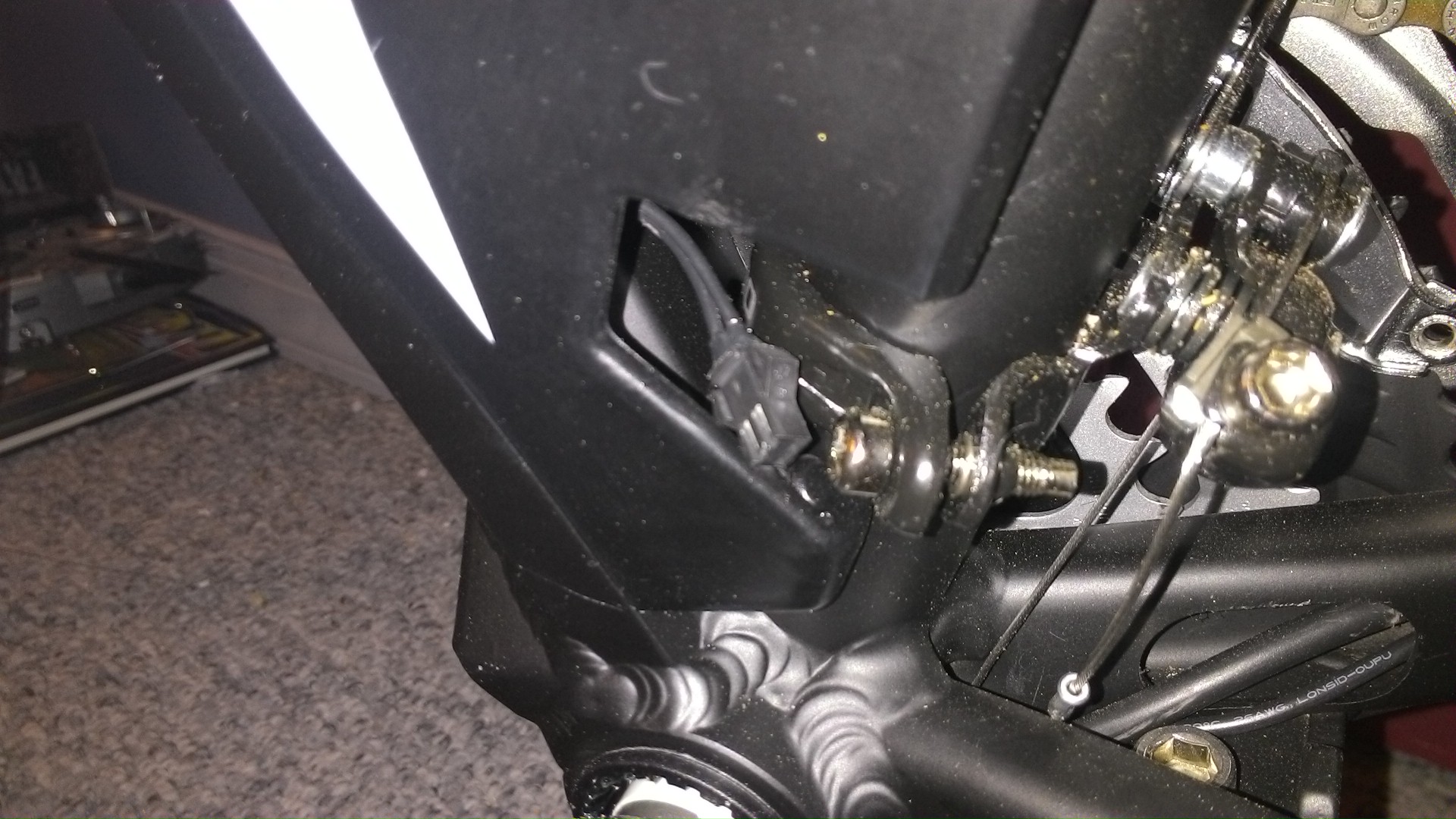

Hello,
Does anyone know if the wire in this picture became disconnected from something or if it is for a future add on or something?

I've never looked behind that panel to investigate what is behind it, but I'm guessing that if everything on the bike is working, then it's possibly a diagnostics wire.
Really sorry, I can't answer that.
I can't see it on my bike, but I'll hunt out the dealer workshop manual later and take a look to see if that sheds any light on it.
Second thought, I can answer it. :)
I pulled mine apart to take a look for you. There are actually two sets of wires that aren't connected to anything. Sorry about the blurred 3rd photo.
The black wire is in exactly the same location as your wire, but tucked back into the frame, with the connector facing downwards.
I've never pulled this cover off before, and I was actually surprised by just how little crud had got into the area. It is obviously pretty well protected. All credit to BH for that design feature.

I suspect it is for hooking up the lights that run off the main battery. That is what I noticed from this video, long back. I might be wrong. Frazzxr, a call to Chris Nolte might be useful.

EddieJ, you really didn't need t pull yours apart, thanks for that!
I was just looking for confirmation that it wasn't supposed to actively be connected to something it wasn't....
I am gonna tuck it in and call it solved :)

I saw the same exact wire when I put together my Neo Carbon. I always wondered what the heck it was too! I shuffled it up and in and forgot about it. I hope you get a definite answer.

Hello,
This wire is for programming at the factory. Just tuck that one back in as no one uses it, not even us dealers.

That's actually wires for lighting. The Stromer comes prewired to accept the City Kit.

In order to run lights on the Easy Motion bikes you need a light kit from Easy Motion, it runs $50 retail. It's essentially a step down converter which takes the 36V and steps it down to the 6V you need to run lights. Certain lights, including one of the Supernova models can accept a variety of different voltages, but 6V is more common. Keep in mind this is DC, so you need to run a light that accepts it, as most dynamo lights are AC. There are three headlights we work with, 2 Supernova and 1 Busch and Müller. Currently they are all sold out at both of our distributors, but we have a bunch on order.

I take exception to you comment about Stromer and the hanging wire, but i do it w/a smile :). It is a wire to get to the motor , I have the kit installed and the wire is still there. It has a protective piece over connector. I heard on the earlier models when it got wet it caused some issues. It was also to get to the motor controller then too :)
The wire I am speaking of is at the rear wheel on the side w/the brakes (right when looking at the front). It wont stay bundled up with rest of the wires that are run back there.

Sorry about that. You are correct. I thought you were speaking of a wire near the bottom bracket like the Easy Motion. Before the lights are connected the wires come the same way.
Chris, I am a consumer and you are a professional, I defer to you. I just knew once we communicated correctly it would be a non issue. Thx for following up :)
