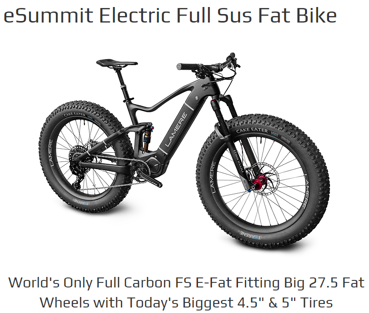

Basically, I want this bike with the following upgrades:
Gates Belt Drive
Rohloff Speedhub
I could live with the other stuff on it, but would rather have a different motor as it comes with the Shimano motor - can't change it out though as it is integrated into the frame. This bike is already $9,000 and if I switched to the Rohloff and added the Gates Belt drive, I would be adding another $2,000.
But aint she beautiful!!!

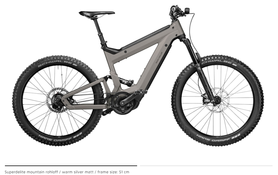

another option if I went without the fat tires for the same price would be the SuperDelite Rohloff:
I like the integrated batteries because it looks cleaner...
Gates Belt Drive
Rohloff Speedhub
Gorgeous Bike.
Yes the integrated battery is beautiful...but when it's covered in mud or snow it looks not much different than a down tube setup. ;-)

Have you tried getting in touch with Watt Wagons and LaMere? As I recall from this post, Watt Wagons might be the best shop in N. America that would even understand how to combine FS and belt drive and may give you some insight into how to overcome these problems. LaMere may tell you where they source their frames from or even sell you a frame-only option.
Even if you can afford to try, I don't think adding a Gates to that LaMere will work.
