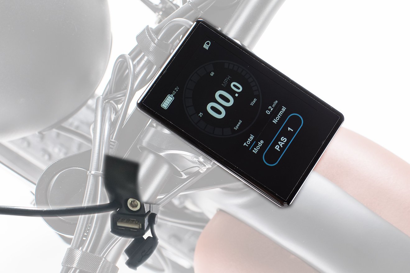

I see Revibikes offers the new 2020 color display for the Civi Cheetah style bikes. I couldn't find a model number but available for $159. on their site.
I plan to upgrade to this model in the future. Has a 5v 1amp USB port as well as voltage readout and other great features.
