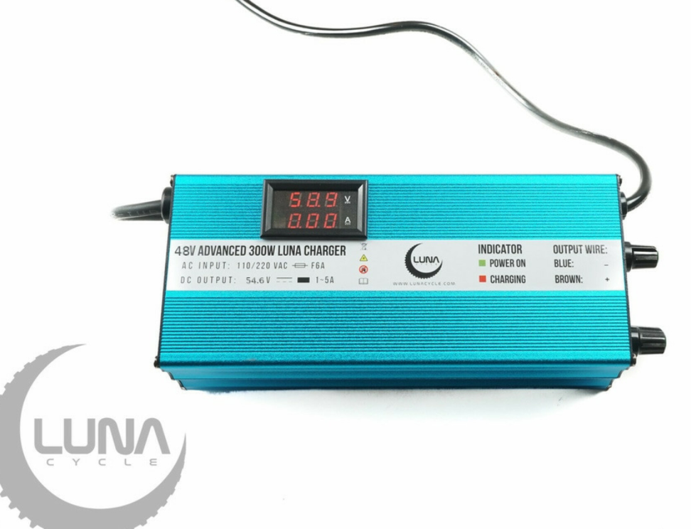

I wanted to know if any of you have used Luna Smart Charger and if you care to share your experience, I would be eager to learn more.
Also, what feature you value the most in a charger?
Is it fast charging or smart charging, please do share !
I have a charger that does 2-4-6-8-10 amp charging along with 80-90-100 % and I have a charger that does 4 amp only 100%. The one I use the most by far is the quiet one , the 4 amp. I would do some 90% 2 amp as my normal if it was quiet. I have 2 of each chargers for currently 5 batteries although mainly 3 at a time. I use 2 of the quiet ones and charge 3 batteries 2 at a time And then the 3rd battery before I sleep.

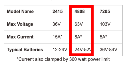

Being able to set whatever percentage I want and data tracking to follow battery usage and lifespan. I have an early Satiator, a 72V(sold), and the latest 63V max version.

I have several older Luna chargers and they both died within months. I do also have 3-4 liitokala fanless cheap chargers I use outdoors occasionally in the warm weather.
Currently on sale! The price has gone up. Probably the last chance at this price. $269 delivered.

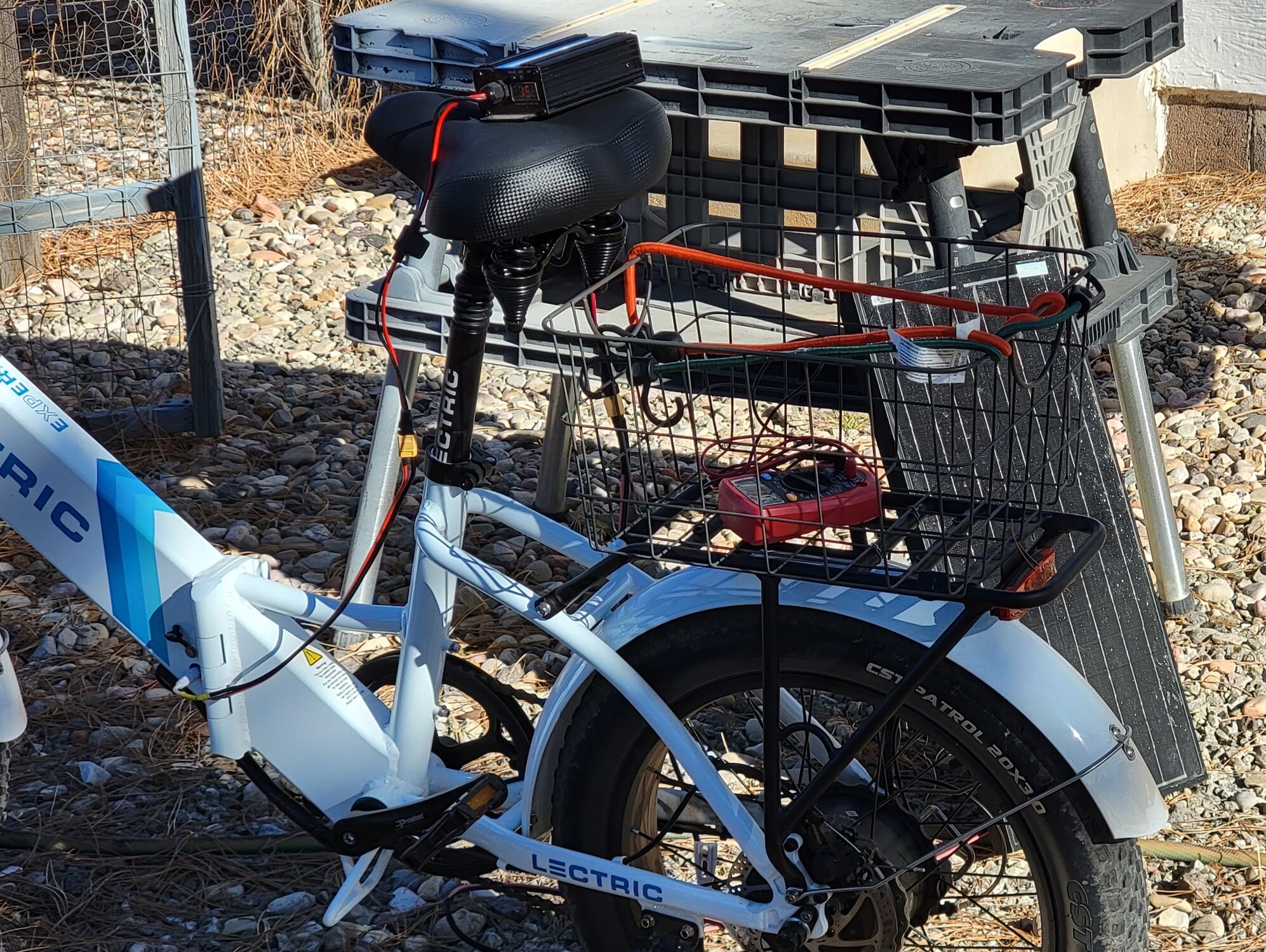

If the sun is out, and it's fairly warm, I use a Boost MPPT solar charger that comes out of China. You can set the voltage, so you don't have to do a full charge. I use 56v for my LFP packs, 53 for the standard cells. I have a couple of these units. Some were $30. They will handle 300 watts, but it you want to slow charge just hook up fewer panels. In the winter I use this converter from Amazon. I set the voltage I want, and the amps. It needs a heat sink for big amps, but the ones I looked at were as much as the module. So I set it for 70 watts. I hook it to my 140 amp hour LFP set, 12v from ancient CALB cells. Probably from some bus somewhere. I don't know why people don't know how you charge lith cells, the whole CC-CV 4.2V thing. It's nuts. Charge from power supplies, charge from cheap lithium packs, whatever. Some of these prices are nuts.
if Grin does not have 72V in stock
They are available. The 2nds sold out. 25% off until the 31st.
If anyone wants a 72V Satiator charger, HillEater has on in stock.
$397 Canadian ($311.61 USD) C$444.64 with tax in CA.
it's on sale. That's not a great price! $324 CA, shipping $20 or a bit less. From Grin.

I have 3 ebikes and charge from a 400 watt off grid solar system with a 500 watt inverter.
I only charge when I am around to watch the battery in case of a fire and I prefer to charge outside when possible.

I bought the Luna charger you pictured (Grin Satiator was backordered when I tried to order one), and like it a lot. 1.5 yrs use with many dozens of cycles and no issues, although I have read that reliability can vary. It has the right basic features for me in that it has the 80/90/100% selector, amp output choice for rate of charge, and a little LED that gives basic voltage, etc.. I still would like to grab a GRIN at some point as I'm techy and would like to have the history, etc.

Another Luna Advanced charger owner here. 16 months of experience with a 52v 14.5amp 21700 based battery. Like Marty has mentioned above I also normally charge at 2amps to 80%, and then if I need the full capacity I set the charger to 100% and charge just before I ride. If I'm short on time I might also bump up the amperage rate, so I've sometimes given the battery the last 10-20% at 3-5 amps. (my battery/bms is rated to charge at up to 8 amps)
The flexibility of the Luna charger is what really impresses me. Two simple and easy to understand controls and the display gives me the charging flexibility I need with the understanding of what's going on.
