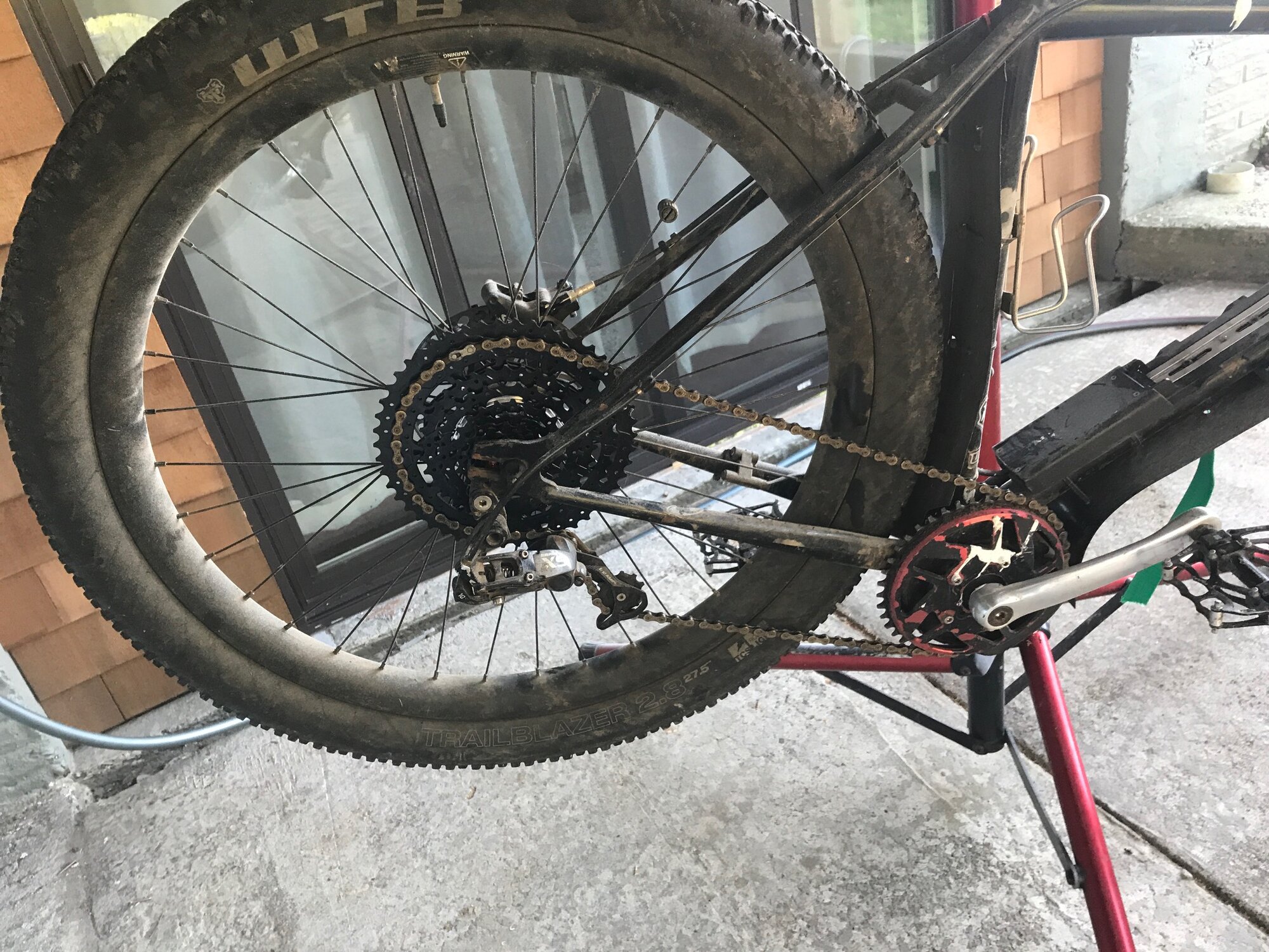

Could use some help here. I have a Trek Verve + 3 that I am increasingly riding off road, so new Puroma flat pedals went on today, Schwalbe Marathon 365 700x45 tires on the way, suspension seatpost and stem installed, chain guard removed...etc. Today I also received a SunRace 11-46 cassette (original is 11-36) and have a 136 link KMC X9e chain enroute. I have tools to change the cassette and chain. My chainring is 38 tooth. Derailleur is long cage Shimano Alivio. Original chain on the bike was 118 links.
Any recommendations on what a good chain length will be for my new setup? Thanks.

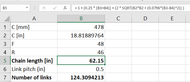

You can also the formula published by PARK TOOL or this CALCULATOR that produces similar results. You will need to measure your chain stay length to use either of these calculators.
From Park Tool:

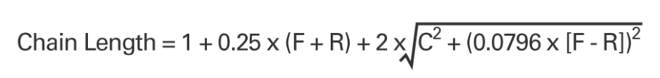

Simple Equation: L = 2 (C) + (F/4 + R/4 + 1)
L = Chain length in inches. Round the final result to closest whole inch figure. C = Chain stay length in inches, measure to closest 1/8″. F= Number of teeth on largest front chainring. R= Number of teeth on largest rear cog.

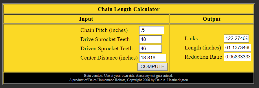

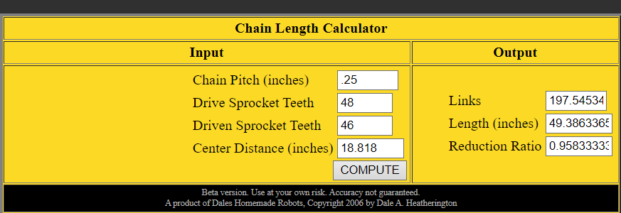

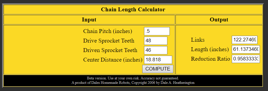

So I made the calculation with the yellow calculator provided here. It suggested 60” or 120 links, add two links for long derailleur= 122 links
Using the Park Tools formula, I come up with 61 1/2” or 123 links (no factor for long derailleur. So it looks like I should be safe starting with 123 links.
(46 T rear cog, 38 T front chainring, 19.75” chain stay length.)

I'm using the calculators to order chains that will work. Looks like you should order a 126 link chain. When it arrives I'd advise fitting it per the video by wrapping it around the largest cog and chain ring then adding 4 lnks for a long cage derailleur, 2 for a medium. Always works for me! 😎
I went with 123 links, and it seems about right... derailleur cage is pretty much vertical in mid-gear. The top gear in the derailleur cage was meshing with the 46 T low gear initially causing some noise and problems shifting out of 1st, but I have adjusted it as far away as it will go and after brief riding, seems to be quieting down. Not shifting entirely correctly yet, especially going into 9th, but working on it. Thanks for all your help mates!
50 km ride today, including some paved (not streets) and grassy hills that I needed to take a bit of a run at with my original cassette. I was able to ride up them with ease. This setup is much better for my mix of road and trails. Trails are starting to get wetter this fall here, so looking forward to new Marathon 365 tires arriving.

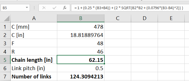

@Sierratim, @TS25: The chain with 126 links on the 48T chainring and with the 11-46T cassette with SGS derailleur on Vado 5 is close to the ideal you both described. My feeling is 124 links would make no harm either... So I stand corrected and intend to follow your advice to an iota in the future! :)

How is your shifting and noise ? I ask because I have teh 2020 Verve 3 in a generic Bike : It has the identical components you have . It came standard with 46 T Sprocket : I counted the links at 121 : I just changed My Vado from 40T to 48 T : At 40 Teeth the chain was 121 > Now it's 124 > I also noticed it was slightly nosier: SO I re-torqued My chainring Bolts and the Noise is Gone : You should have made no difference in shifting by adding a larger Sprocket If the nose persists : I would pop out 2 links > I'm saying 2 because it's likely that's what will take to to the correct connection spot with links:
