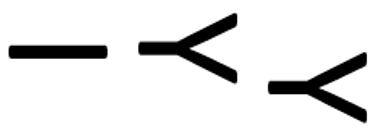

Can I charge three batteries (Creo main plus two extenders) simultaneously with two Y cables? In other words, plug the input of the second Y cable into one of the outputs of the first Y cable, giving me three free plugs.
Has anyone done this?

Correct. The Y cable won’t work if plugged into only one battery. For anybody reading this who is unfamiliar with these cables though, it’s important to realize that the other end of the Y cable is plugged into the direct/single cable, so all you need to do is remove the Y and you’ll have a single.
The charger is designed to shut down when the battery reaches a predetermined voltage. With 2 or 3 batteries hooked up, the charger is going to be looking at/monitoring the AVERAGE voltage of the 2 or 3 packs. That in mind, when this average voltage reaches the charger's shut off point, it's going to shut down.
So that "average voltage" in mind, let's consider a couple of scenarios. What would happen if one of these batteries had a bad cell, and the average voltage didn't get high enough for the charger to shut down?
What if you had 3 batteries on, with 2 of them very low, and the 3rd barely discharged?

The potential for consequences here are rather worse than has been discussed so far.
Anyone who has parallel'd two or more batteries together knows that, upon connecting the batteries together with your 'y', you must have all packs at about the same voltage. Like, within a half volt. Less if possible (your typical adjustable charger or lab power supply allows you to regulate to one 10th of a volt pretty easily).
Why is this? Because electricity flows in both directions across a connecting cable. When two batteries at different voltage levels are connected, the two will equalize voltage via the higher voltage pack flowing current into the other until the two are equalized. This happens instantly.
Think on how that might be a bad thing for just a sec :D
