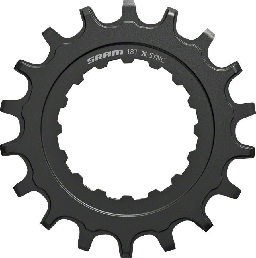

Sram makes a really nice Bosch compatible chain ring with a variety of teeth numbers. In order to take full advantage of the Bikespeed RS delimiter I installed on my Riese & Muller Delight Mountain I bought a 18 tooth chain ring made by Sram for $15.99 shipping included on ebay. It is way better made than the stamp cut ring made by Connex. It is cast and has more substantial teeth and comes with a 2mm spacer ring to use or not in aligning the chain ring. My bike came with the Miranda lock ring/chain guard combo which is now just large enough. It would not really be functional with more teeth than 18.
Now I am spinning at 90 rpm going 33mph in top gear (11 tooth). In order to regain lost climbing power I swapped out the 11 speed Diore XT8000 11-42 cassette for an 11-26 tooth one.

Yes, those SRAM sprockets are much better quality. I have an 18t one as well but could not find any bigger ones. But this came with a washer that I am using under the Connex 20t now. I am keeping the SRAM as backup.
