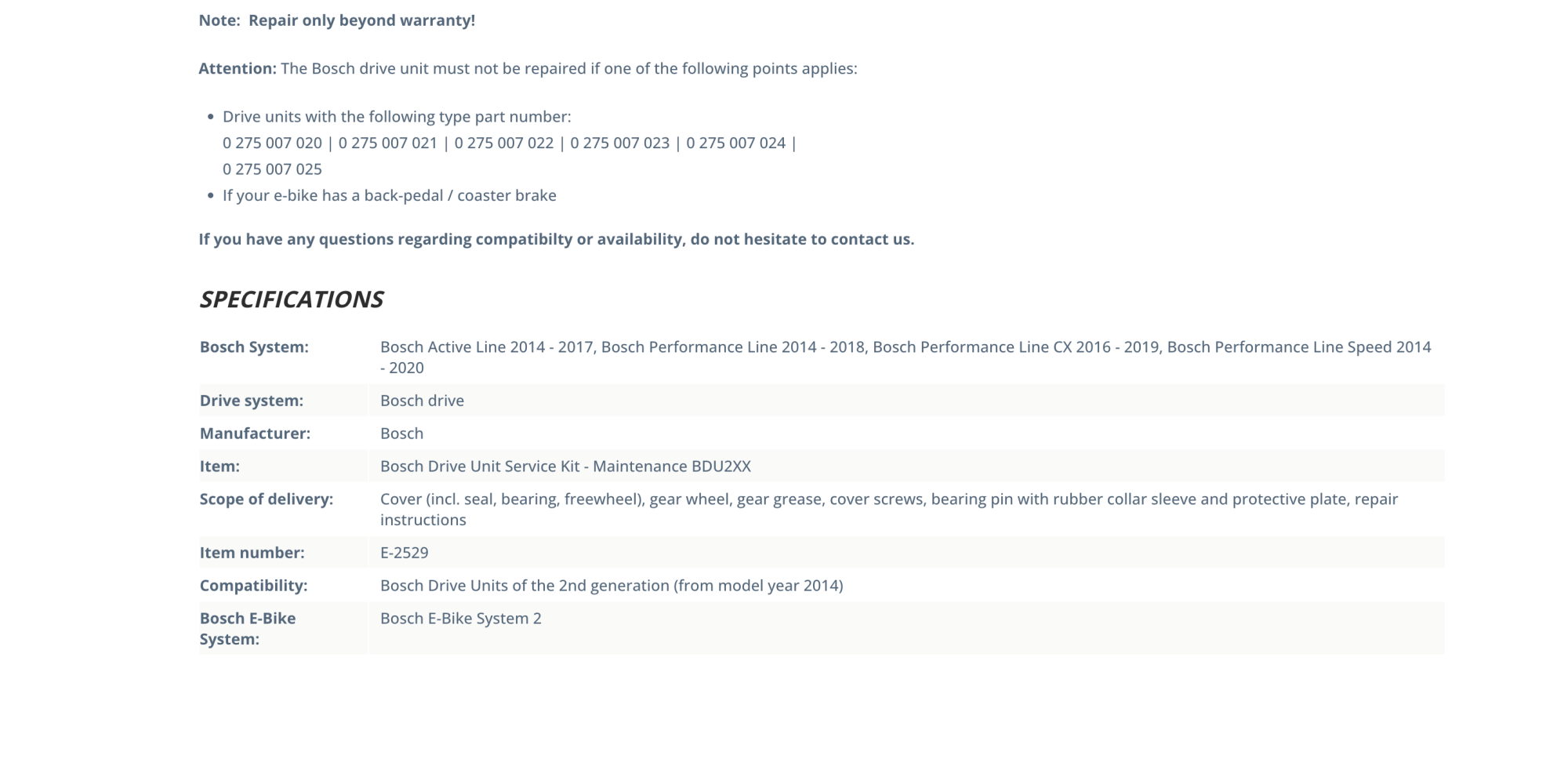

I need some help ! i bought a used bike ! and i have found a repair Bosch Drive Unit Service Kit - Maintenance BDU2XX but ! it is for Bosch Performance Line CX 2016 - 2019 . I googled ! the same models as mine exist in 2020 ( they look ) the same ! but what about my bike ? is it 2020 , 2019 , 2018 ? Is it Nevo 3 , 4 , 5 ?
Thank you ! first photo - is mine , the second 2020 ( from internet )

Your motor is a BDU2XX. There is only one kit for any of the BDU2XX motors (except the ones with coaster brake, which yours does not have).
So this kit is the right kit for your motor.

The R&M model year of your bike is irrelevant if you already know your drive unit part number. You have the right kit.
are you 100% sure ?
If you are 100% sure the pictures and part numbers you posted are correct, then yes Wildtrak knows his stuff.
Yes. I installed that multiple times already.

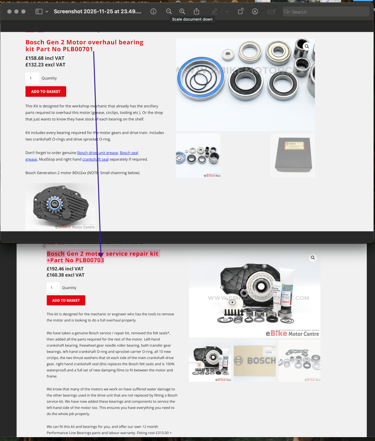

Please take a look on this numbers in the end ( does it only mean the difference in complication ( expanded and not ) i mean bearings the same for my engine ?

Go with the Service Kit, not the bearing set.

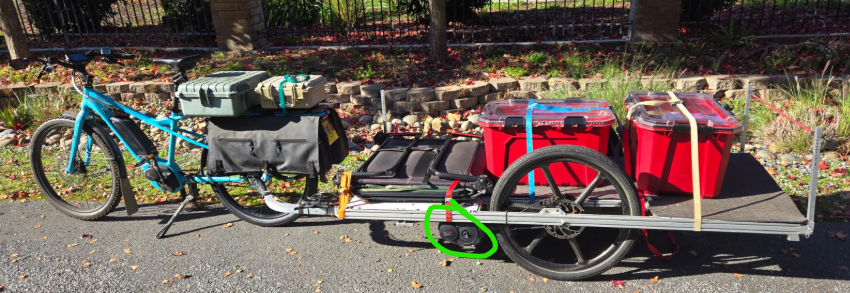

BTW, I have a spare motor in my trailer to give it an extra boot on steep uphills :D
