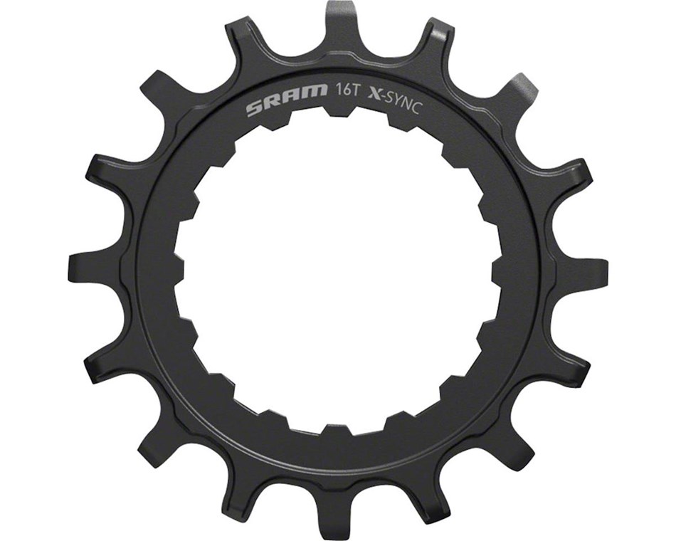

I use the Sram X-sync Bosch chain rings. They are cast, not stamped, with reinforced teeth and by far the most durable, smoothest shifting. Quite reasonably priced at $18.25 They are available at 14,16 &18 teeth. They come with a 2mm offset spacer ring.

Well that work with a 12 spd system?
Does look well made.
I don't believe that the front chain ring is specific to any particular cassette.
Its designed for a 8 spd system so may be wider, the 12 spd has quite a narrow chain so may not fit over that chain ring.
I have e-mailed a local shop that sells them to see if they can be used on the 12 spd,I think probley not ,be great if it did though.
I am using it with an Shimano XT 11 speed system and have put over 4,000 miles on it in the past year, without any issues. I can't say that it will work with a 12 speed.

I think the chain ring with the offset on the inside, pushing it out to the right, is the same on my Delight Mountain. I have been able to use the Sram X-sync because it comes with a 2mm spacer ring that you put over the drive spline first and then slip on the chain ring. This also allows one to flip the chain ring to get longer life out of it. The Sram X-sync is machined with reinforced teeth. And @Shane(NZ) I checked in the local Trek store where they have quite a few mountain bikes with the 12 speed Sram setup and the chain ring has the same machined profile on the teeth that they use on the Bosch compatible ring.
