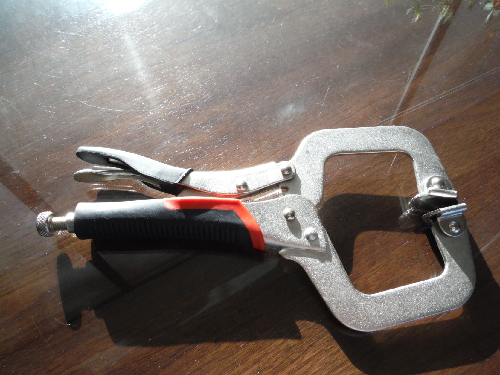

Thanks, but couldn't pinch to center since the tire beads on both side stuck to the rims.
stuck to the rims.
I had that last week with fat 3 inch tires. I used this. It is about 11 inches long. That problem is rare, but happens sometimes, mostly with balloon tires.
Nowadays, with tubeless-centric rims, its the norm. The damn things are actually built specifically to do this. I have some wheels - in particular my Surly My Other Brother Darryl rims that came stock with my Big Fat Dummy - that are so bad I send them to my LBS to swap tires when the time comes. In fact on that bike that is the sole reason I decided to do a second wheelset, because I knew it would be impossible to do a roadside repair with them. My LBS concurred and said they were the most difficult wheels they'd ever worked with.
