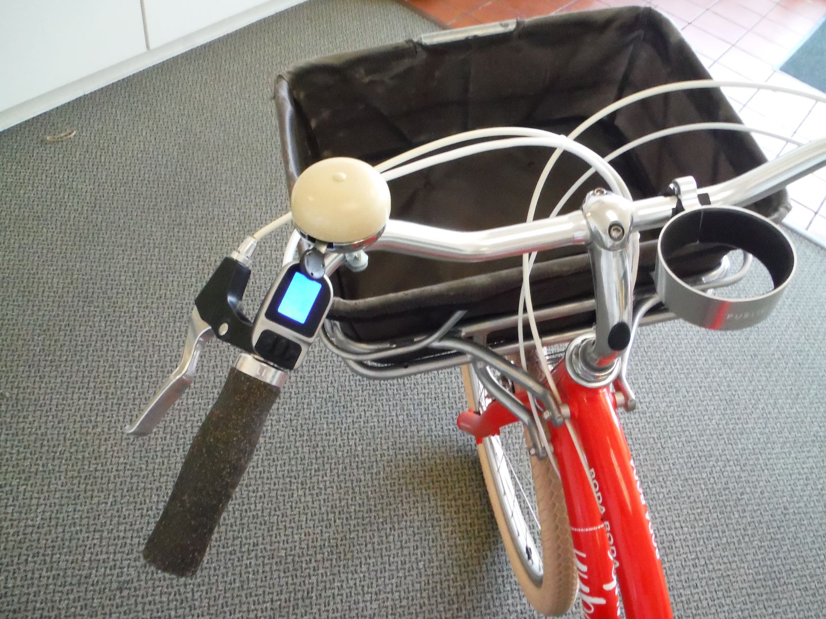

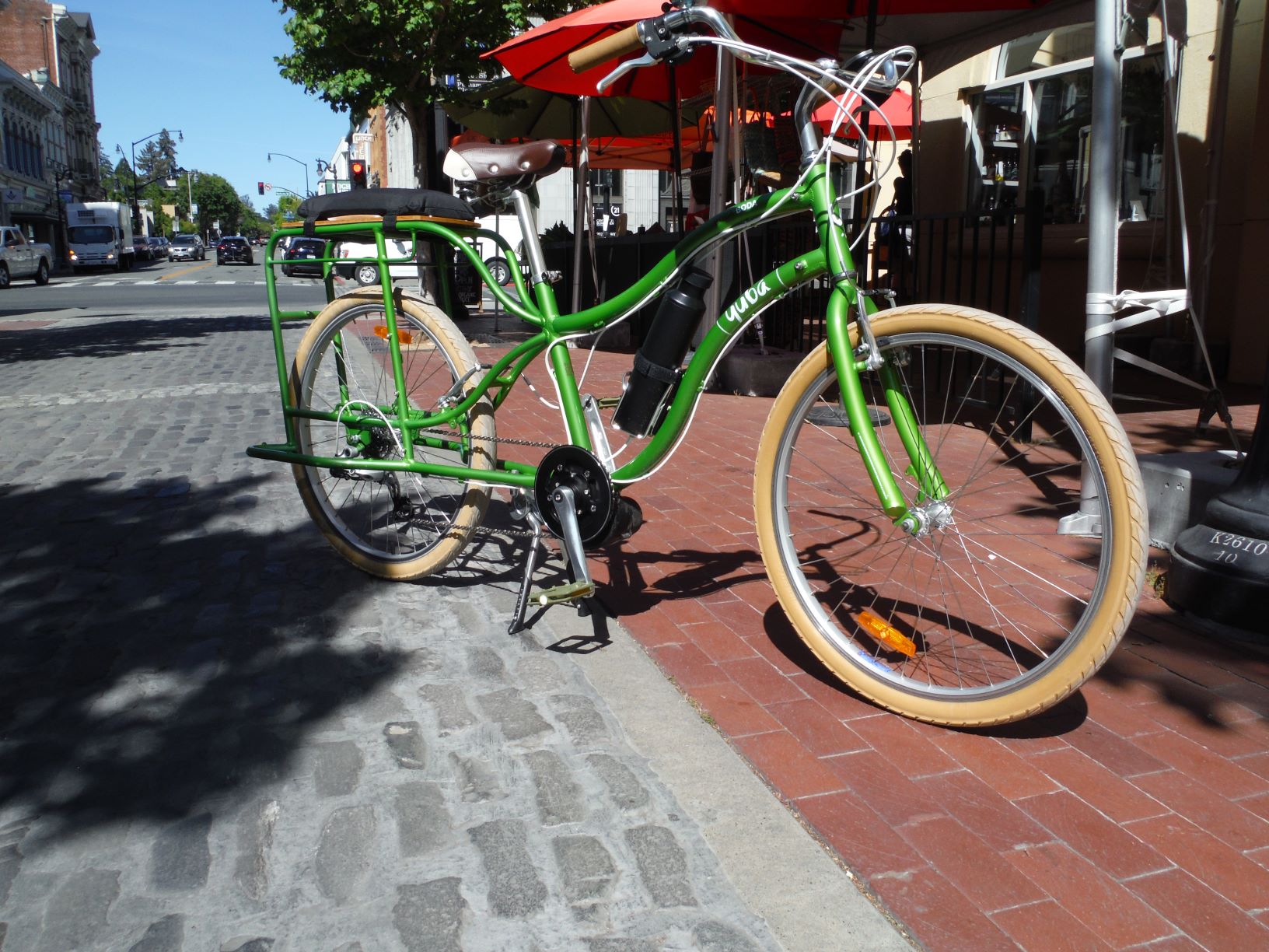

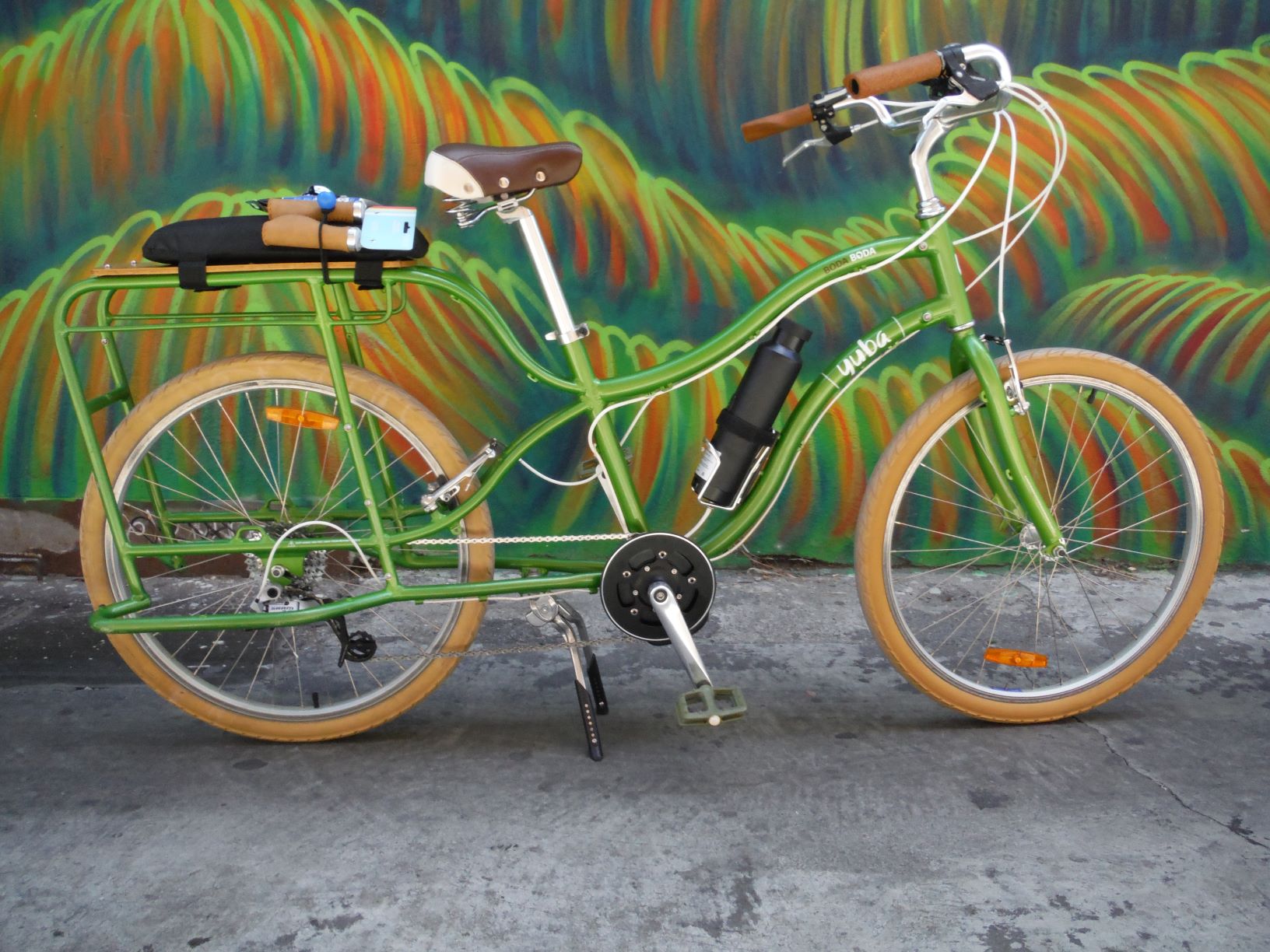

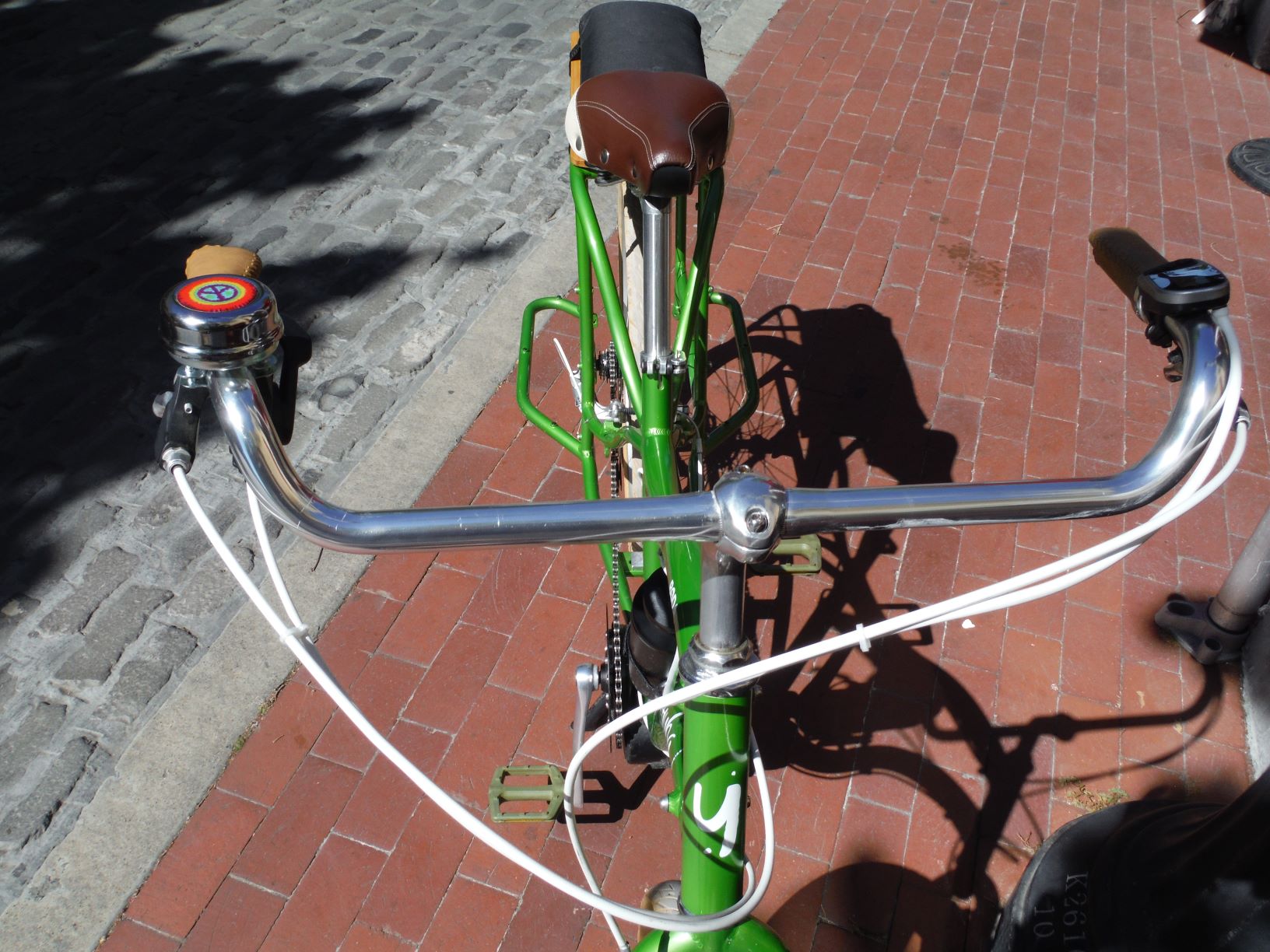

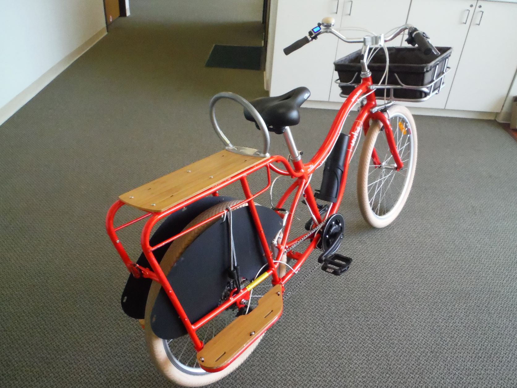

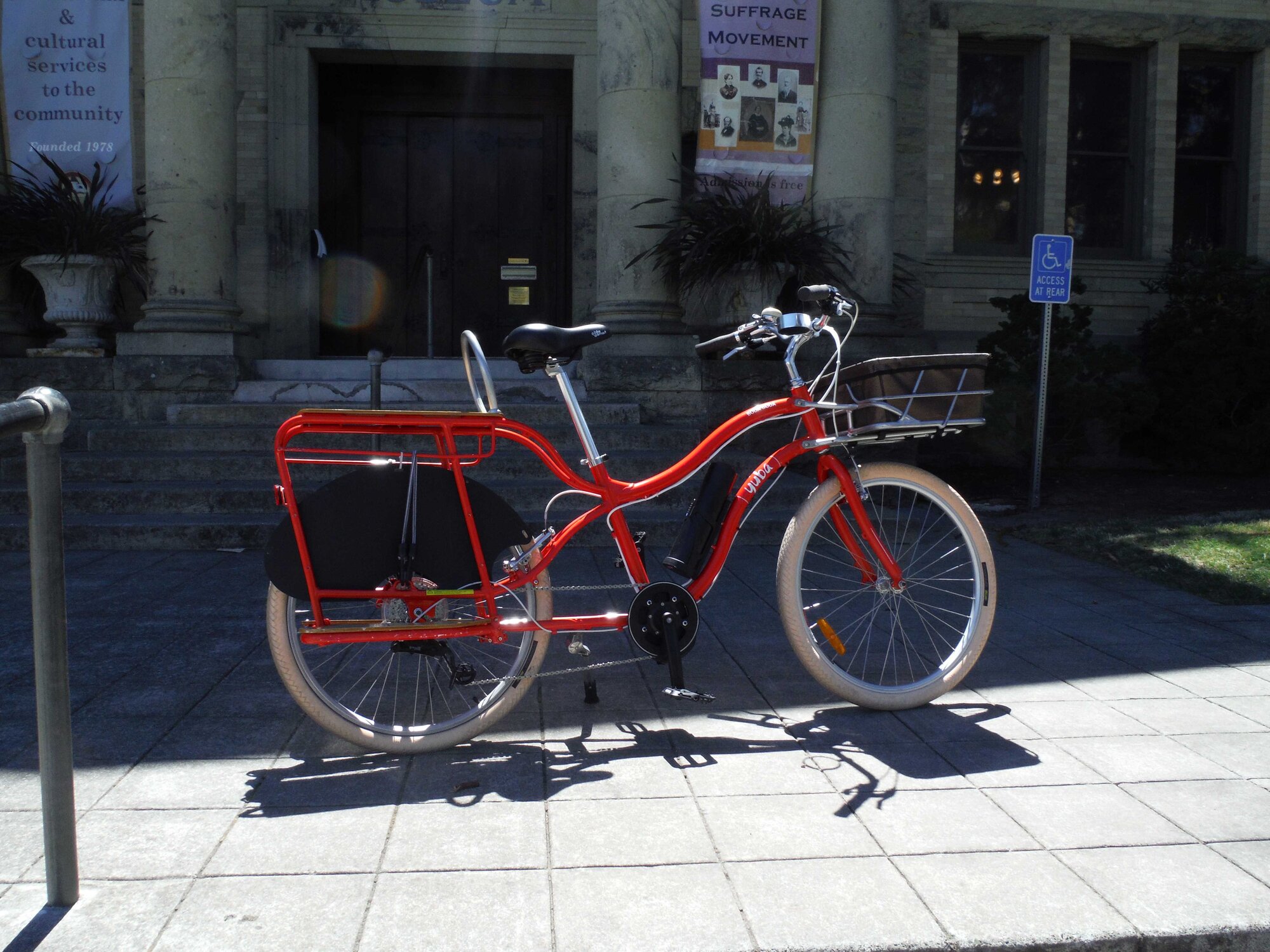

I have a $650 Yuba Boda Boda from Craigslist I will convert. These will hold 220 pounds on the rear rack and about 100 pounds in the front rack. I have converted a bunch of cargo bikes including two Boda Bodas so far. The Boda has a lightweight aluminum frame, a low step and a curvy shape. Just chop off any ugly wires and connectors and you will be fine. The motor fits between the pedals.

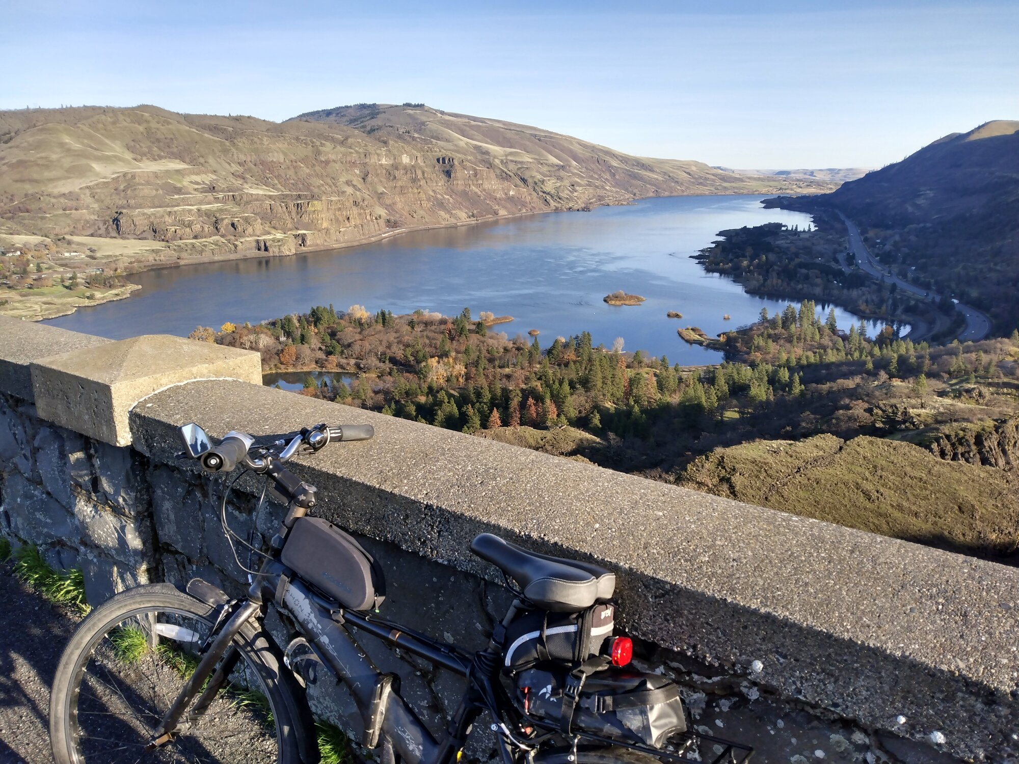

Yesterday I went for a ride with my wife. I could have ridden a Yamaha PW-SE mid drive road/gravel bike (which I like a lot) but as usual I preferred a tongsheng converted bike. I rode without a battery for 10 miles while my wife used it very generously on a hilly route then I took the battery and rode another 25 miles on an even more hilly ride. The (notoriously inaccurate) battery charge indicator bars still show half charge left in the battery. I've ridden well over 40 miles using this 36v 10ah battery and still had significant charge left - so in my use high capacity, heavy, expensive batteries aren't necessary or desirable.
Here is a picture on yesterday's ride. Up and down hills including to near the level of the river. The motor assists up to 28mph but much above 20mph it takes significantly more effort but is still helpful. Just something to maybe consider in your search.

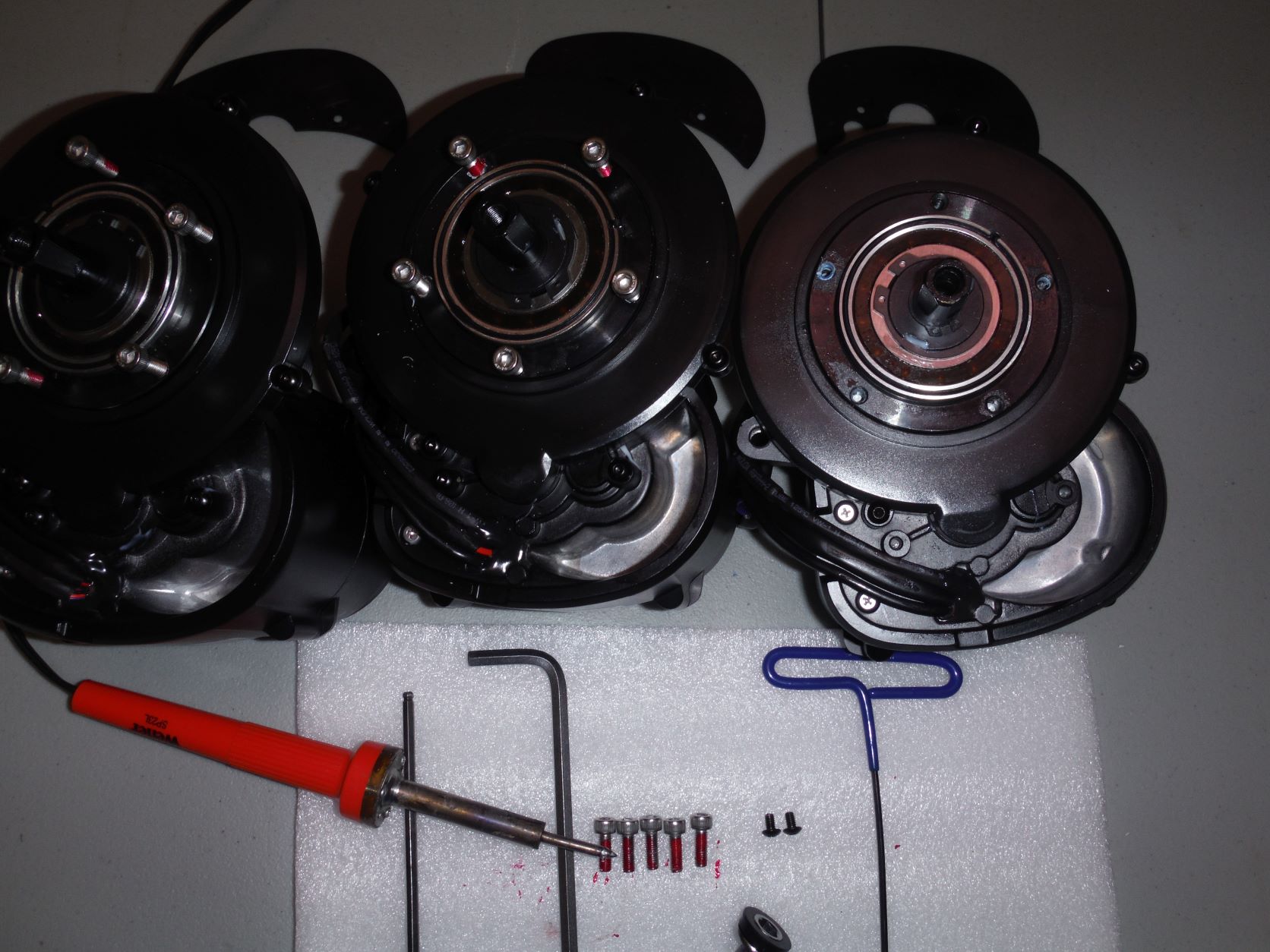

I have found a big difference between the eight-pin and the six-pin. Today I need to convert three motors from eight to six pin by soldering. First I need to trace and map the wires because of a color change I do not have a handle on yet. Levers, a throttle, and a speed sensor will each kill performance. I hope these motors turn out to be okay. I also use 48V, 750W but only six-pin with no speed sensor. I ordered these motors from a new supplier who said they were six-pin but instead sent a giant wire harness converter with them. I rode one bike for a year without a speed sensor because it didn't fit the chain stay. Then one day I figured out a workaround and installed it. That eviscorated the feel of that bike. And immediately I chopped it off. Ahh, so much better.
