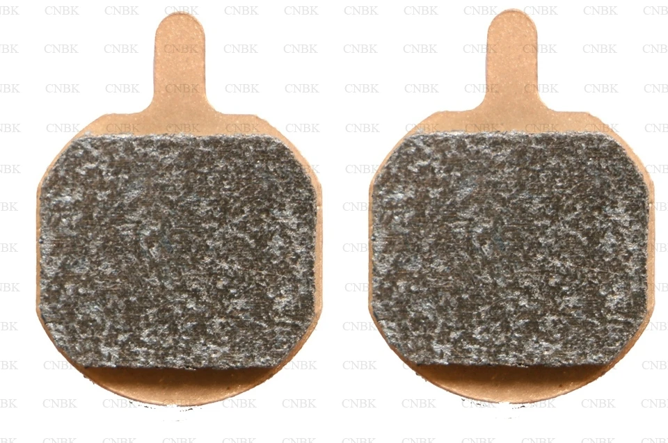

And it said PH02, which is this.
Free shipping Made in Taiwan BENGAL disc brake pads for SHIMANO TEKTRO AVID BENGAL  disc brake|padded hips|brake pad brandsbrake pads suzuki - AliExpress
So I went on AliExpress and found compatible pads, only took me a few seconds

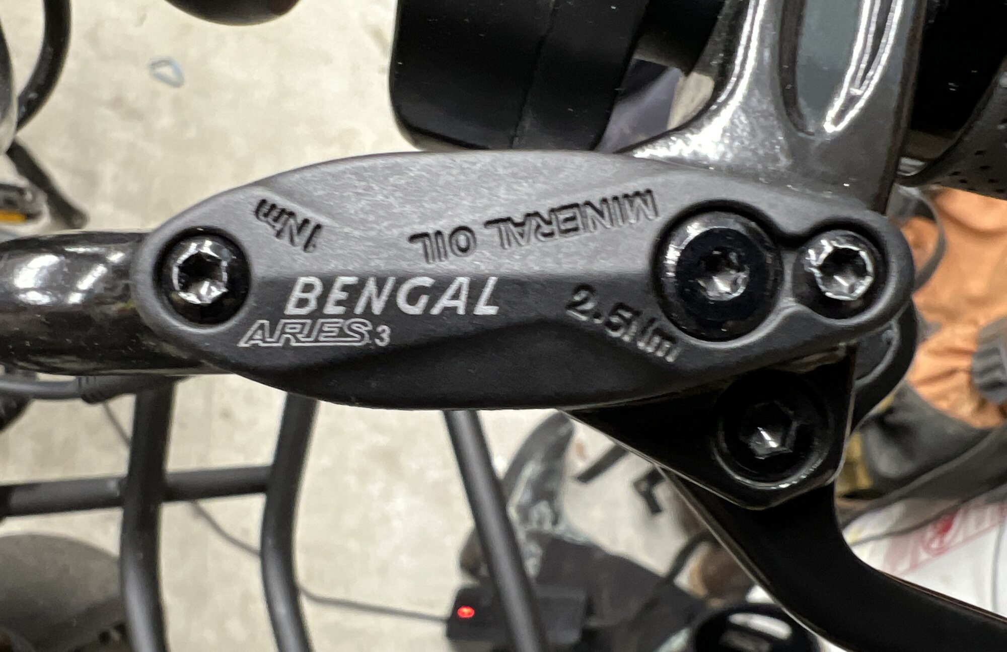

The Level and the Aventure both use the same braking system (Bengal Ares 3), and thus, the same pads. The AliExpress pads linked above will not work for the Ares 3 brake caliper because it requires spring clips and the small channels on the pads for these clips. That channel can been seen on the product picture on the Aventon webstore. Without the channel and clips, one would have to rely on magnetic calipers to hold the pads from flopping around and wearing unevenly. The Ares 3 calipers are not magnetic - sadly...
I was actually able to get three sets of pads from Aventon when they became briefly available a month or so ago. Even with a change of pads, I still find the Ares 3 brakes to be grainy and sometimes loud, but they seem to wear very slightly, and they stop the bike well, so I deal with it. At some point in the near future, Aventon will have plenty of pads available, but if one absolutely needed to change them today - or be unable to ride - the only choices would be to wait, or replace them with a more mainstream brand of brake - like Shimano or the like.
Sorry I'm a bit confused.
You said those AliExpress pads won't work because it requires spring clips.
So are you saying that spring clips need to be included?
As you can see, I posted the picture of Bengal PH02, and even that goesn't come with the clips.
The clips are just not shown in the pics, but those OEM Bengal pads come with them included, and you can see the channel in the pad for the clip. I think Bengal went out on their own designing and manufacturing these pads, and because they seem to be a small player in the world of bike components, there are no proper 3rd party options as of yet.

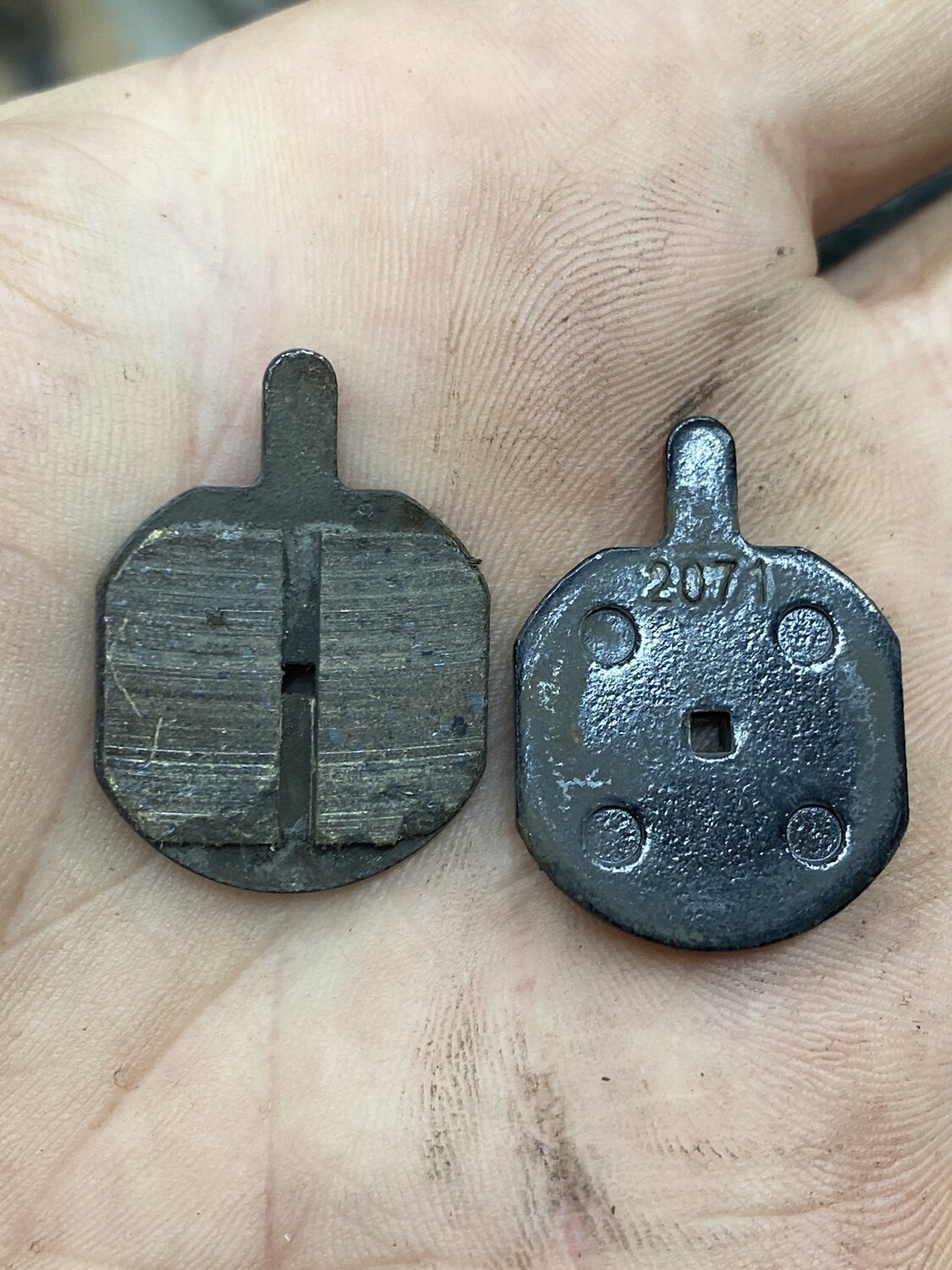

My turn to come to the table. I’m closing in on 1000 miles on my Aventure. I’m mainly riding gravel tails with lots of hills so I’m on my brakes all the time.
Having a really hard time finding new brake pads. I see the picture above
Of the new brakes. They look really close to mine. Does anybody have a link so I can buy several sets? I’ll post my type Thanks!

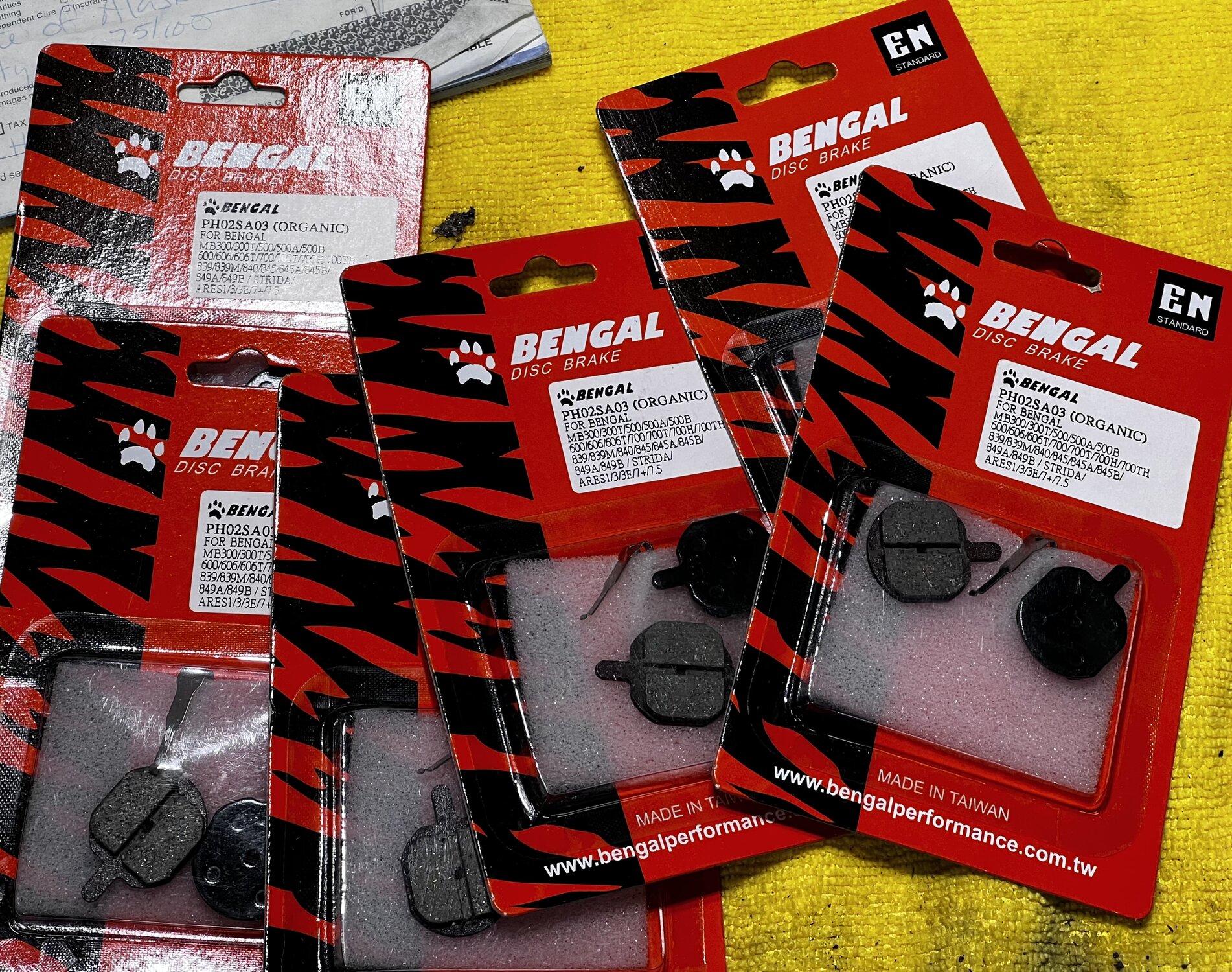

I Found brake pads for ares 3 brake. #PH02SA03
Avenue Cyclery. 415-387-3155. Just got them in Wednesday. I bought several pair extra. They’ve been on back order 5 months. Get extra
