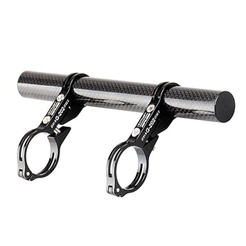

If you want to ruin that Kingfield, some owners have adapted the Bafang to belt drive, but it must be a lot of problems getting the hub/motor to line up, plus some machine work is probably needed. I wonder if that multi-speed hub might explode with 3X the torque coming into it. You can buy one of those handlebar extenders and put the controls there. Although the throttle will be in the wrong place, if you rarely use it. no worries.

It seems that most controls that im seeing dont fit on drop bars for example.
I use the Grin Handlebobs for mounting accessories like the throttle on the right hood and also a regen momentary switch button and a bell on the left hood. They fall easily to your hands in these places and you can still use the brake levers while controlling either of them at the same time.
