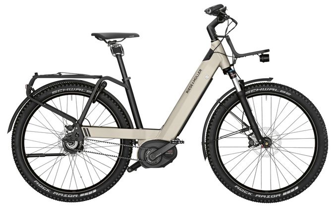

I suspect you will find a good fit in the Riese & Muller Nevo GH Vario It has a continuously variable Internal hub, Gate carbon fiber belt drive a deep step through with a very solid, no wobble frame and comes in three sizes. It is a very easy bike to mount. Riese & Muller bikes are at the top end both in terms of cost and quality. For your kind of riding I suspect you will find the Nuvinci/Vario very convenient, and comfortable. The Nuvinci/Vario combined with the belt drive make for a very low maintenance and clean drive train. At 6'1" and a 32 " inseam, I rode one and the seat was only about two inches above the seat tube with at least another 8 inches of seat height available.

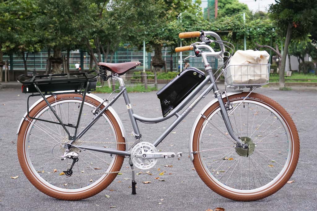

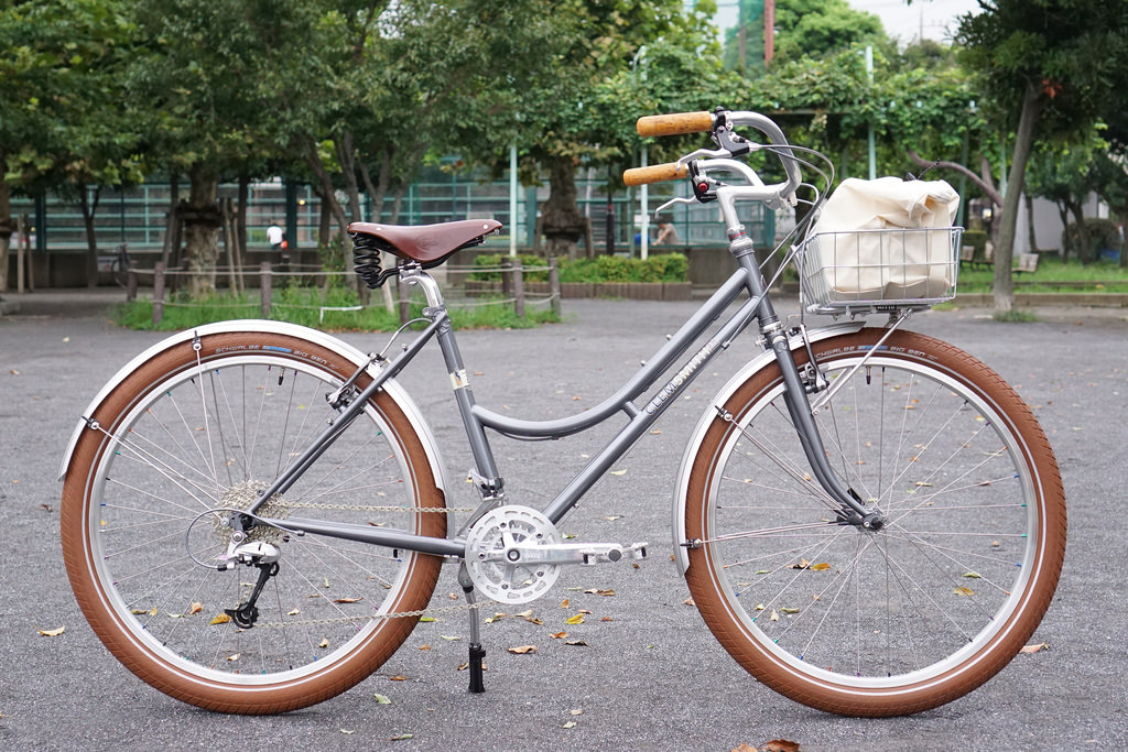

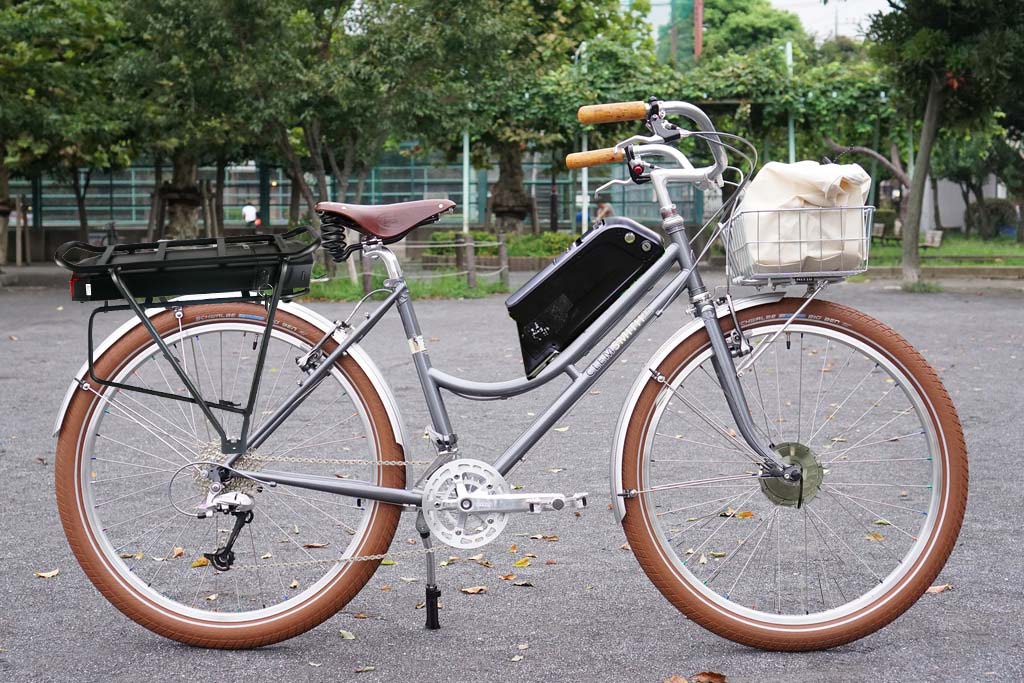

I photoshopped a frame battery and a rack battery onto a Clem. The frame is curved and may not have enough length for a downtube battery, but a rack would fit and is better if the frame battery restricts mounting the bike. For your described riding needs, a small geared hubmotor would work. It would be safer on the back, but it's in front for illustration. I converted several bikes like this. No concerns about setting off on a 25 mile ride in strange place with them. They ride as well as the original bike before the motor, and rim brakes are entirely adequate for speeds under 20 mph. A small geared motor is 5-8 pounds. A battery is 6-8 pounds for a 10-12 AH unit. That's all that a bike for your purposes will need, and you can go 25 miles at 14 mph on a nice day in flat ground. At these speeds, there's no concern about the weight of a rack battery affecting handling either.
I would apply these comments to any commercial bike you might consider. Get a bike that fits. A step thru is likely even better. Test ride a few with cadence and torque sensor to see if how you like them.
If lower lever power/battery will meet your needs, why spend for range you wouldn't use.
The biggest obstacle to converting a bike is technical ability, Not an issue with indianjo and myself, but I appreciate where others come from. One can certainly save a lot of money doing so. A battery is $500-600. Motor kits are $250. Knowing how to solder, check voltages, well that takes time. I learned it in high school.
View attachment 30683 View attachment 30684

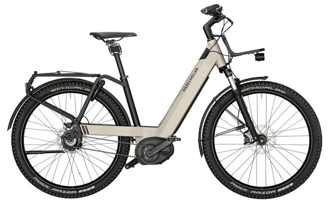

You can save a bunch by opting for a 2018 Demo version of the same bike. The differences are no front rack and it used the older style battery that is not integrated into the down tube. (Link Removed - No Longer Exists)
View attachment 30686View attachment 30687
