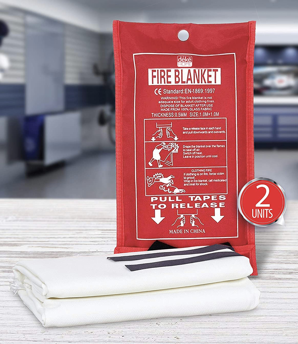

Wow...you were lucky that you were there, outside, and had quick access to a hose. Imagine this happening in your house/garage near flammable items. This is why I’m getting this kind of fire blanket for general storage. Won’t prevent a fire but might contain it. A larger ammo box would be even better.
