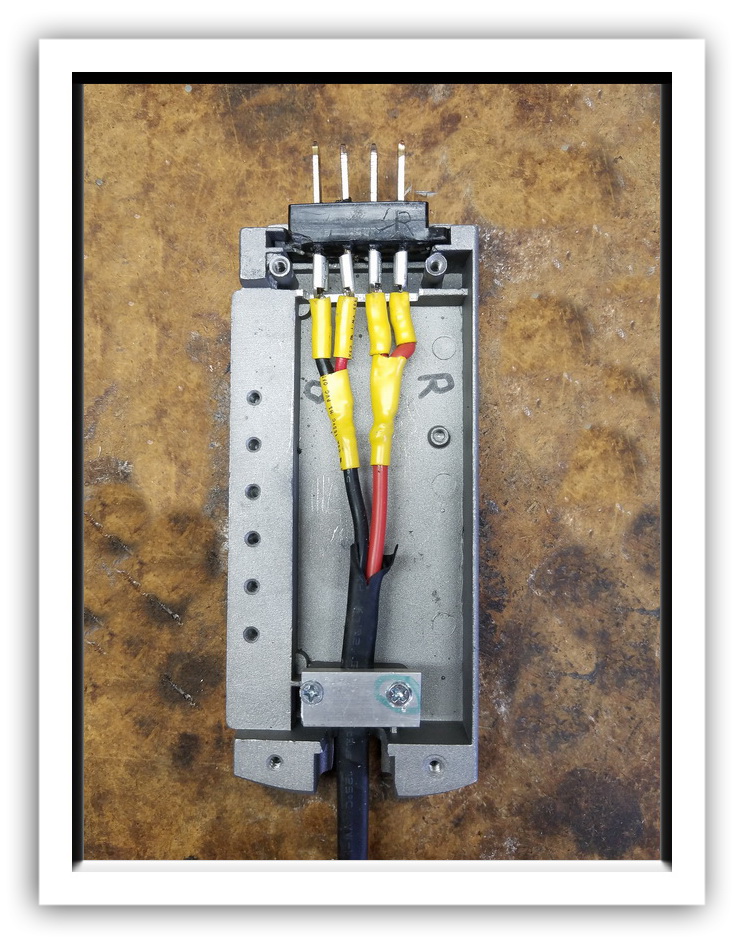

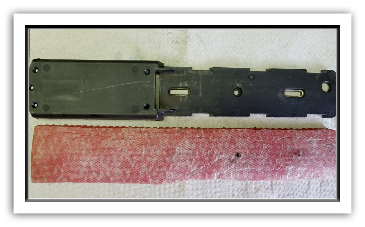

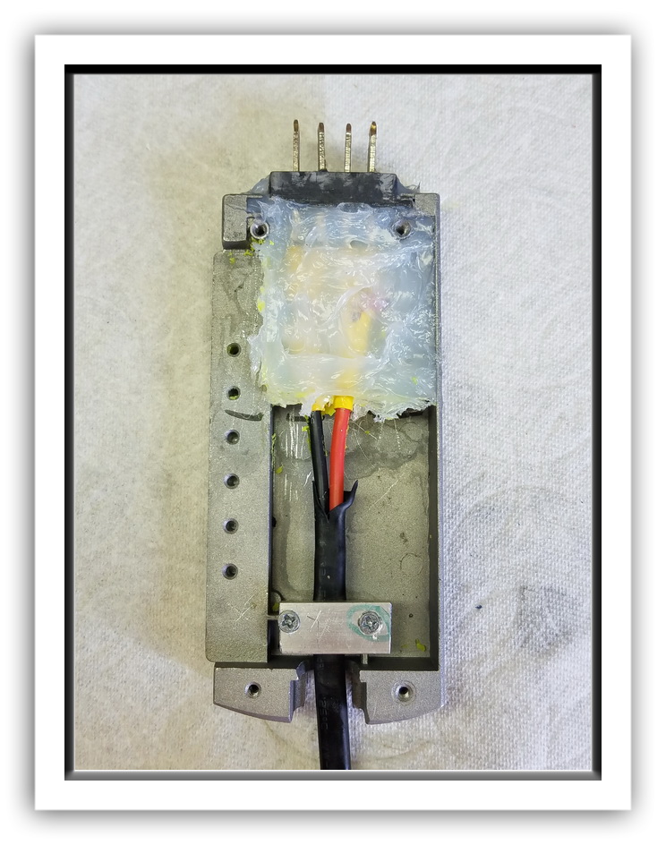

Thomas, you hit on it! Shortly after my original post, I rode my e-bike 'till it totally lost power. I, therefore, tested the battery. No power whatsoever. The problem was p__s poor design of the solder joints inside the battery bracket (Bafang Ultra Slim 48V 11.6 Ah with Panasonic Cells). I had resoldered previously, but road vibrations rendered that fix also a failure. I repaired again; except, this time I have mechanical connections (to avoid melting the plastic plug) to the four inside prongs of the electrical plug, followed with dielectric silicone RTV potting to ensure nothing can move inside the bracket. I have documented the repair here with photos, should anyone else experience my battery bracket failure. Thanks so much for your reply, which is the only reply I've gotten.
By the way, I purchased the Play-Doh from the Dollar Store ($1.00, used to dam the silicon RTV); the electronic grade Silicon RTV for potting was purchased from Amazon (~$10.00). The electrical connectors were from the Home Depot. The padding (excess rubber carpet padding) goes under the the bracket. After a test ride: Quiet and as smooth as silk!
