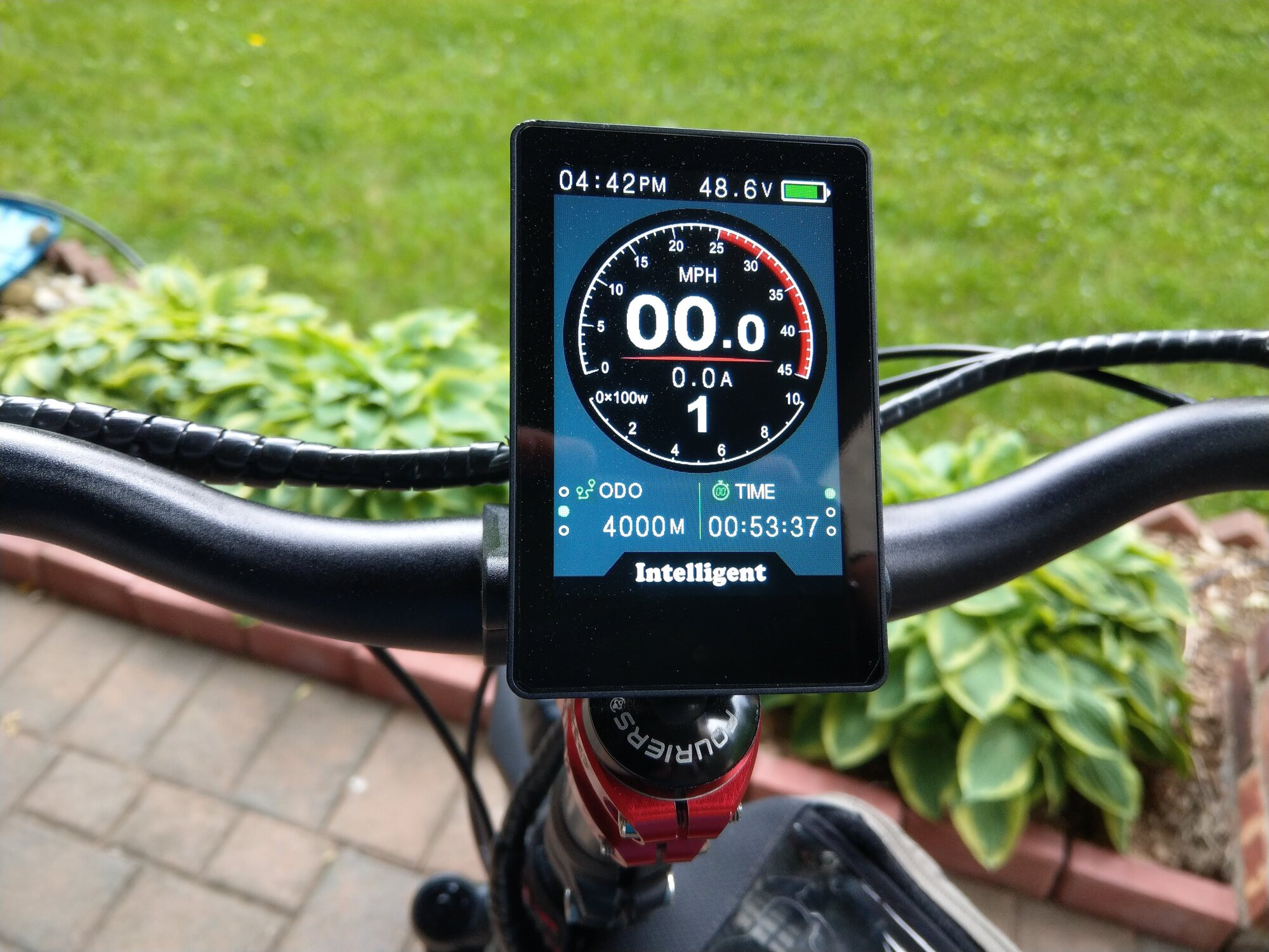

If it interest you that much, you may want to upgrade your display.
Me personally, I really like the 860c which is very easy to read in all light conditions and has the buttons detached for placement near the end of the bar.

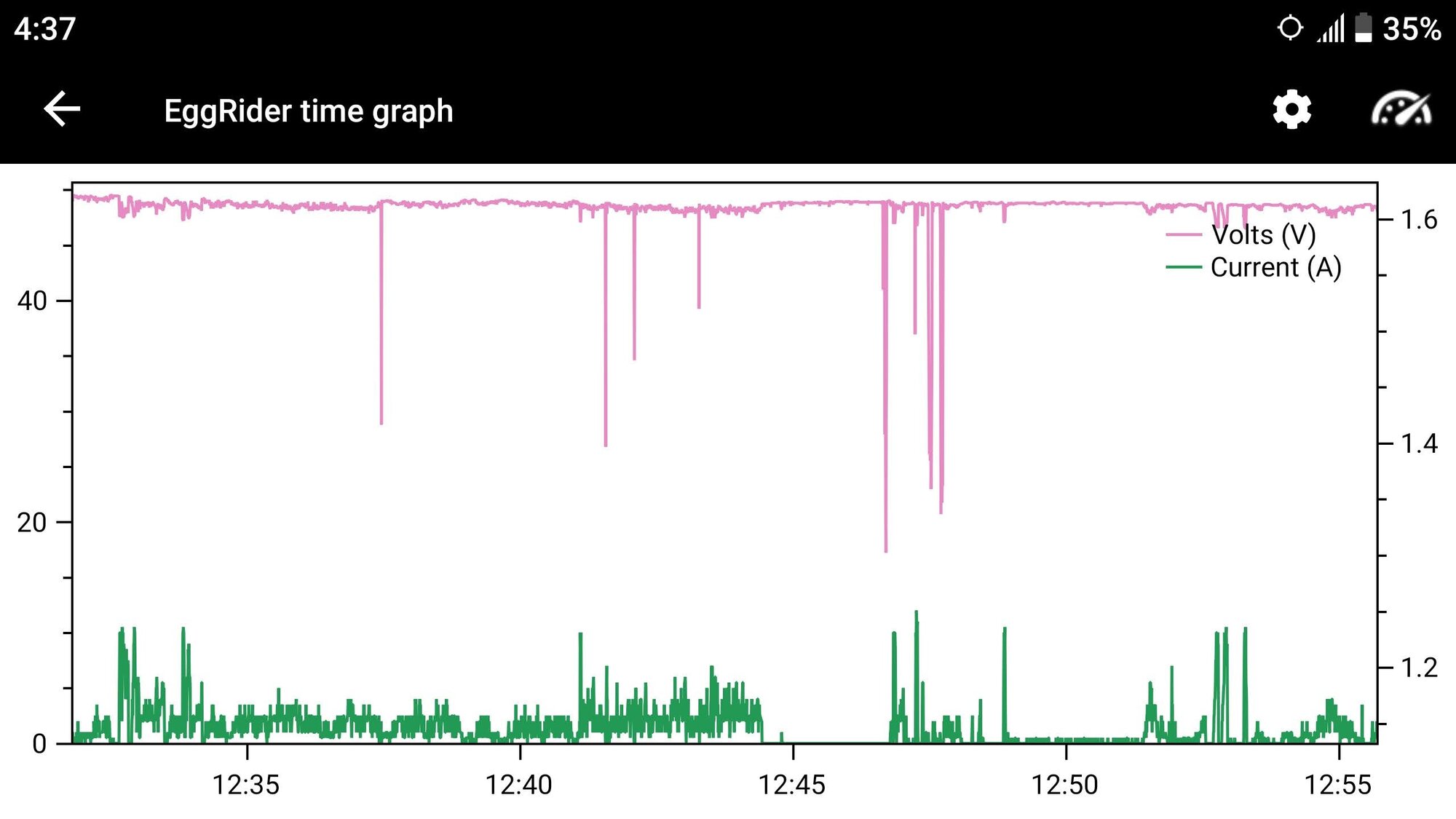

You could also try something like the Eggrider that will datalog... But I find it very difficult to read while riding and the buttons poorly placed. But it was great for some initial setup and troubleshooting.
I would like to upgrade my display but is there a way to input the bike's current millage into the new display? I would like the display to read the actual mile of the bike.
On the 860c and similar... I think not.
I haven't looked into the eggrider enough as I couldn't wait to put the 860c back.
That said my Odometer is about 200 miles off
