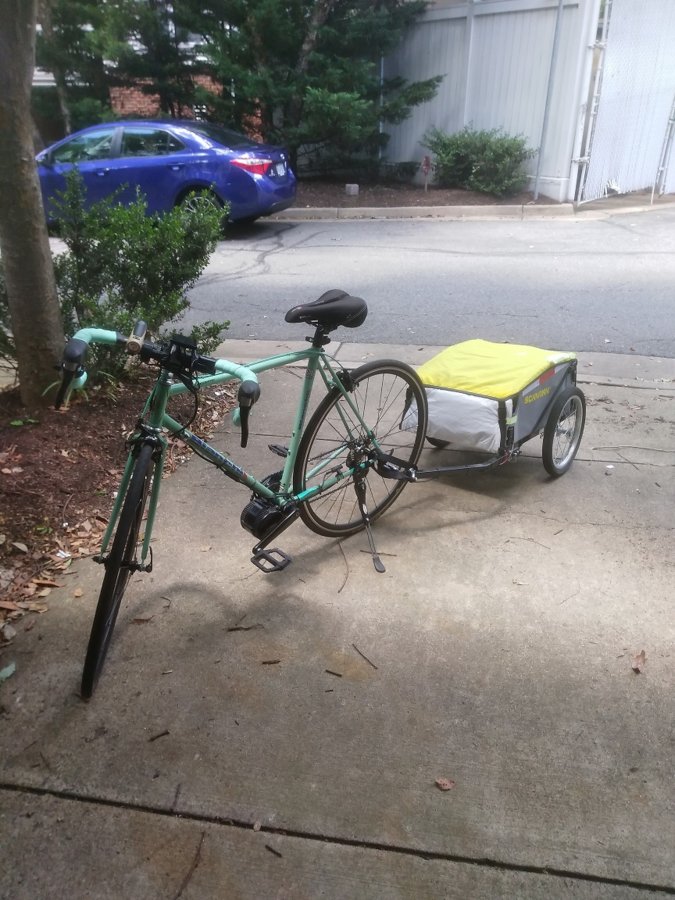

Currently I have a 11.6 ah battery (550 watt) battery that I took from my Radwagon to use on this bike. With the battery being about 3 years old now, I'm only getting about 28 miles total in Eco mode. But on this Bianchi, I'm getting double that range because the bike is so light and I can use less assist when riding.
The kit cost about $450 and the battery varies from $300-$1000 depending on the size (300 wh up to 1400+ wh). Because I'm using an existing battery I saved on the cost.
I've had no problems reaching 32 mph on that bike and that at level 2/5 assist.
I've also moved the battery to the trailer because it allows me to switch different batteries without disconnecting from the bike. It also allows me to add some bottle cages.
The BBS02 makes for a really nice assist! However, the BBS02 is a bicyclists motor. Meaning it needs to be ridden like a bike using gears to shift before stops. Using the motor and throttle to take off from stops without using lower gearing can overheat and create problems with those drives. The BBSHD is heavier but also more forgiving, with speeds up to 32MPH.

Wow. A 43 lb steel frame Bianchi eBike. What's not to like? Well, maybe the brakes, and personally I would go w/ wider tyres just for the safety factor, but otherwise a flawless conversion.
I agree the tires to be wider. I was limited to what the frame could accept. The original tires were 700c x19mm. I was able to get 23mm tires at the bike shop but eventually moved up to 25mm. The widest tire the front can take is 28mm without rubbing up against the forks. The rear being 25 mm. A 28mm in the rear would rub against the frame.
Currently the bike uses Schwalbe Marathon tires, 28mm in the front and 25mm in the rear. These tires very heavy but also extremely durable. I use to have Continental All Season tires but they were too prone to flats.
Since the original post, the drop bar have been replaced with riser bars for a more comfortable ride. The brakes are new Shimano 105s which do a great job of stopping the bike.
I replaced the quick release skewers with hex bolt skewers because the rear torque was causing the rear wheel to slightly turn to the left. It also more convenient. I no longer need to loop my wheels when locking to a tree.
