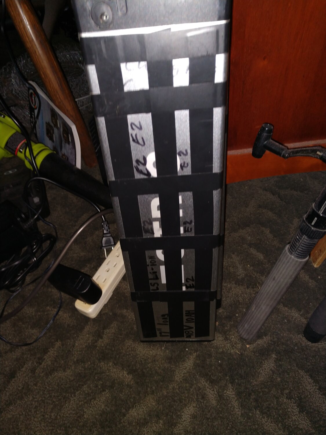

My latest and so far easiest fix was to wrap some duct tape around the battery.
I tried this on my battery and then the battery wouldn't go in the frame and peeled off the tape.. But whatever works is the solution.
I first put on too much tape, then took layers off until the battery slid in nice and tight without removing the tape. So far so good and it's easy to renew if there ever is a problem.
