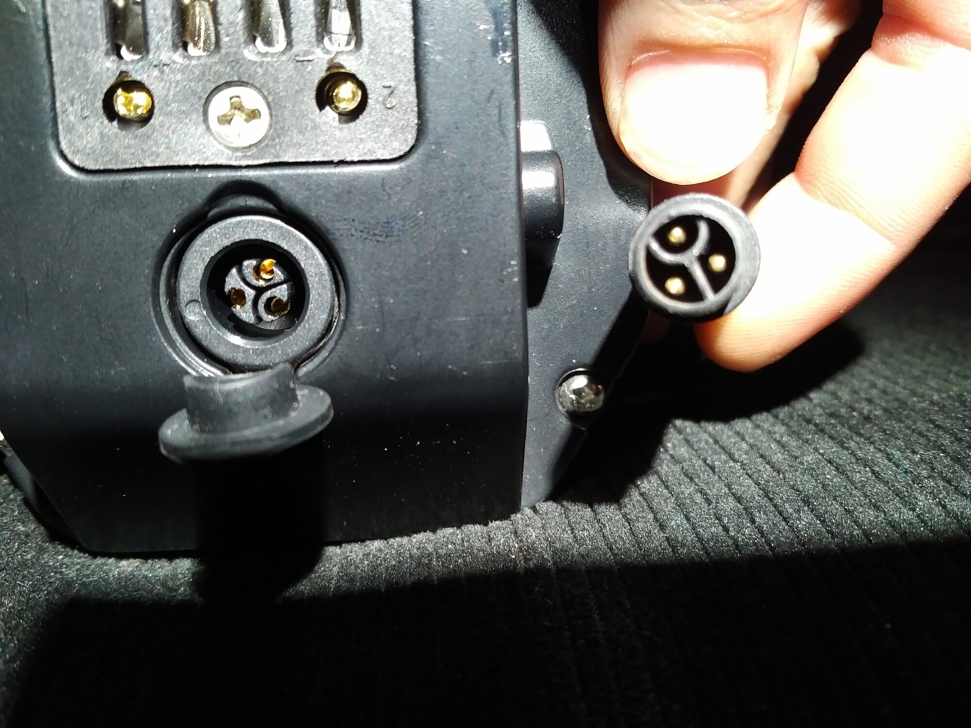

I have been exclusively charging my battery through the frame port using a Satiator charger. I had removed the battery and I found that the charger's plug does not mate with the battery's direct charging port. Has anyone else noticed this?
My frame and battery ports are the same. My charger plug looks the same as yours.It seems like the wrong port was put on your battery.

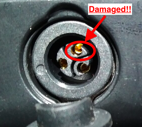

Maybe damaged but definitely the wrong shape. That battery charge port is a Cusmade 1103B when it should be an 1103A
