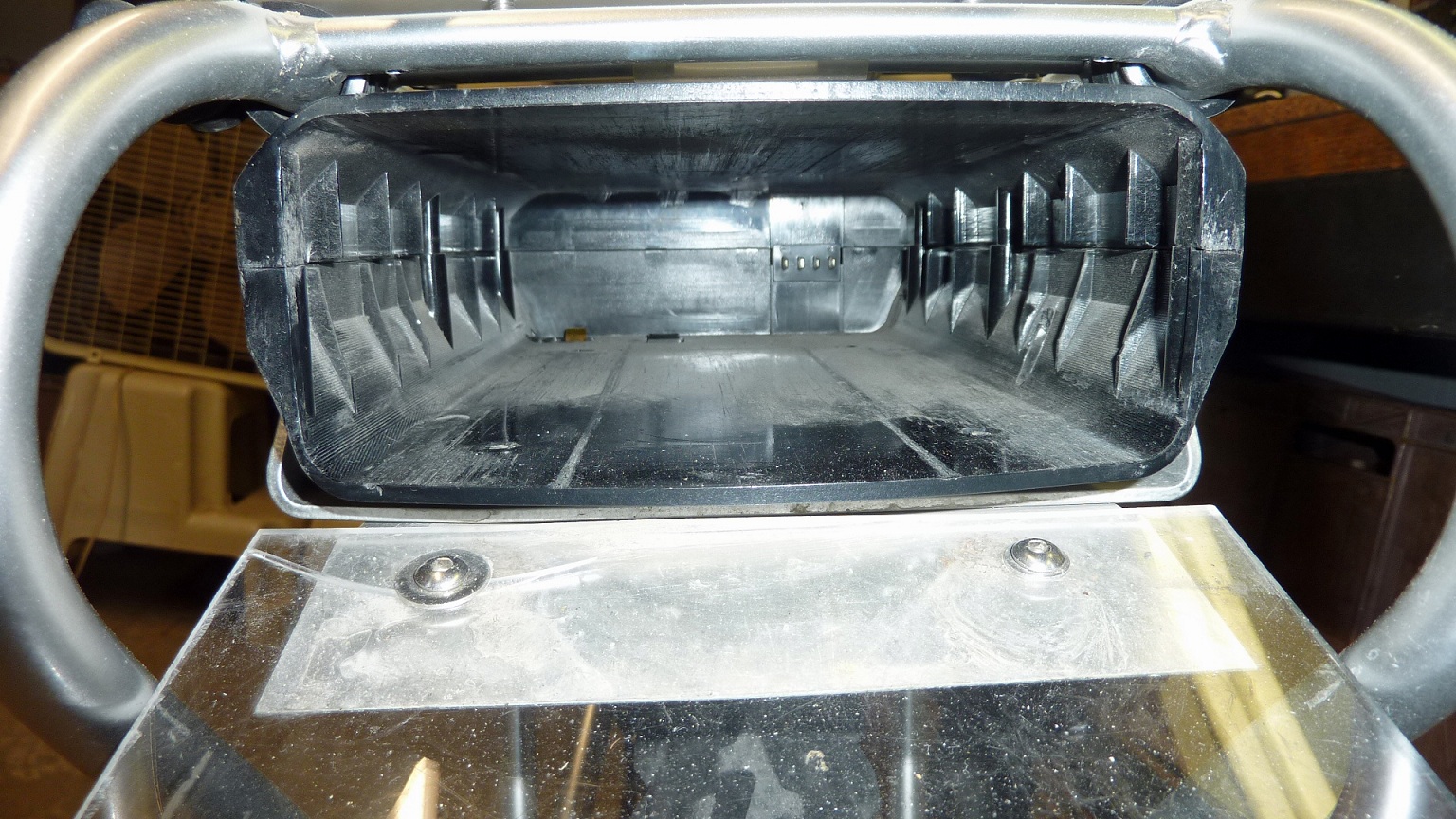

The inside of the Pedego battery sleeve on the Comfort Cruiser, as well as several other models, looks like this:
The battery contacts are located in the rear, above the floor of the sleeve and pretty much out of harms way. Any debris that accumulates inside can easily be cleaned out which is something you should do anyway on a regular basis. If you are really concerned, stuff an empty plastic trash can liner inside far enough where it won't blow out.
I've been transporting my three Pedego's on an open rack for 3 seasons now, over several thousand miles and have had no issues.

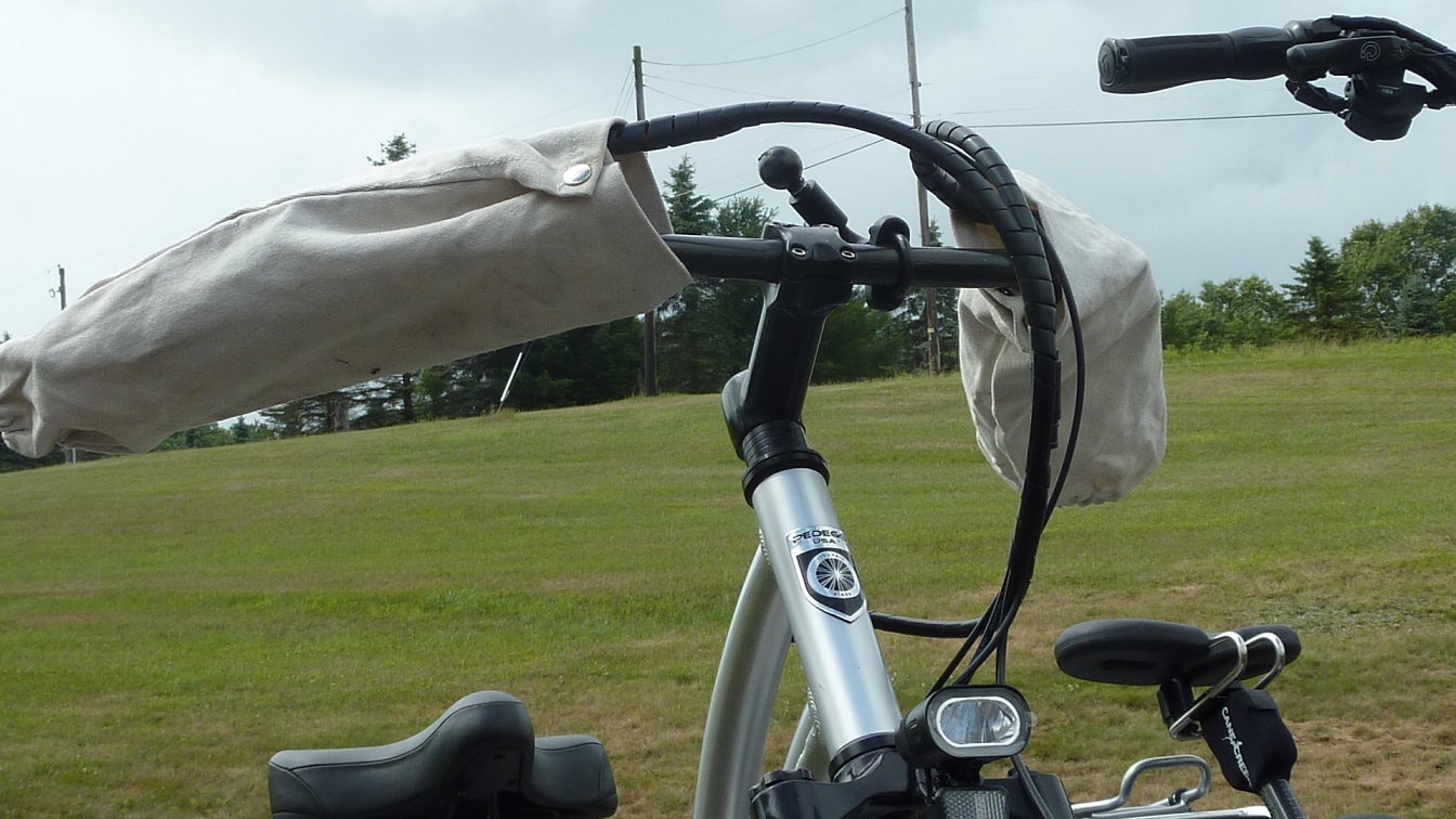

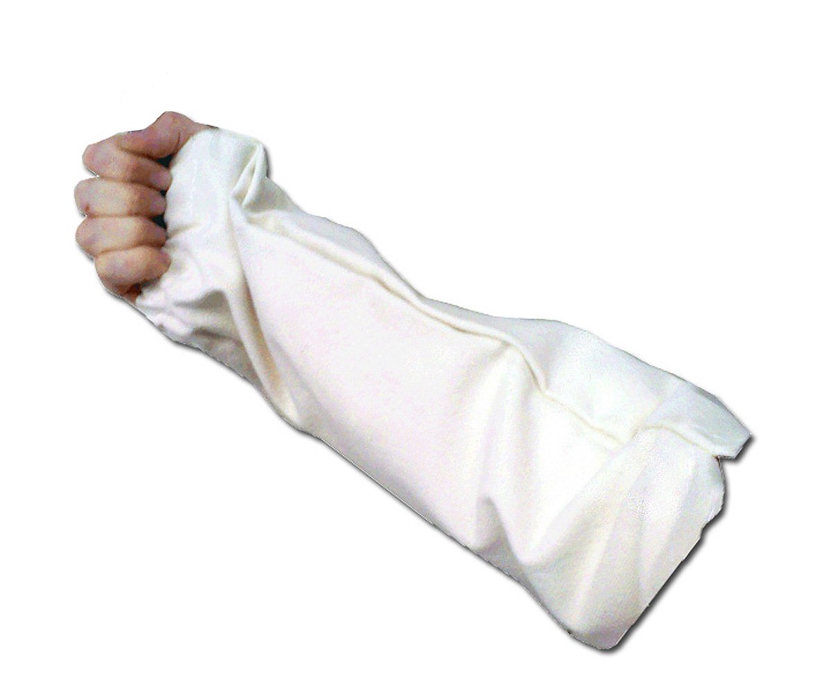

I do use these heavy, snap on canvas sleeves to protect the handlebar ends:

I tried several types of tie on nylon protectors but they all shredded over time from flapping in the wind. The heavy canvas holds up much better.

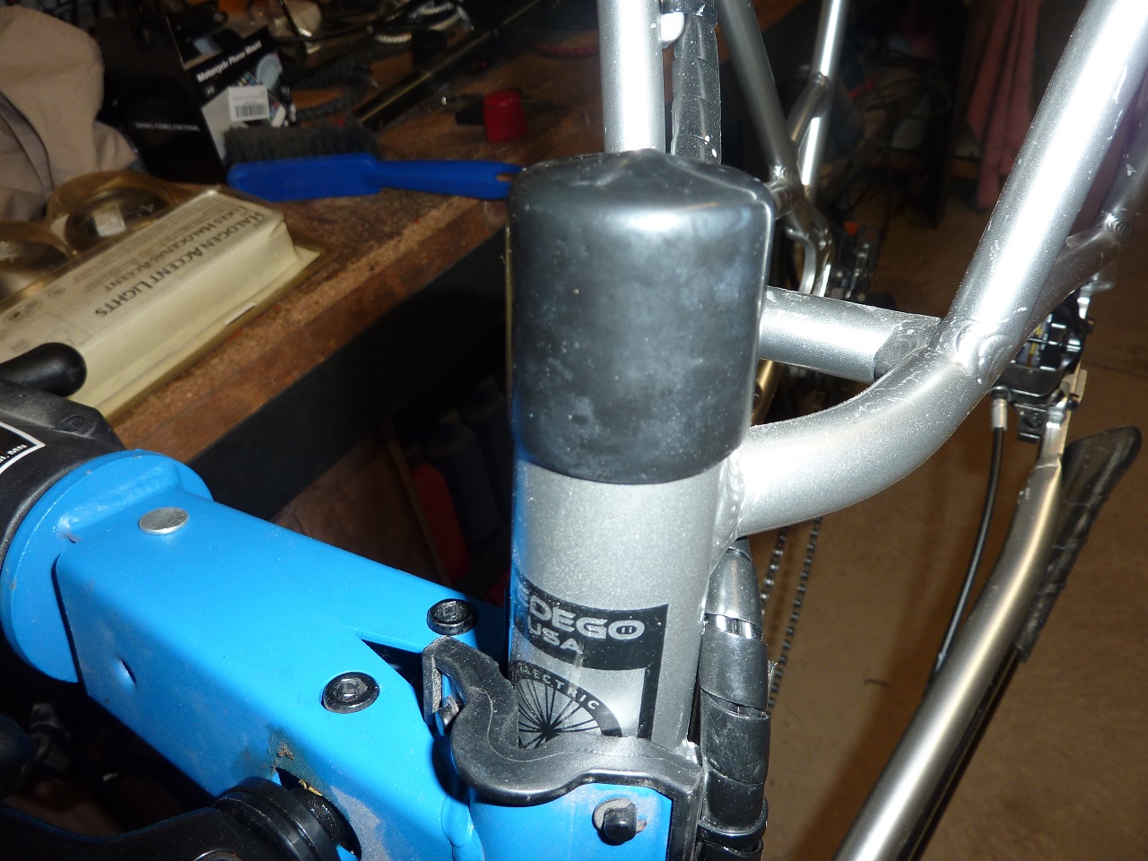

I also remove the seatpost from the bike when transporting to reduce weight and prevent theft. On some bikes, including the Pedego, the seat tube is open to the bottom bracket and dirt & moisture, entering through the open seat tube, can get into the BB and foul the bearings. To prevent this, I put a snug fitting vinyl cap over the open seat tube.
Where did you get the canvas sleeves and how do you keep them from slipping off when the bike is transported on a bike rack? Thanks in advance for more info.
The sleeves are available on Amazon:
They have elastic on one end and a snap closure on the other. In my case, they hold the sleeve in place while on the rack.
If they are too loose, wrap it with a mini bungee cord such as these:
