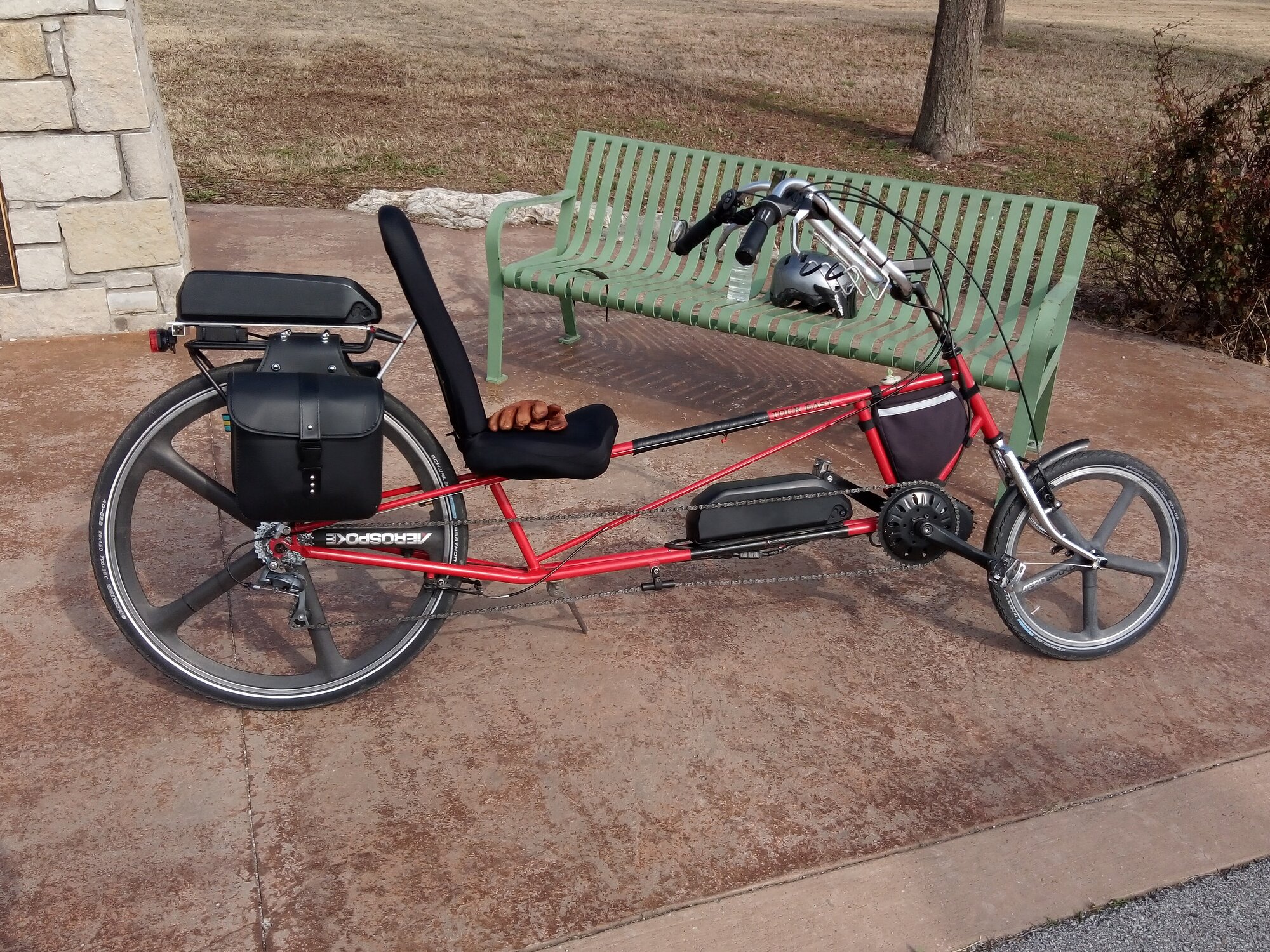

I added a spare battery, went to 8 speed cassette, Aerospoke wheels.

I changed seats, the new seat is from Recycled Recumbents. I was having nerve pain in my hip, now no pain. Odometer just turned over 6,000 miles.
