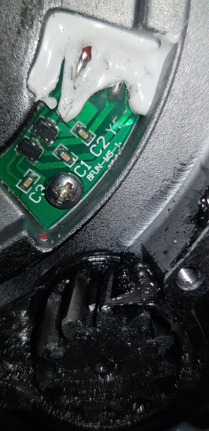

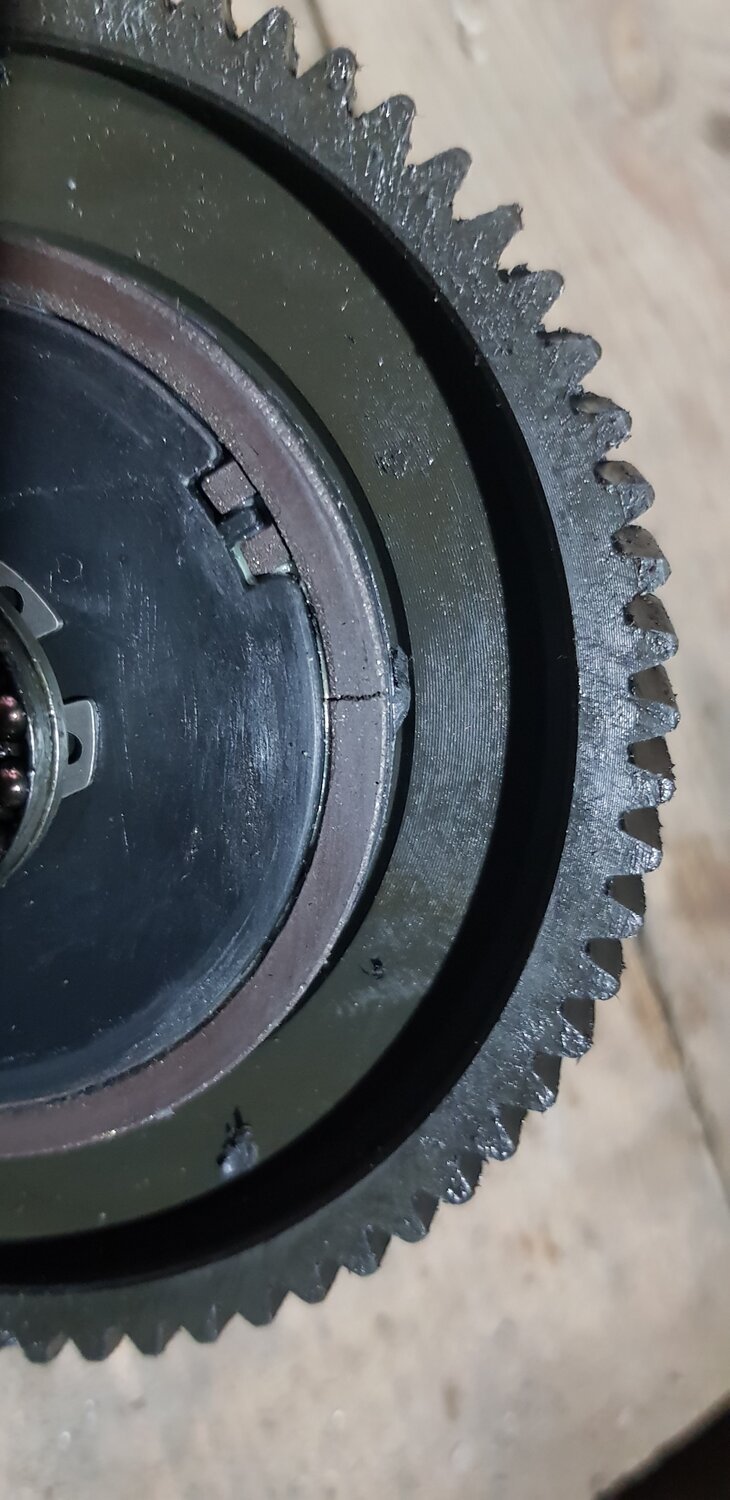

Hello Sedgeway, it seems that I have the same problem since yesterday. When I stop pedaling, motor keeps on running. Same when I throttle, when I stop throttling, motor keeps on running. Motor stops correctly when I'm activating the break sensor. When motor keeps on running, motor speed reacts good on changing the PAS levels, motor speeds change accordingly. Also motor stops when switched to PAS 0. Took of throttle and tested with changed speed sensor, doesn't fix it. Did you solve it with your bike? Can somebody else assist? I'm living on an Caribbean Island, getting over any replacement parts is very time consuming if even possible at date. Any tips welcome, thanks in advance!
I swapped the motor out with another BBSO2 from another bike yesterday. Combination works fine again. So probably it's something in the motor itself. Controller or sensor or something. Ideas very welcome!
Just to be complete, or for those who have the same problem, it was a broken PAS magnet ring that caused the problem. See pics below. Breaking of the magnet ring was (maybe) caused by a ball of the bearing coming in between the main cog and the magnet ring, see pics, they speak for their selves. Suggestions welcome to find a supplier who ships to Curacao, Caribbean.

Naprawiłeś tę usterkę? bo mam to samo i nie wiem czy rozbierać czy szukać teraz programowo.
Tak to dla mnie wygląda. Czy może powstać przed powstaniem?
