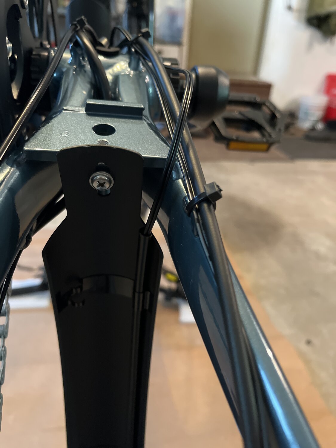

The level 2 came with a rear fender with a brake light integrated in and theres a wire that runs under the fender into the bottom of the frame with the rest of the wires and lines. Do you know how to eliminate that wire?
Best way is to unplug it from the controller and pull it through the bottom gasket.
