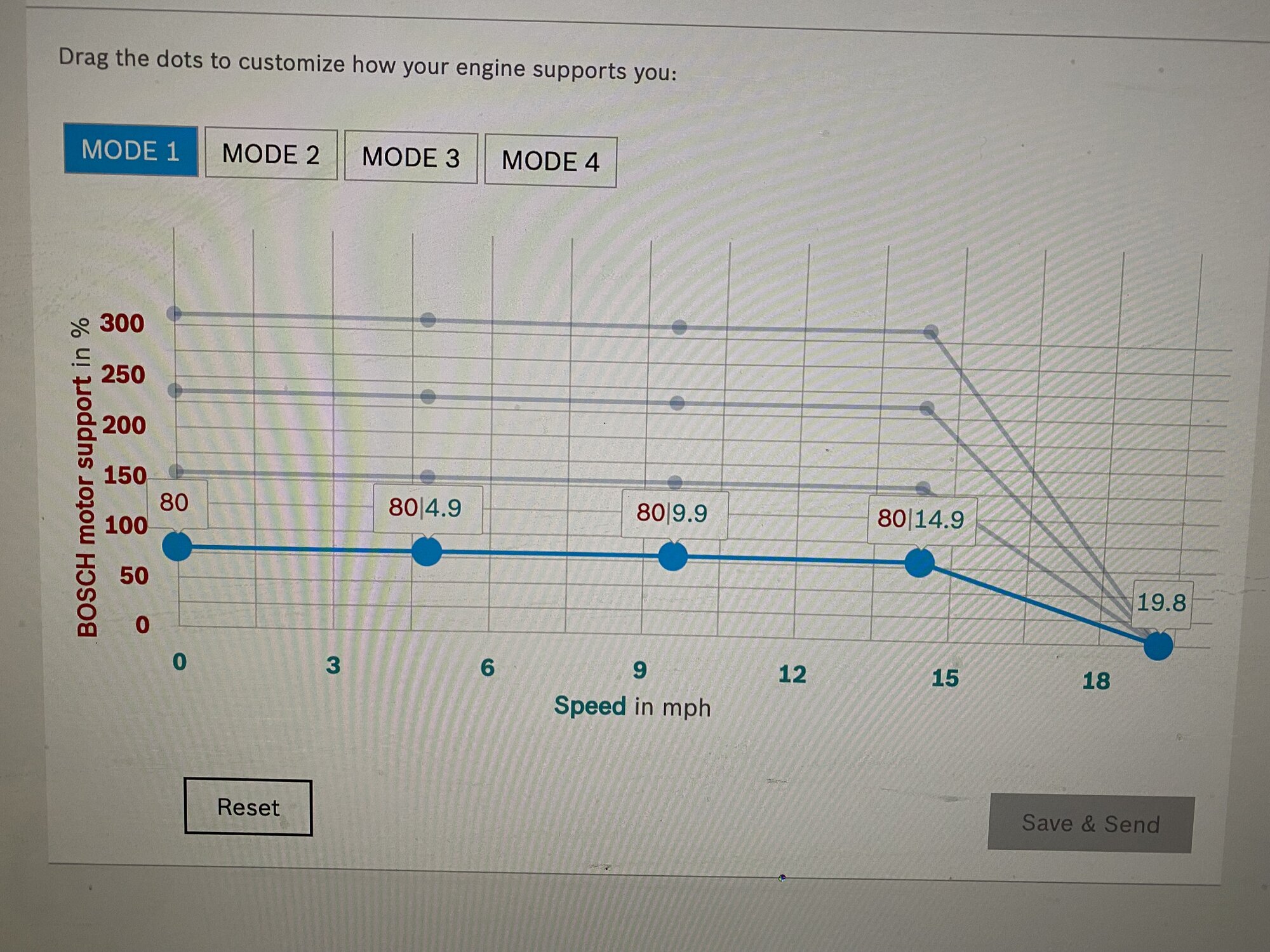

this is about it. some of the new ones I think go to 350% then if you have a nyon you can customize them. if this was a speed motor you would see the drop-off at 19mph
Does MODE 1 - 4 in the diagram correspond to the assistance levels ECO/TOUR/SPORT/TURBO
and are these levels the same for all Active Line and Performance Line motors (except CX), of course with different power exertion depending on which motor. And are these levels the same independent of which computer system installed?
