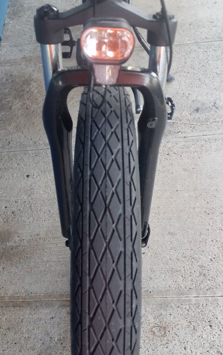

I put a set of the 30TPI wire bead Supercell on my 2018 RadRover before I even rode the bike for the first time. There's also a folding 120TPI version. Got caught in the rain during my first ride to work and they handled great. Super quiet too. The only supplier I could find was BicycleBuys.com. They sell them directly from their website or as a 3rd party on Amazon. The tires and shipping are cheaper from the BicycleBuys website and they shipped it out the next day. I expected them to come completely unfolded as I've experienced with other wire bead tires. No worries though as I easily rubbed out some of the sidewall wrinkles and leaned them up against the wall for a day before mounting. By the way, mounting was a breeze. No tire levers needed except maybe to get your old tires off. PSI range is 10-20 for the wire bead. I keep mine at 18 for commuting on asphalt roadways. I also lockout my suspension fork. Here's a pic of the front tire on my RadRover.

Thanks for the info and pic.
I've been looking for a similar solution as I'll be mainly riding asphalt roads with occasional gravel roads. Are the Supercell tires capable of being run Tubeless??
