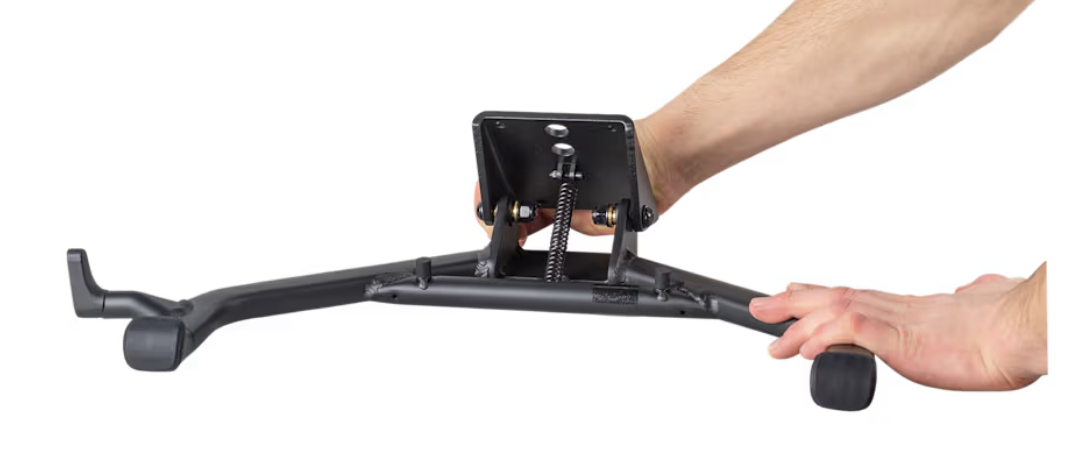

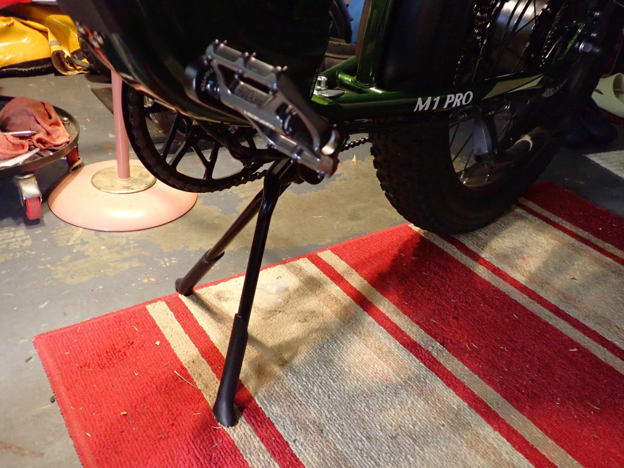

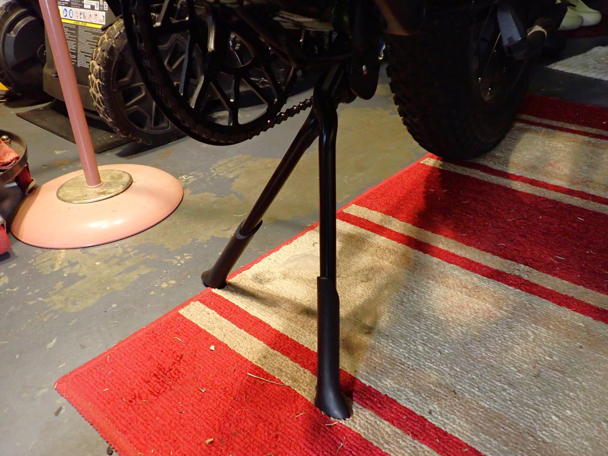

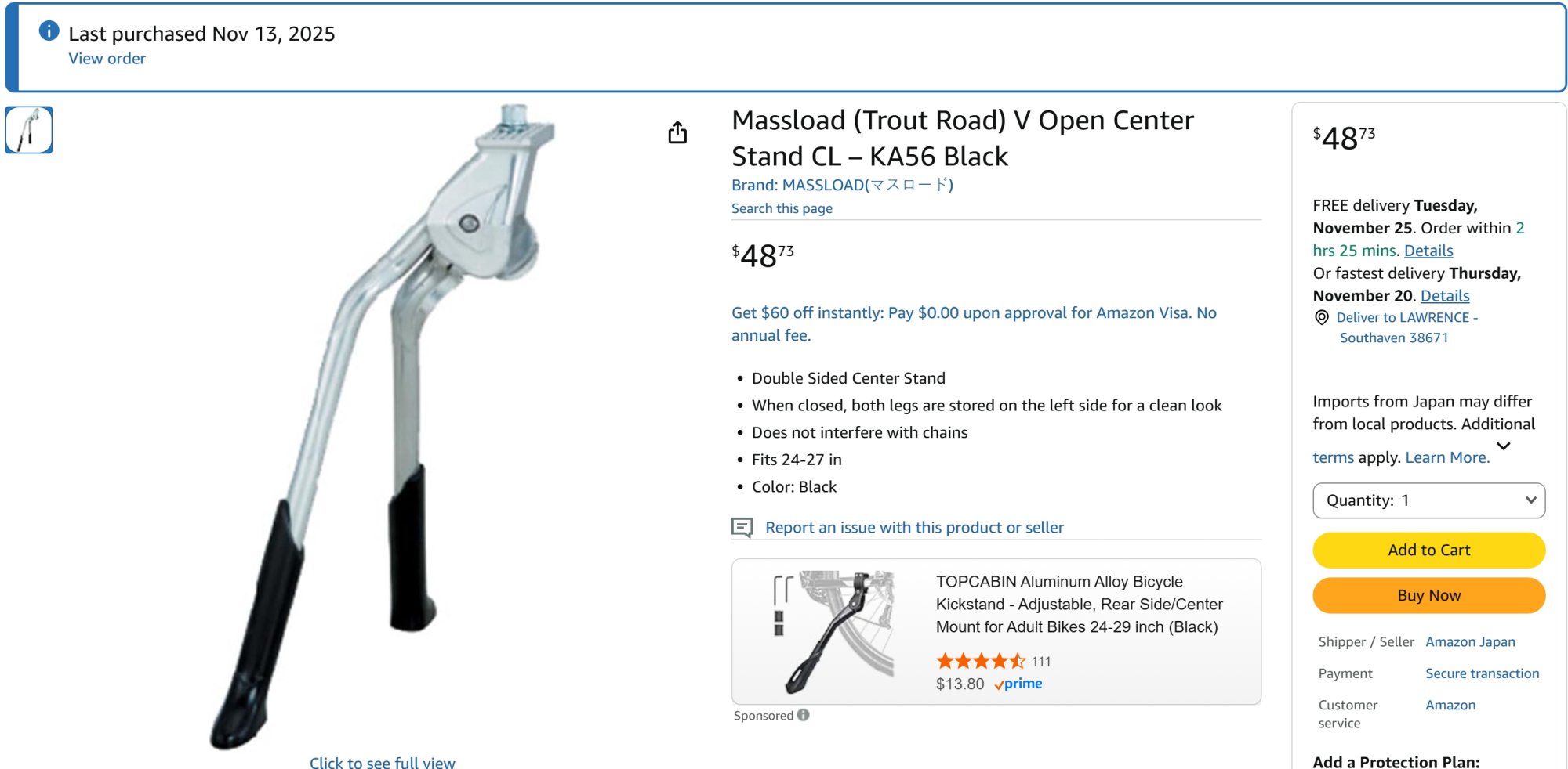

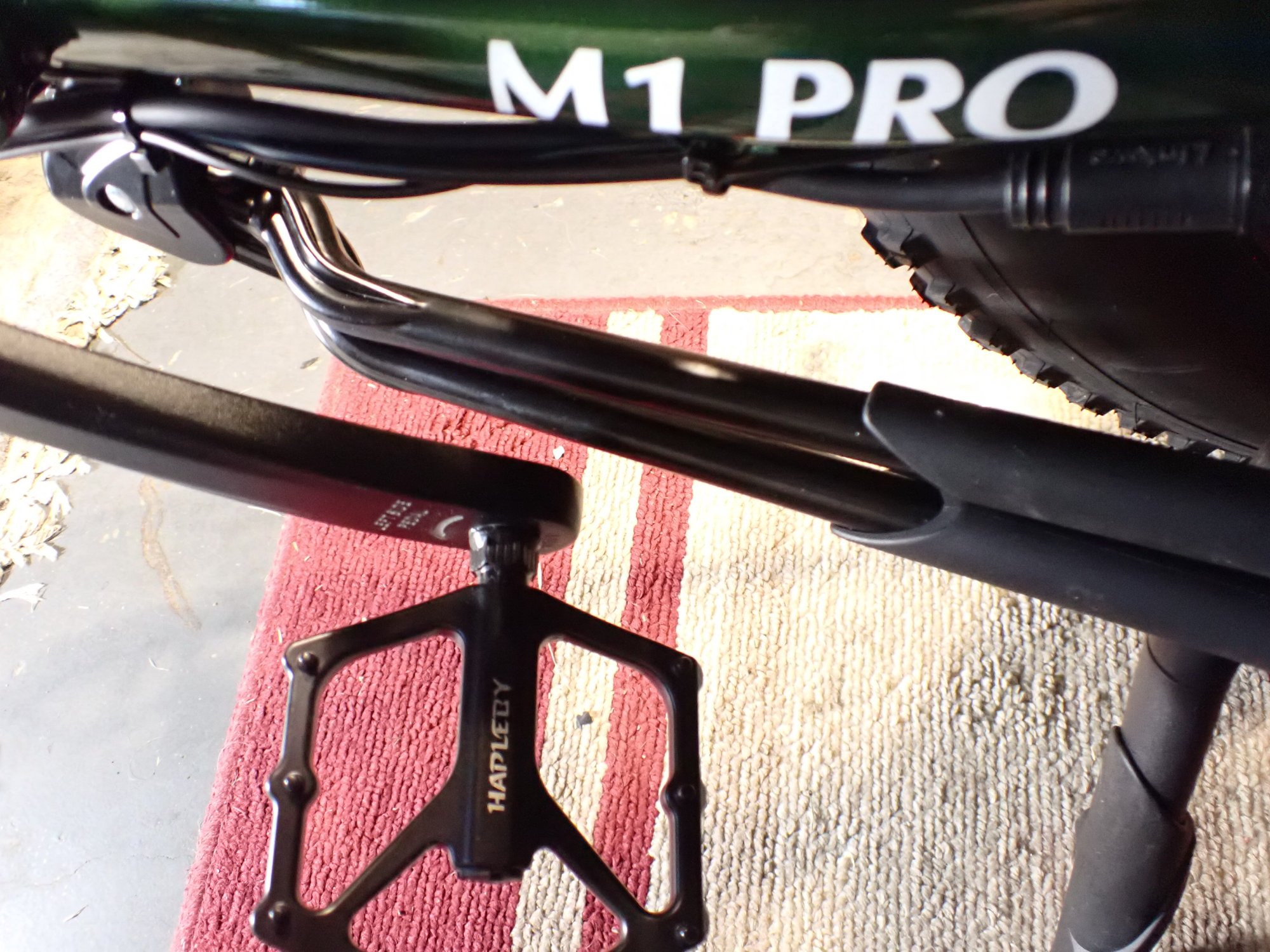

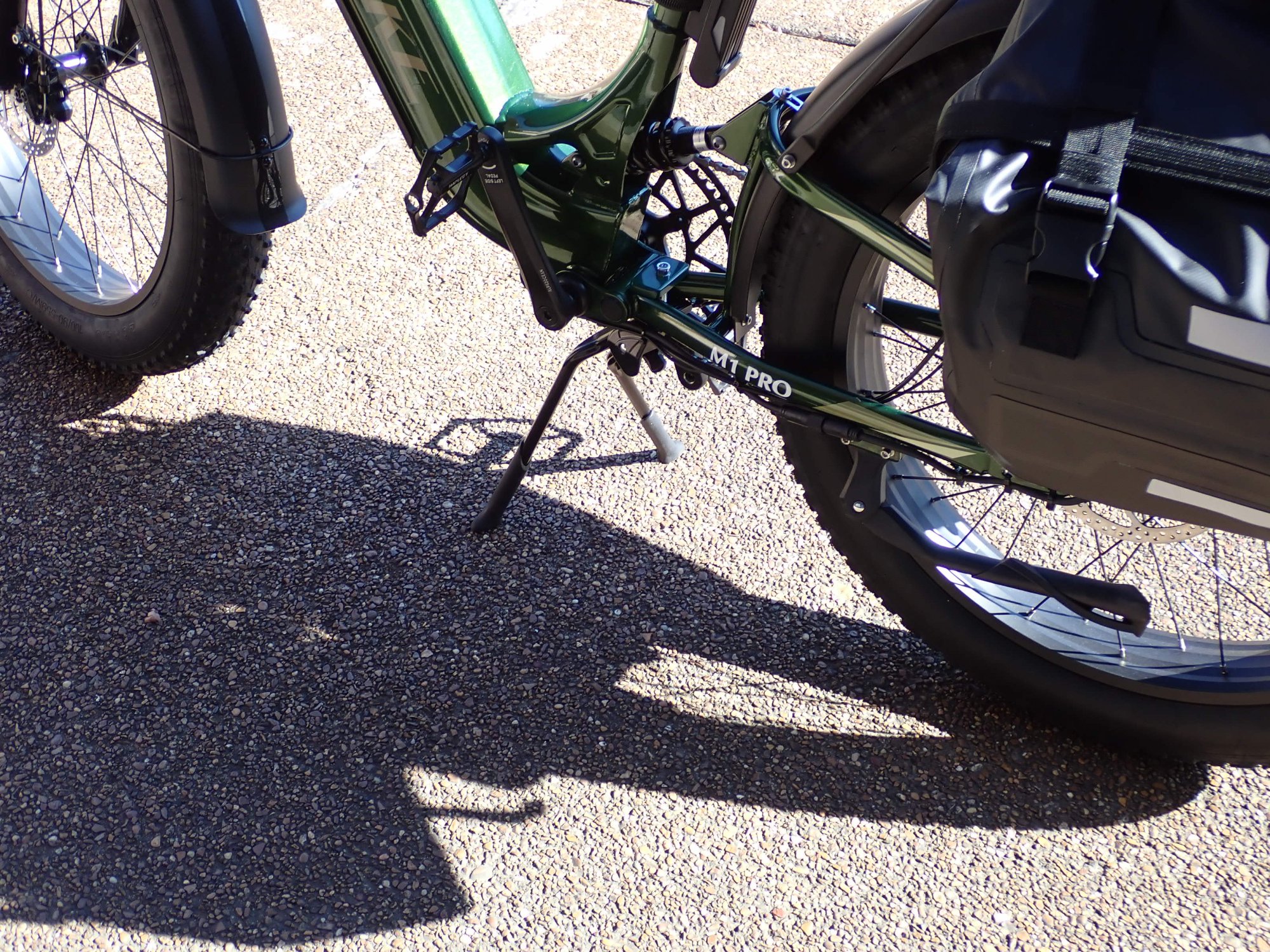

The other one was likely hitting the chain. This kind folds up to the left and I find to be plenty stable. Adjust the feet so about half the bikes weight is resting on them.legs fold up on one side
Then one of these tooThe other one was likely hitting the chain. This kind folds up to the left and I find to be plenty stable. Adjust the feet so about half the bikes weight is resting on them.

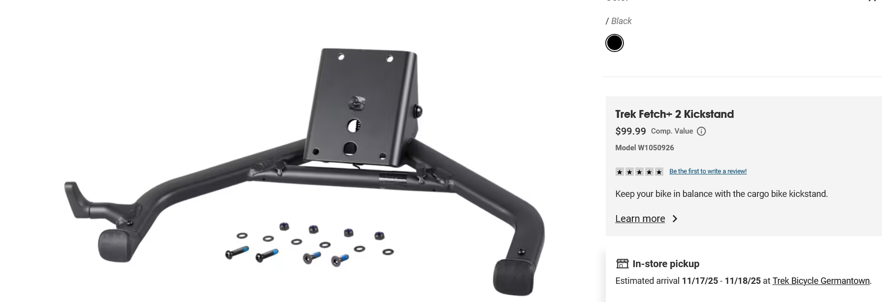

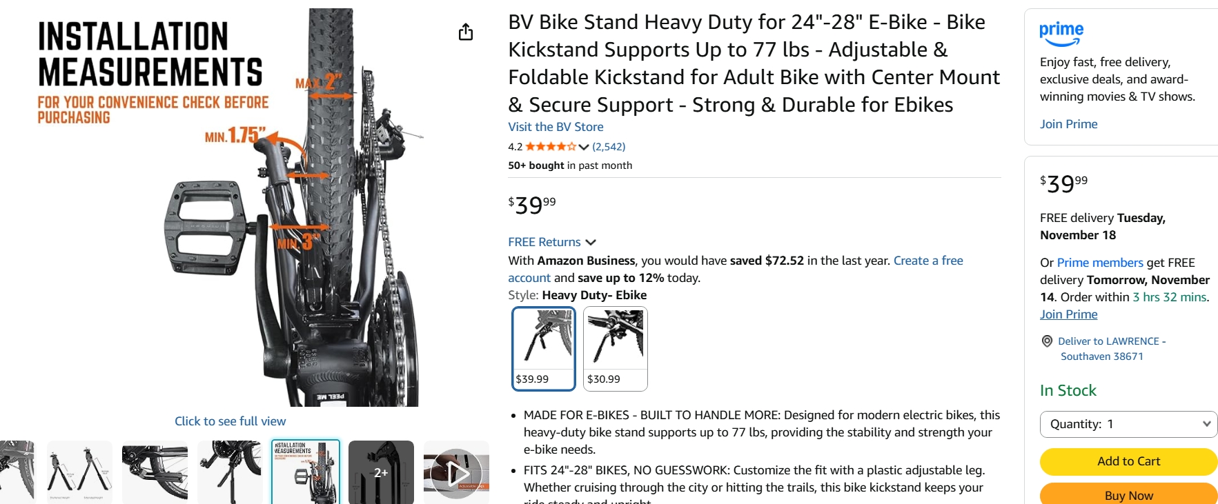

Are there any cheaper?
That seems to be the only option. I almost ordered one but decided to wait until after I hear from Aipas. I can live with the stock side stand anyway.Are there any cheaper?

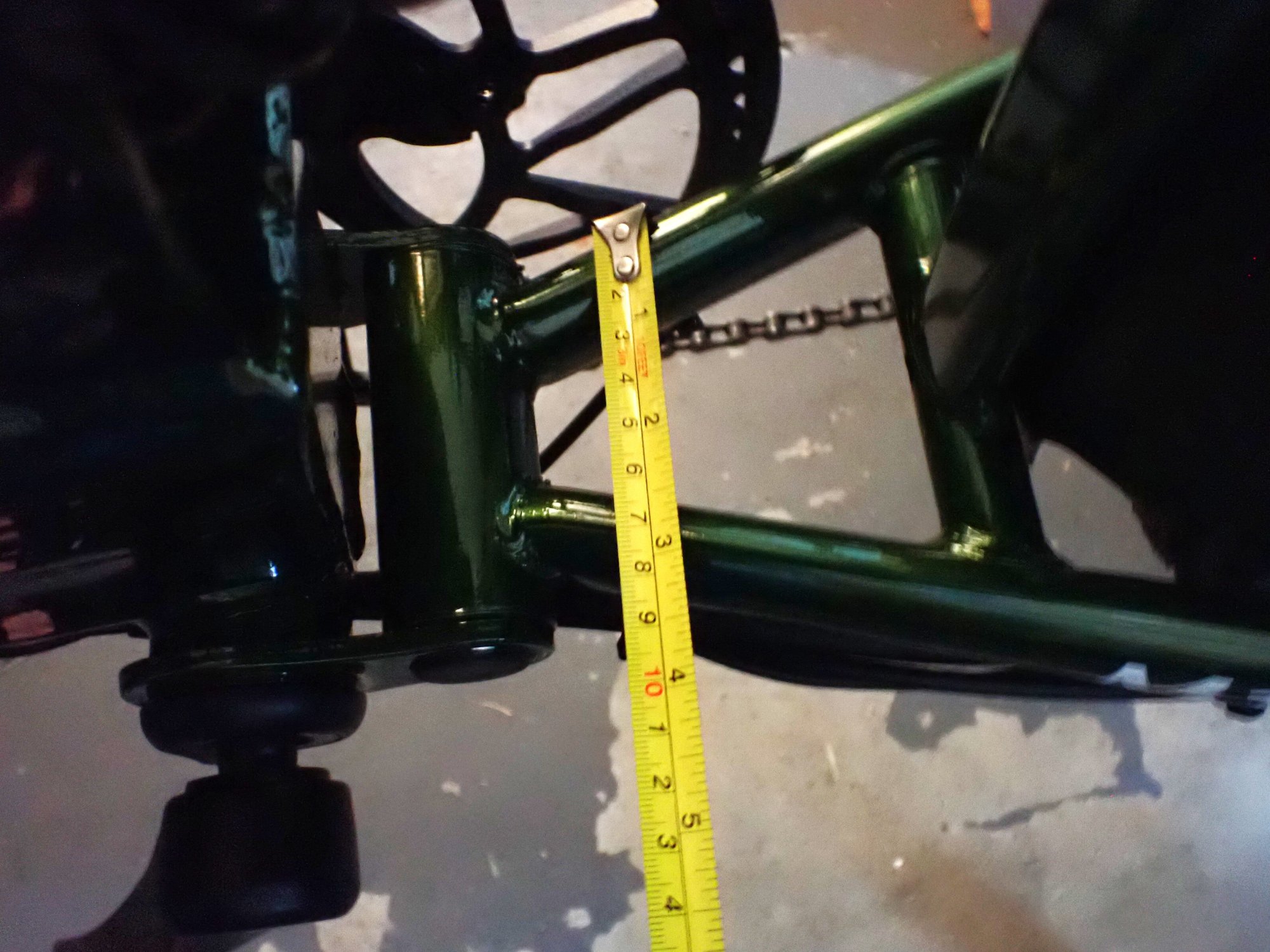

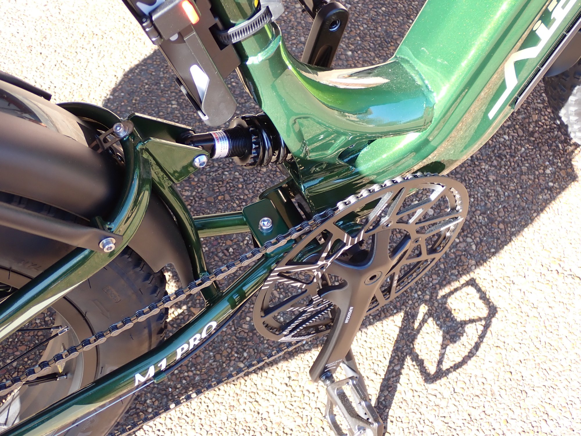

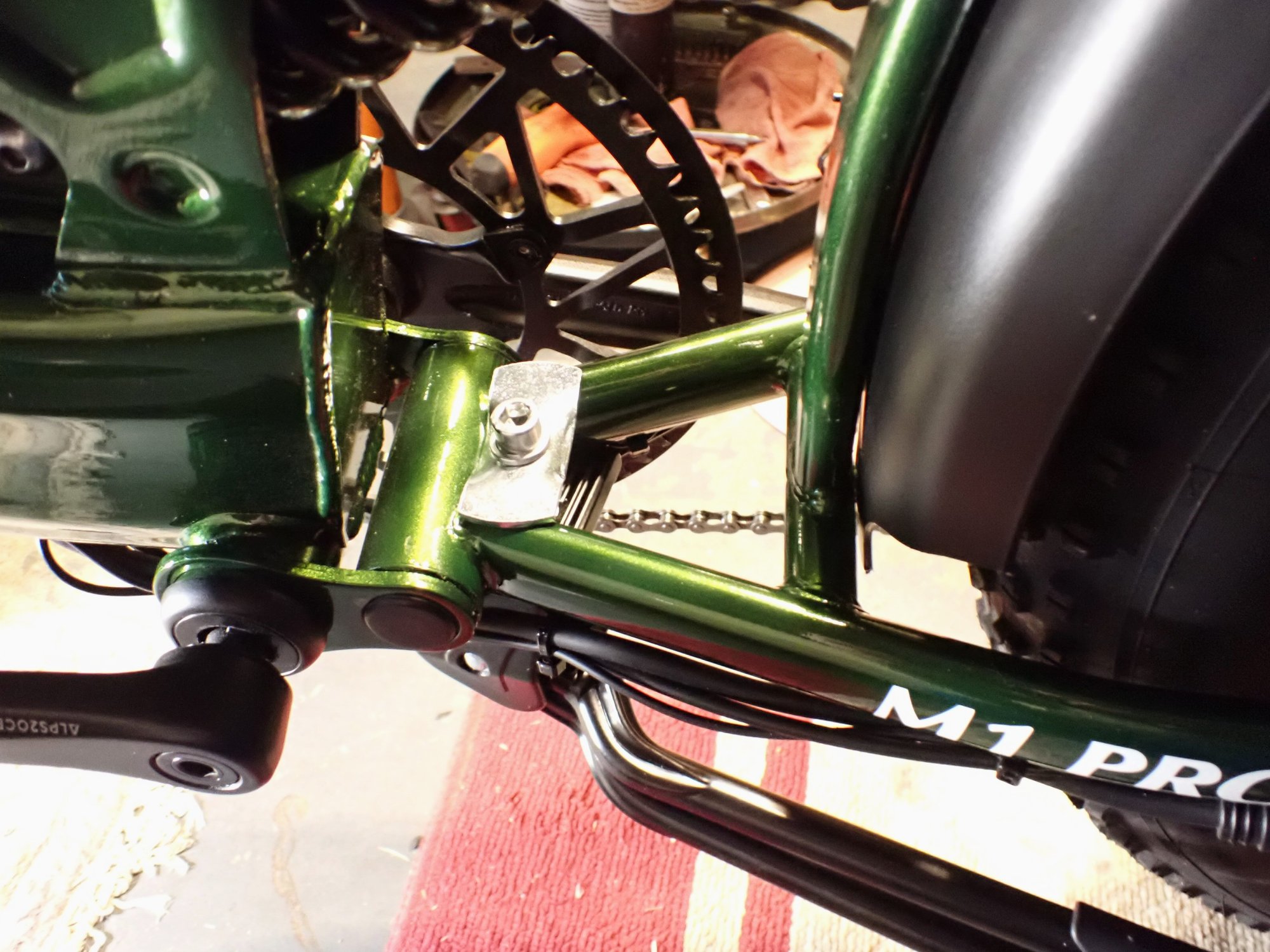

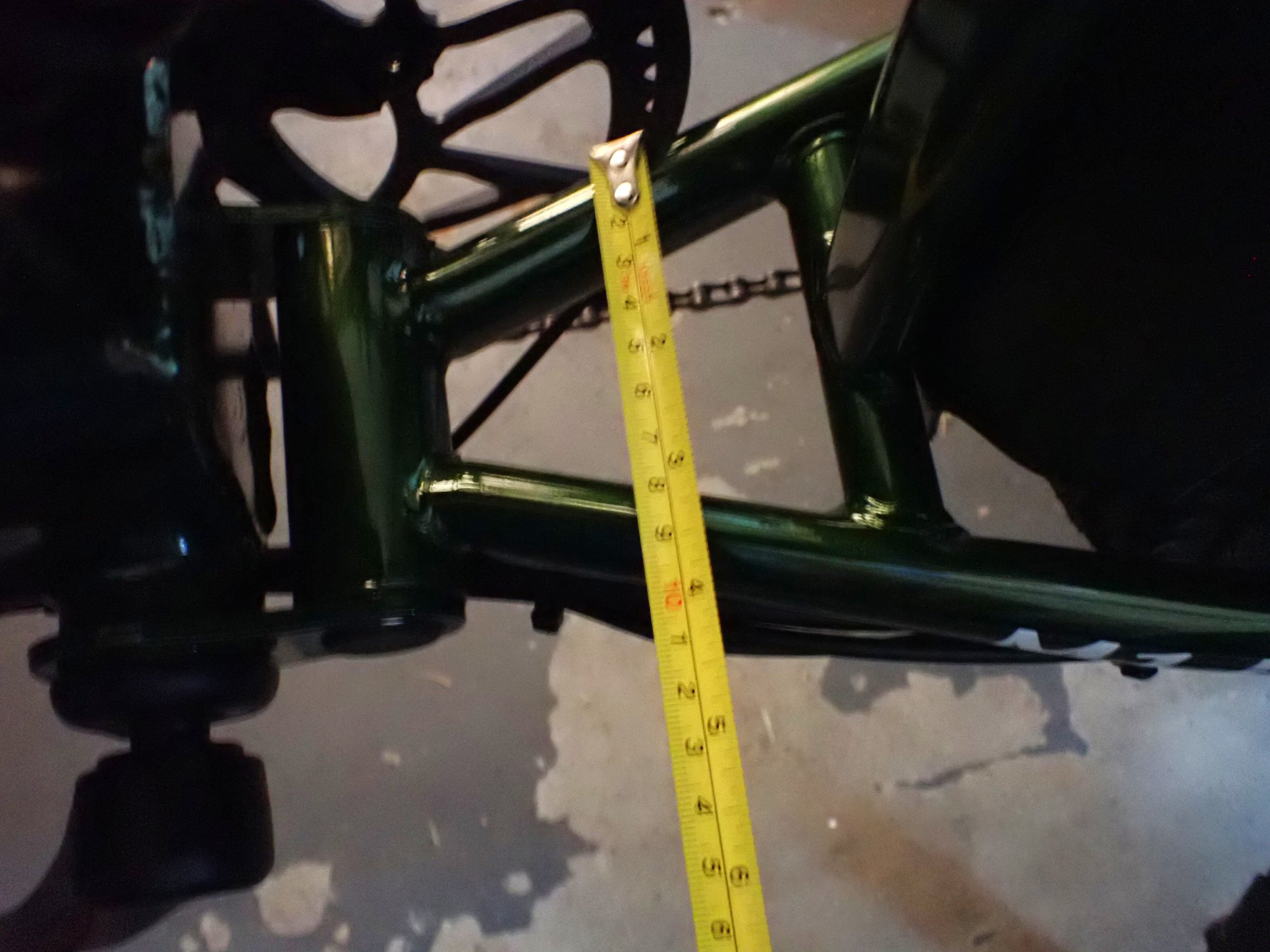

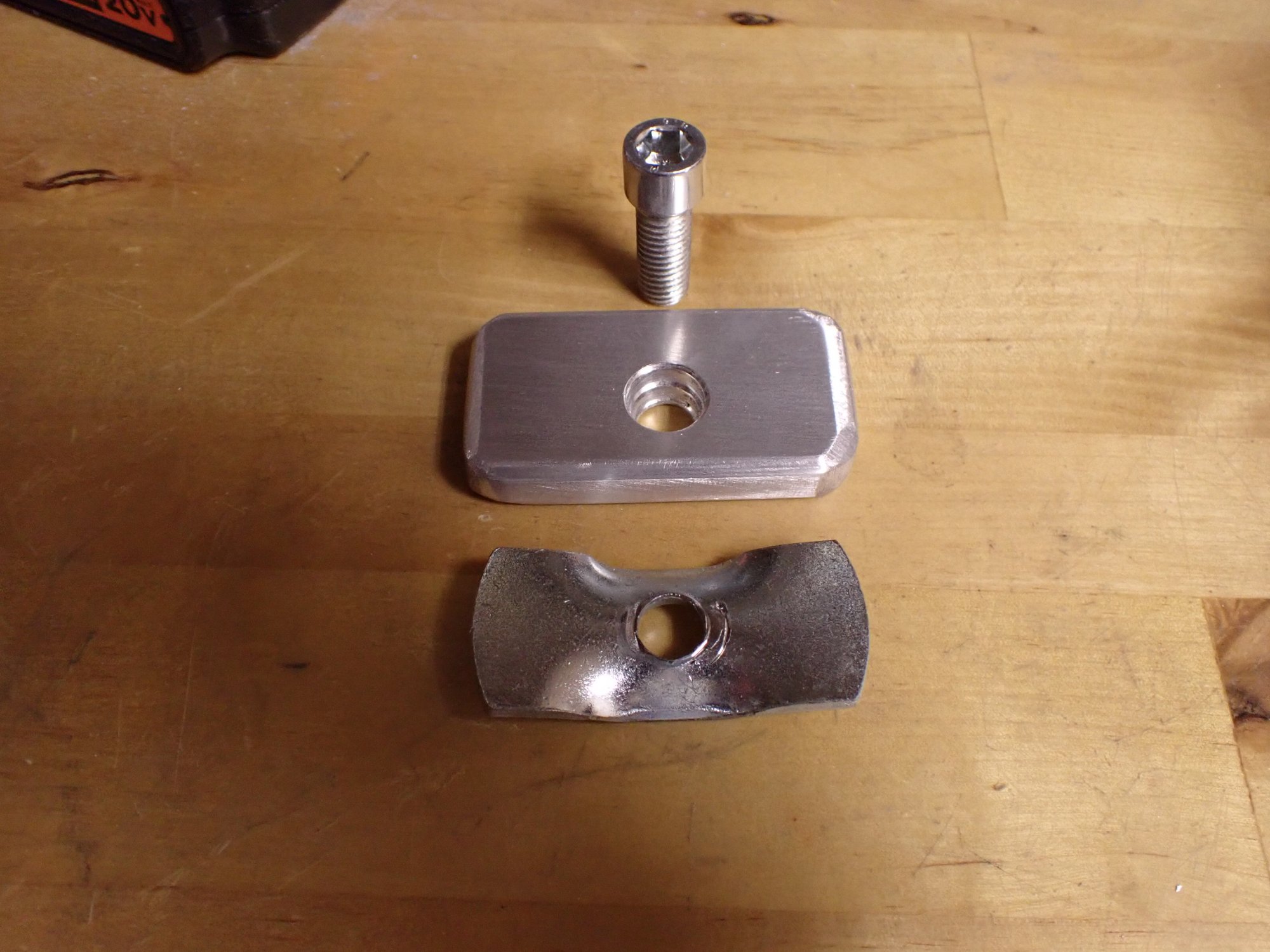

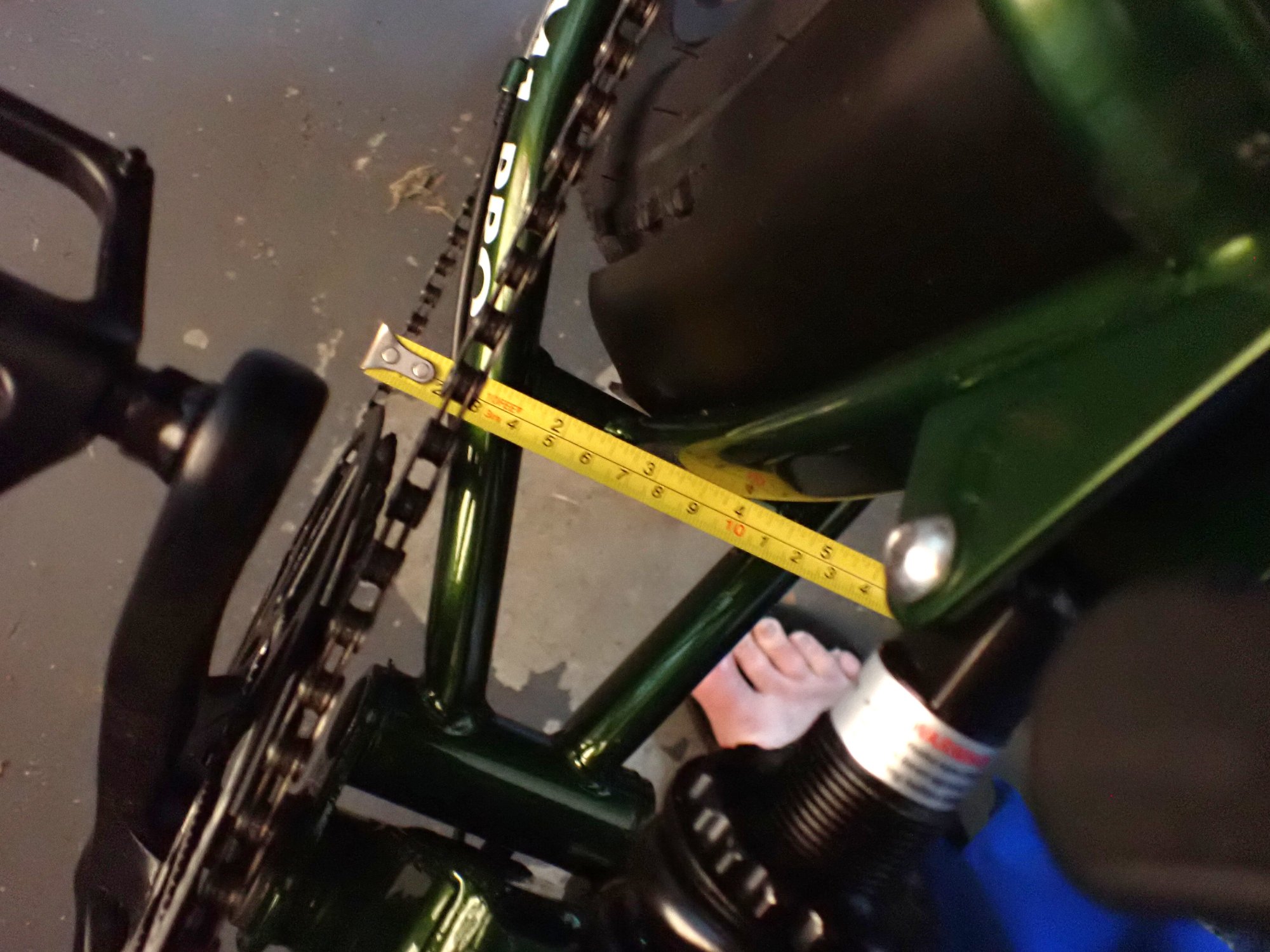

Yes, maybe something like 'L' stock for rigidity. Or maybe hollow square stock and held together with M8 hex cap screws. Last time I used 'L' stock was to move the headlight on a Como from under the basket to the front.I'd use aluminum bar stock on two sides.

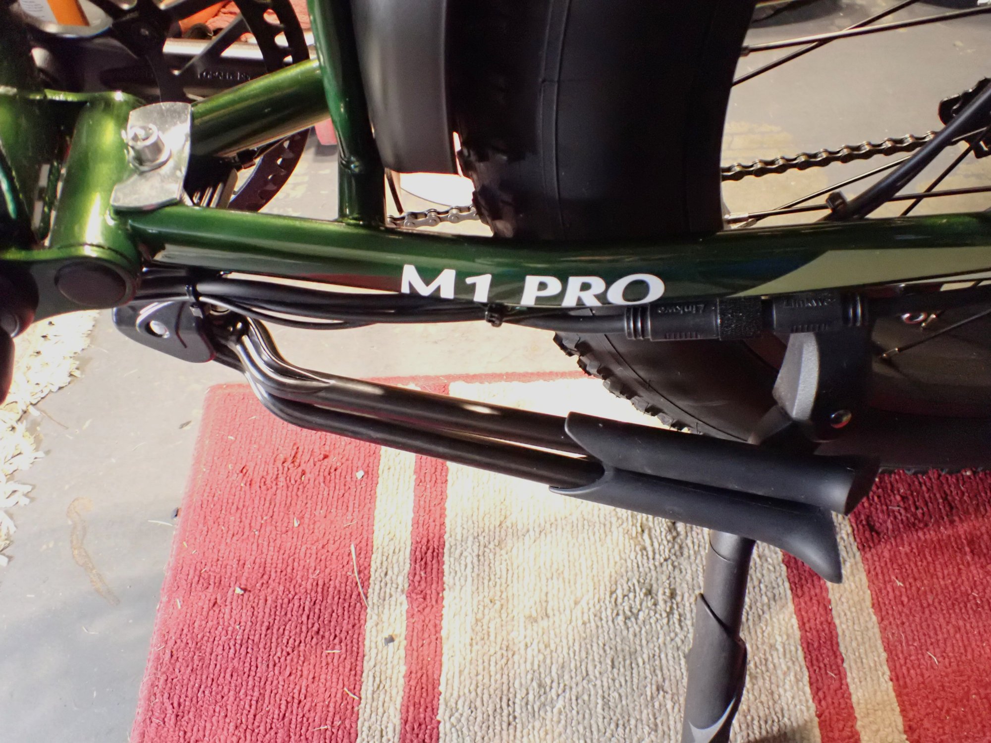

This stand did not work with my Aipas M1 ProWell I ordered one to try and fab some kind of mount to position it at the right height.
Maybe even a block of wood.....to lower it since the Fetch2 has 20 inch wheels. With the wood block I can carve out clearance for wires.
