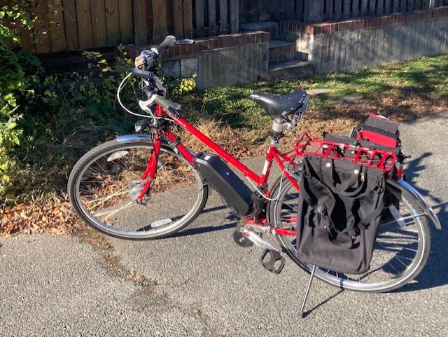

Figured I need to upgrade my converted Breezer Downtown if I'm to ride it to work everyday in all weathers so am looking at adding ebike lights that run off the battery, and a front drum brake so I can stop in the rain, the Breezer has a steel fork so should take the torque of the brake reaction arm. First step adding ebike lights, Grin Tech have a neat Anderson tap that goes inline between battery and controller but I need to convert my connectors to Anderson power poles. Step 1 today was replacing the connectors and...it's alive, phew. Hoping to try out the Anderson tap tomorrow with the lights. Asked my local bike shop for a quote on a Sturmey Archer XL-FD 90mm drum brake laced into a 700c rim.
Front light works, yay. Rear light doesn’t so has to go back, boo

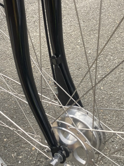

What got me thinking originally about fitting a drum brake was my experience riding DC bikeshare ebikes and pedal bicycles fitted with this brake, on the left is the Helbiz bikeshare ebike based on the (out of business) Genze 200 model with some minor changes including a Sturmey Archer XL-FDD dynamo hub, also fitted to a small number of Capital Bikeshare pedal bikes (maybe 200 out of the 4,500 fleet). Having ridden both bikes, and appreciating the consistent braking power in all weathers, I felt confident this was the best solution for converting the front rim brake on my commuter. I chose the XL-FD hub because having decided to fit ebike lights I didn't need the dynamo. Note on the left side of my fork you can see the clip to attach the drum brake reaction arm to the fork, whereas the Helbiz/Genze uses a purpose designed drum brake fork with a tab brazed-on to attach the reaction arm. There are after-market forks available with a brazed on tab to replace the clip eg a 700c fork for a quill stem available from the Netherlands, which I might look at for a future upgrade.

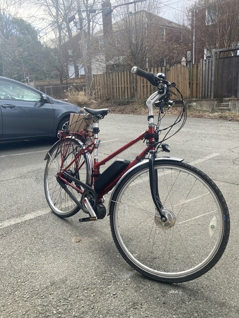

Bike as of December 2021 with new EM3EV battery

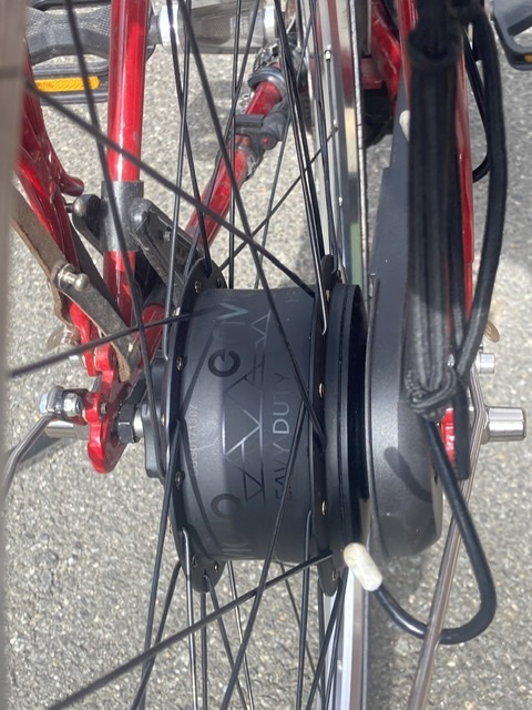

Just dropped off the bike at my LBS to have fitted a new fork with drum brake braze-on tab I bought from the Netherlands, new taller stem, and to replace the Nexus-8 IGH with an Enviolo Cargo CVT. Going to use bikeshare while it's in the shop.
The shop completed the work, new fork, stem, and Enviolo Heavy Duty hub my shop ordered from QBP
