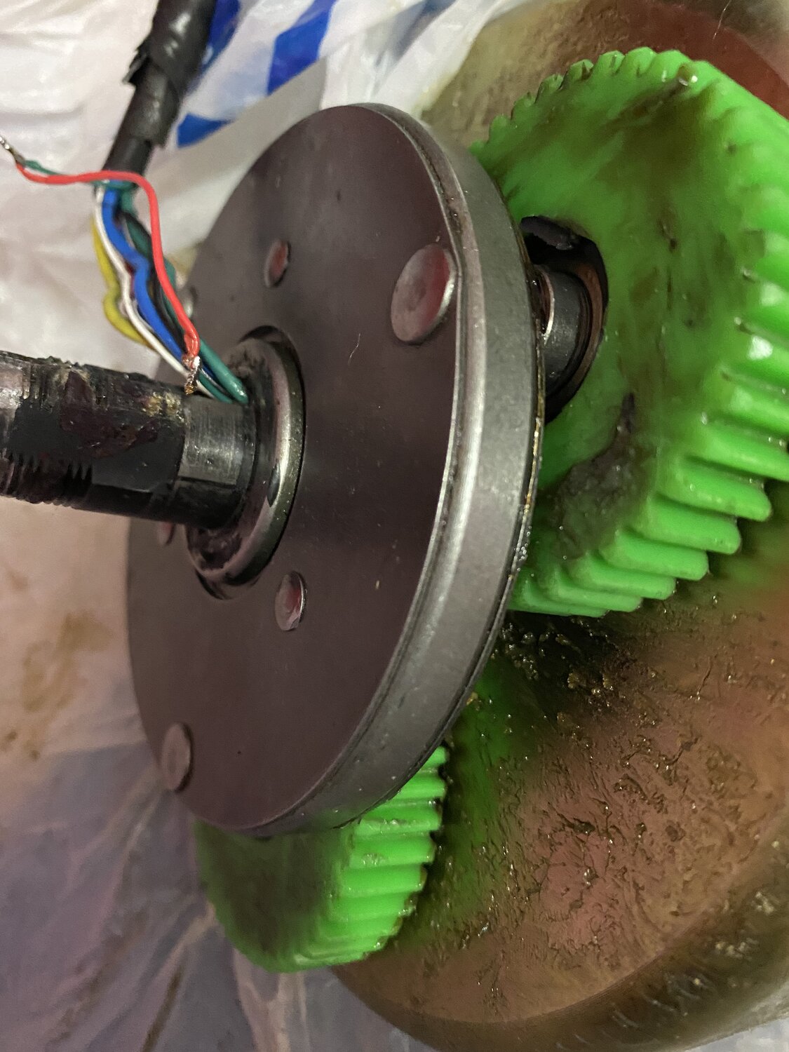

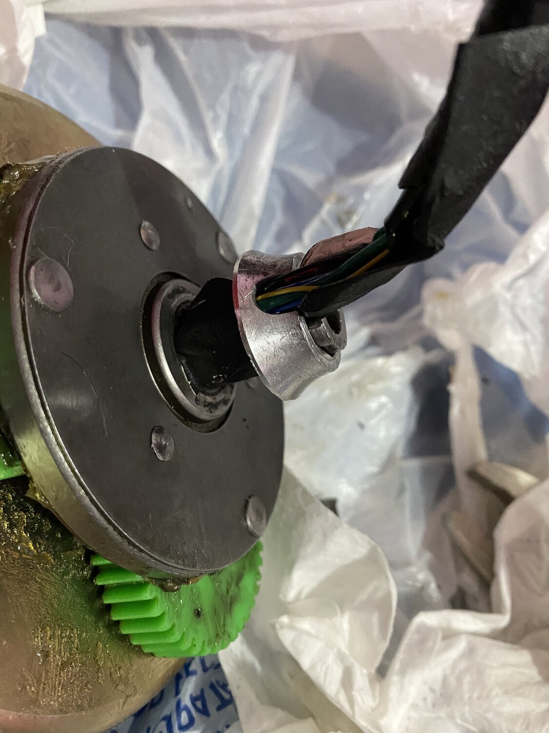

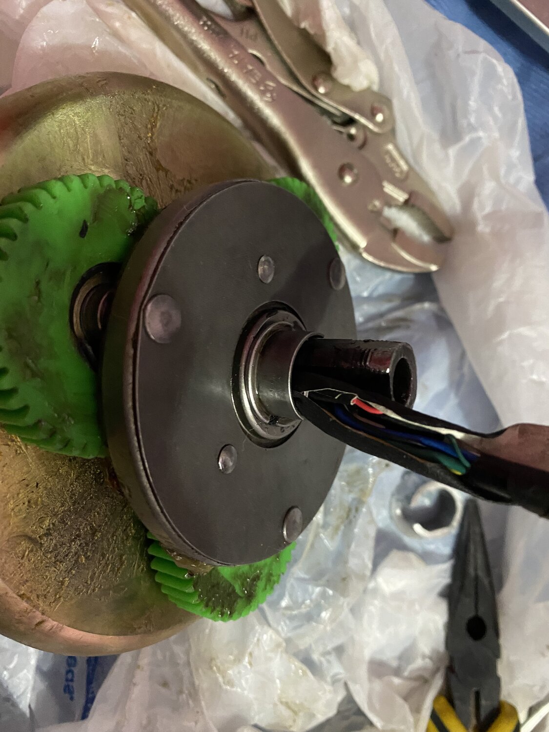

This is from one of my 2 Ebikes( have to do the soldering on the green wire for the motor cable and that's how i got to open the Pandora box😂) .

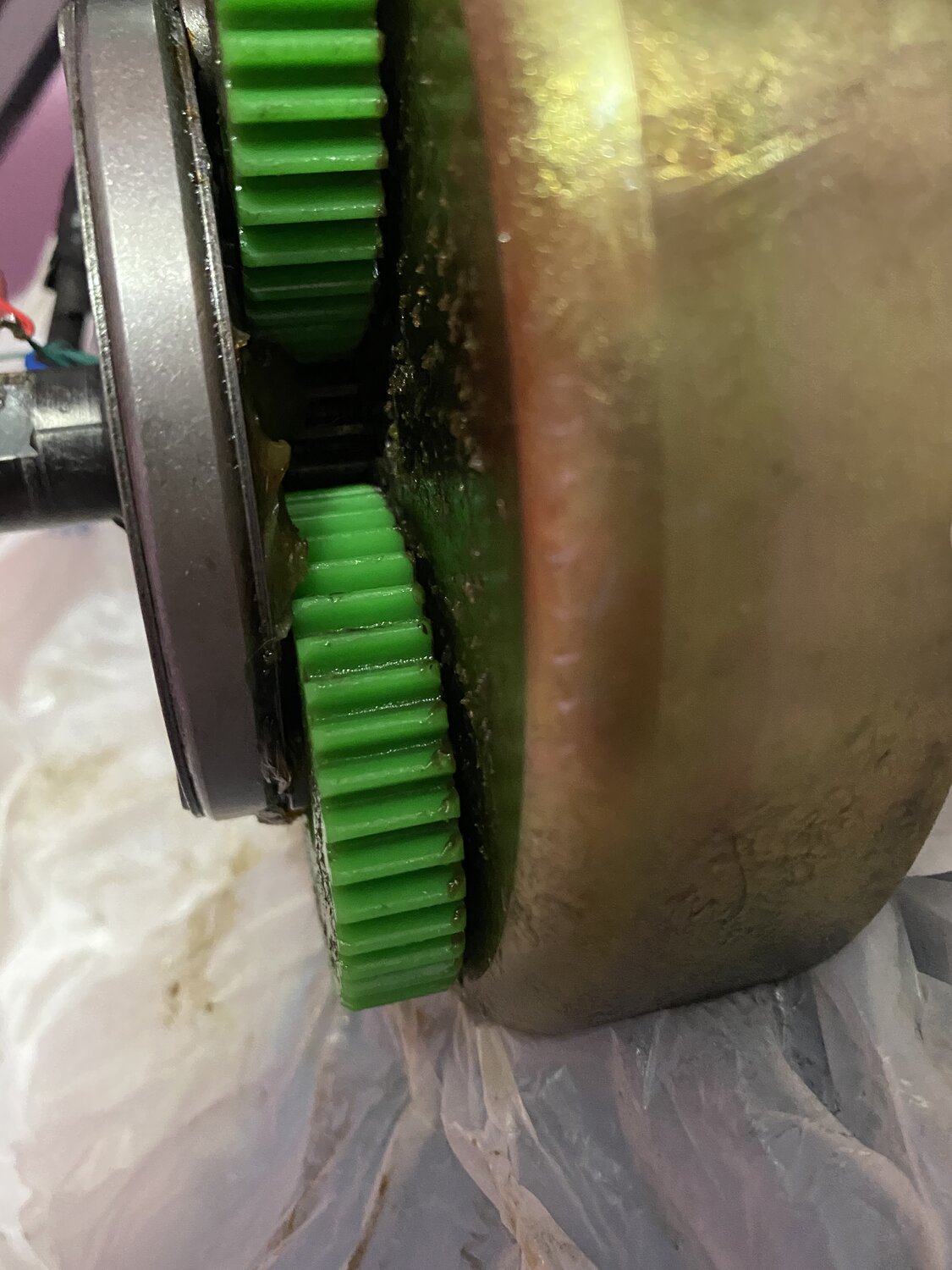

This motor and the plastic gears have 17.000miles on them already , hard miles i should say, as in 28-32mph speeds with a 52t front ring and in 13/12/11 rear cogs most of the time , in the Northeast rain , smtms. ❄️☃️ , many deep 15inch /35cm Ny/Nj potholes ....yea great hub motors are immensely superior to middrives .
This one was made by Dapu(Japan), there are 2-3 other companies currently that make good or great hub motors.

If the plastic gears were replaceable the hub motors could do 1million miles ! But there is ZERO wear&tear on mine's and i assume is the same for the others as well ?
