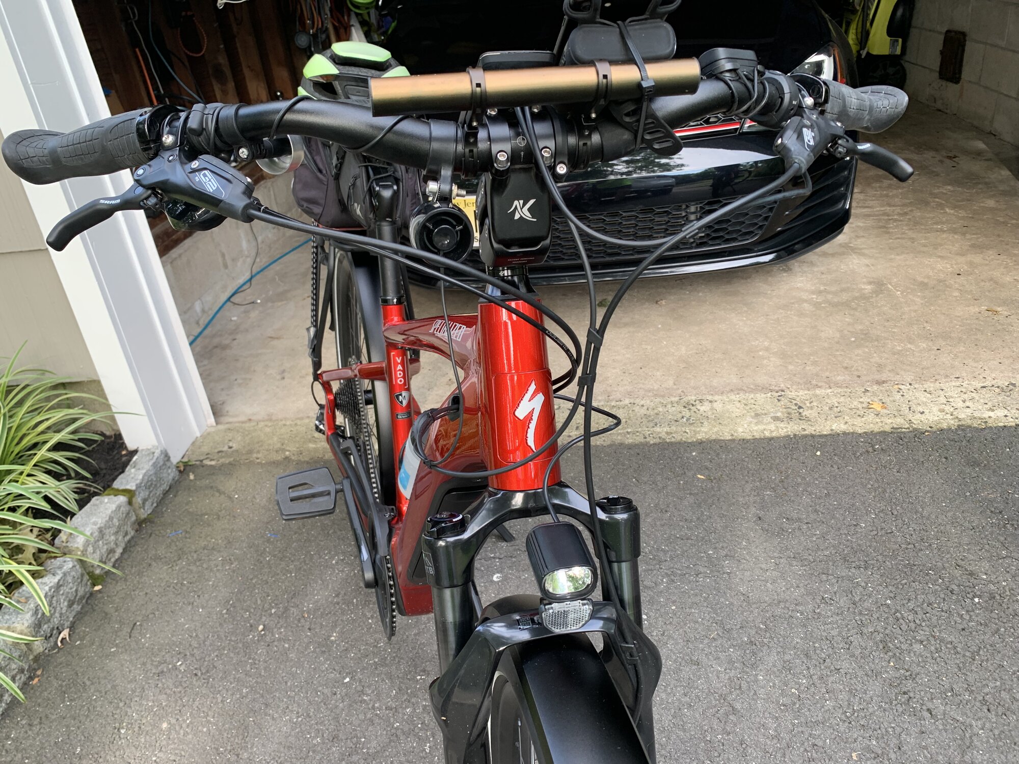

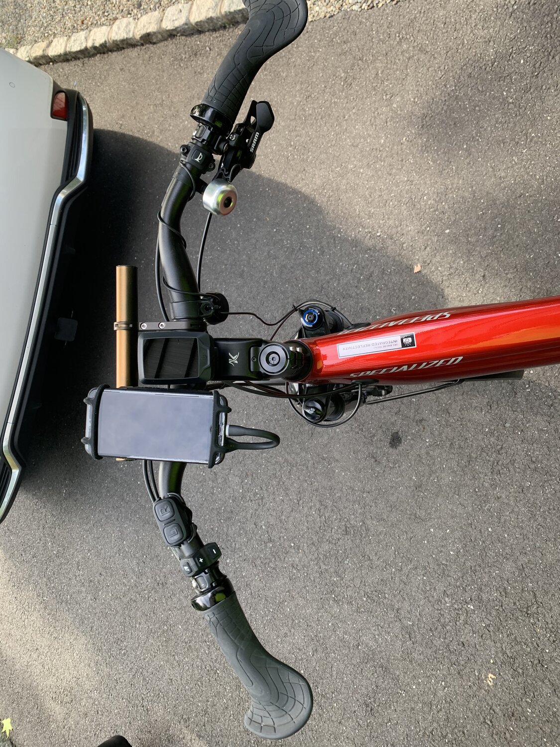

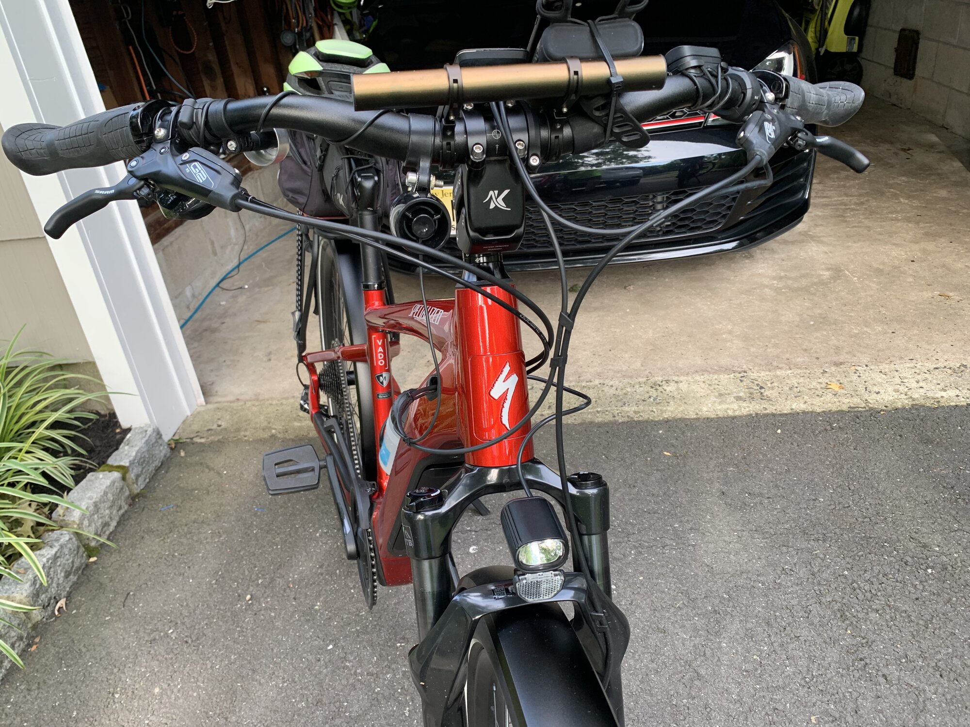

I'm not sure about 'adding', as if you were able to do so, it would be very minimal, 1/4", 3/8", as I removed my handlebars and stem and installed the Kinekt suspension stem with 'Old Version' Como handlebars (more swept back). The absolute very best ride ever!
I've not taken any photos of it yet but will remember to do so and post them tomorrow.
I think mine are the predecessor to your model. I am using the Vado handlebars on my Como and like it real well, perfect fit for me. I am using a slightly raised aftermarket handlebar on the Vado and it works good also. You have to be careful on raising handlebars as the brake and gear lines can get short, make sure you have enough turn radius. If you get into a bind you can shorten the ends of the handlebars and bring the levers in which gives you more 'line'.
This is my new 2022 Vado 5.0 with installed Como (2021) handlebars and
Kinekt Stem.
