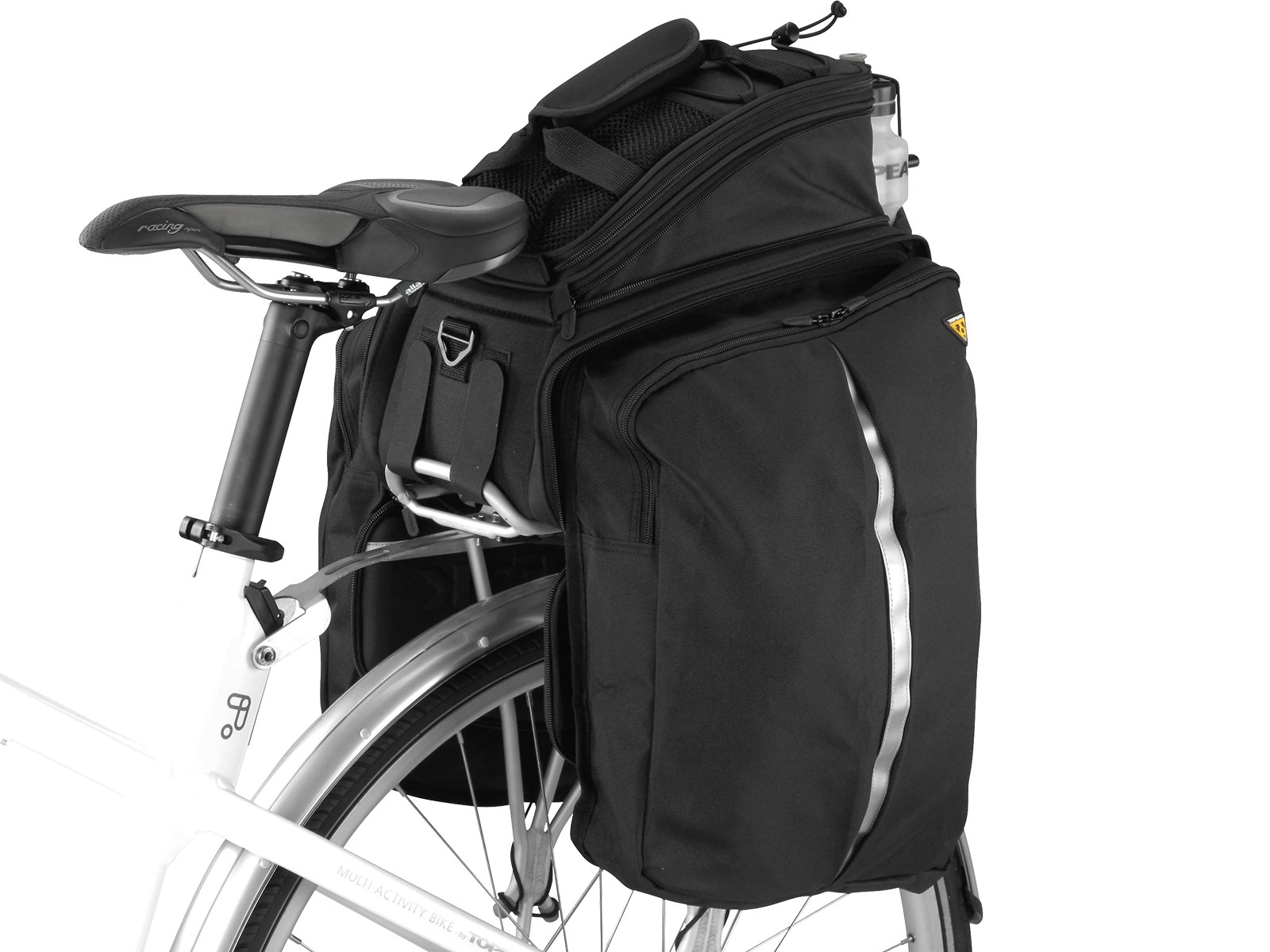

New 700 ST arriving soon and I want to buy a new Topeak Trunkbag DXP so I can use it for grocery shopping.
They have two versions - velcro and Quicktrack
But, the stock rack is a little unusual in that that it appears to be flat with rounded back AND front so there is no front rail to attach velcro to
Topeak do also sell a quicktrack adapter which might attach to the stock rack.
Has anyone installed this bag or similar Topeak on a 700?
Which method did you use and how did it work out?

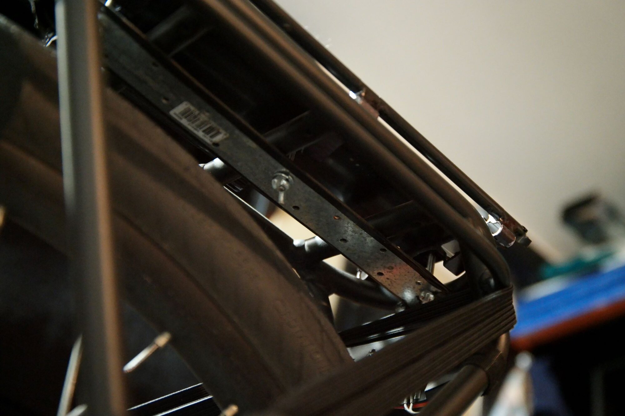

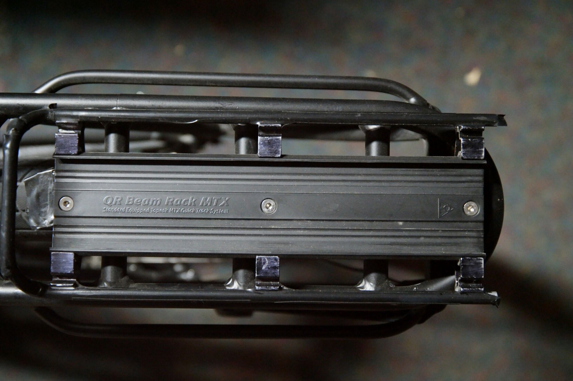

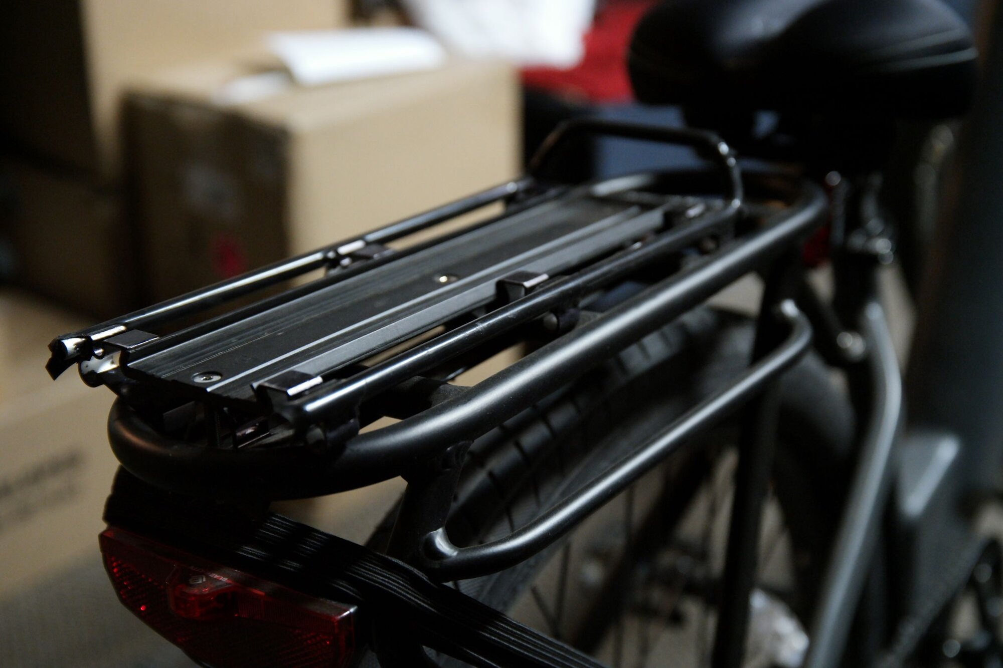

I have used the Topeak trunk bags for many years with the quicktrack system. When I bought a couple of 700's last year, the quicktrack adapter was not available so I took apart the beamracks I had and mounted the quicktrack plate from it which is basically like the adapter they sell now. No velcro crap for me to hold on a bag. I like the ease of the slide on, slide off. I am not sure that adapter plate will mount securely to the 700 rack based on specs of the adapter. I thought about trying the new adapter, but my setup works fine.
The adapter is made of plastic vs the metal tracks on the racks - which are probably better.
How did you attach the plate to the rack?
I used a piece of metal under the main bike rack cross members, dropped 3 bolts using the holes on the Topeak plate, and used lock washers and wing nuts to tighten. Wrapped part of the Topeak plate in black tape and used black marker on other spots to darken it. I will take the Topeak plates off sometime to paint for a much better look...it was a prototype lol.

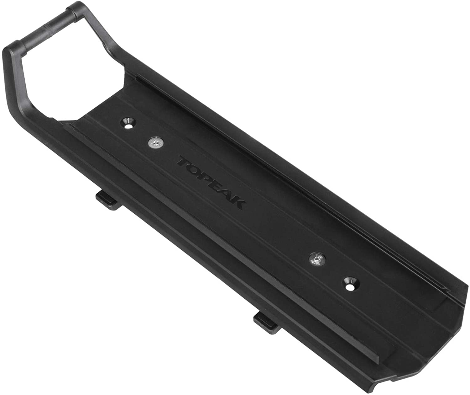

I just purchased the Topeak Bag and Quicktrack Adapter for my Espin Sport. The little arms that adjust on the bottom of the adapter do not come out quite far enough to catch securely on my rack. It feels fairly stable, but I'm wondering what I could do short of a zip tie for insurance against losing my bag when I hit a big bump...

I think after I secure the Quikctrack Adapter to my rack with 4 zipties, I should be in good shape. I doubt you will even be able to notice them...
Tell me more about heavier zip ties. This was my first purchase.
Oh man they come in dozens of sizes. Find em in Home Depot or similar store and you will see what I mean. They come from tiny to huge. I'd go with something kinda medium sized. That is, thickness wise.

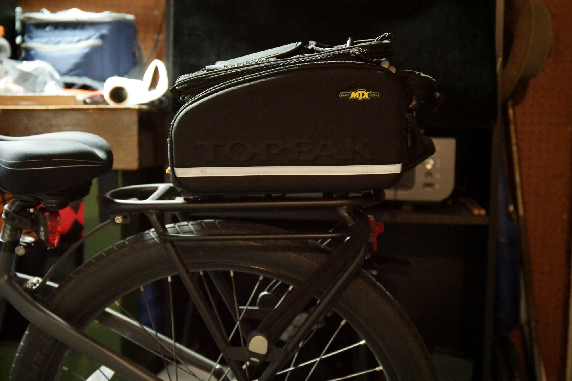

Ok. New update on the Topeak back with the Quicktrack Adapter. I ordered zip ties from Amazon and they came today. There is an art to secure the Quicktrack Adapter and then add the ties. So far so good. Feels stable and solid. Gunna take an afternoon cruise. Fingers crossed. The bag popped off yesterday on it's maiden voyage with no zip ties and a half arsed install. I blame the service tech ;)
Somebody kill my buzz and tell me it's gunna fall off again!
