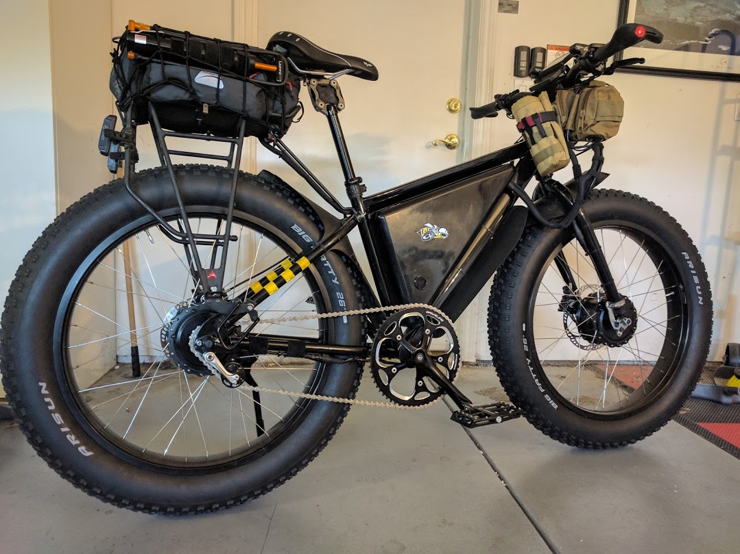

I think its a mistake to see a dual-motor bike as a powerhouse. The benefits of 2wd are really achieved thru distributed traction. Done right, the fact you have two motors can be entirely seamless with dual PAS, where the bike just launches with a level of ease and controllability you can never touch with a rear wheel drive no matter how much power you pump into it. It just works better.

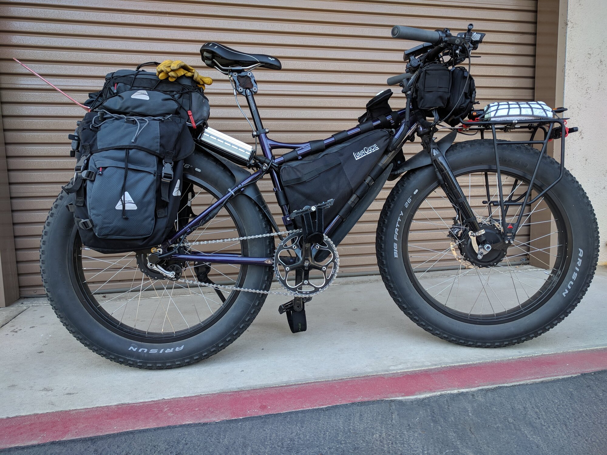

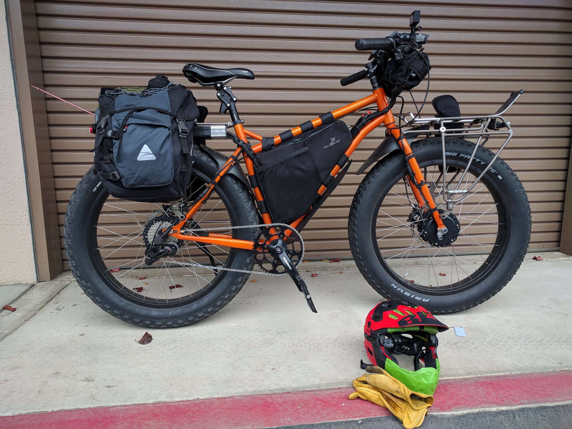

Street bikes. Dual hub. I would never do a dual hub again but they were a blast as fast, pedaled pavement commuters. The reason is hubs are great on flat land and I live in hills now. I put about 7000 miles on the orange one which is the only one I still have..

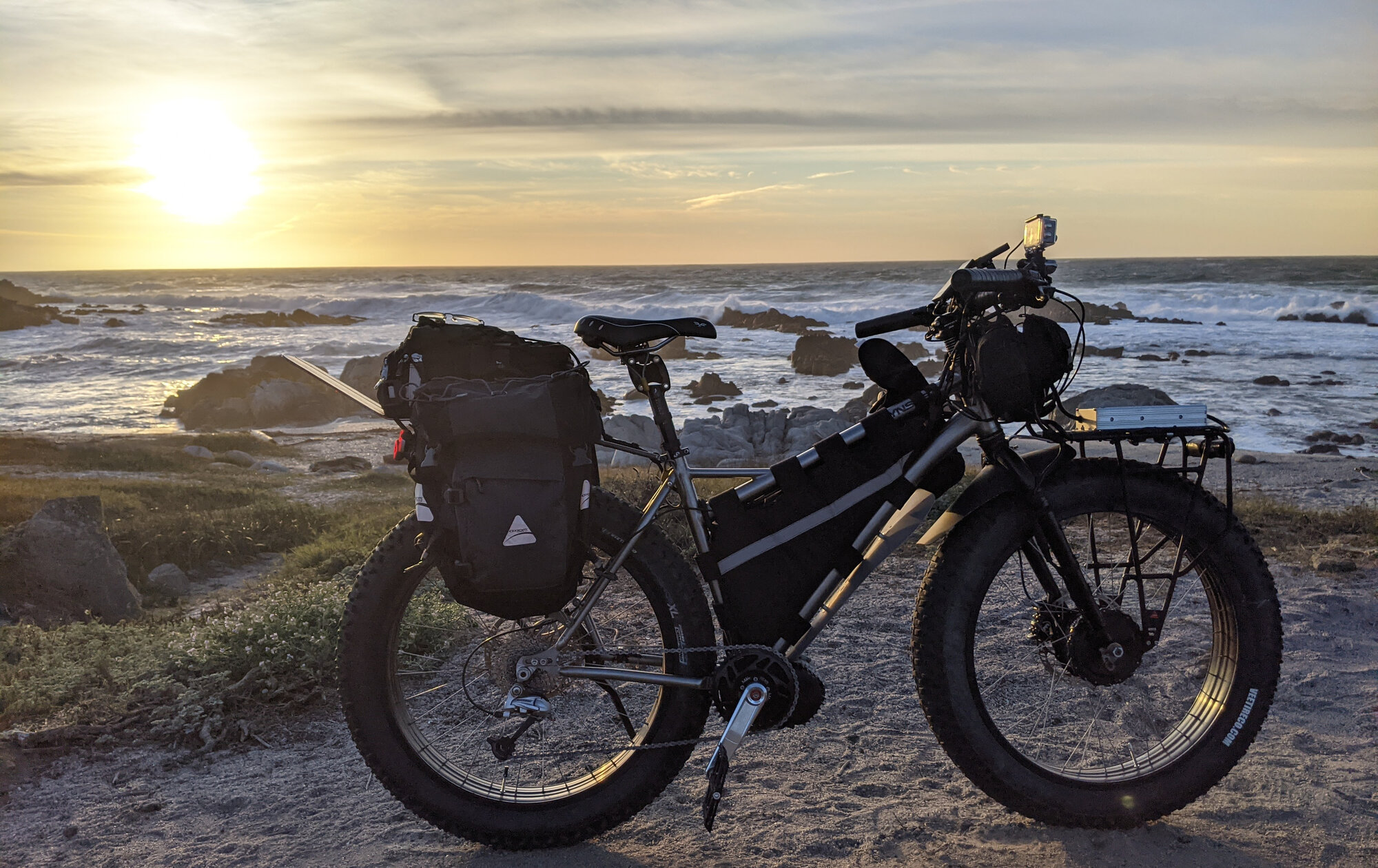

The permanent solution to the limitations of using two hubs is to put a mid drive in the back instead. At that point you have a bike that can go anywhere (deep dry sand) and climb anything without strain. Since that pic was taken I switched to a Box2 XW rear derailleur and a pie plate cassette.

In years past, yes. In the present day occasionally no. Typically you see standard off the shelf packs used. They may or may not have a single-charge solution built in. Given the varying quality of 'battery blenders' out there, I would not trust that. There are one or two companies that sell a single XL battery that feeds both motors at once, which means it has to have a really hi-cap BMS. They need to be in the 80a-plus continuous output range which you will never find in a generic pack.
